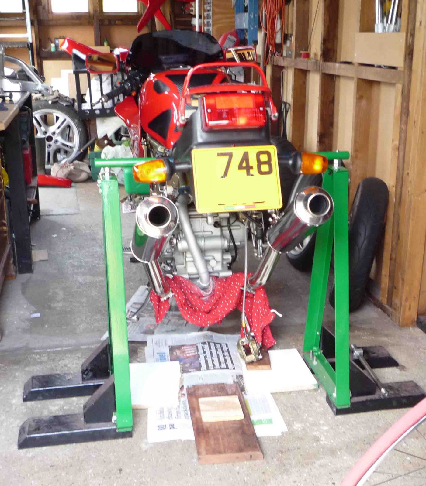

  12. I'm glad I didn't try that on my SS...............
    I did this instead......
