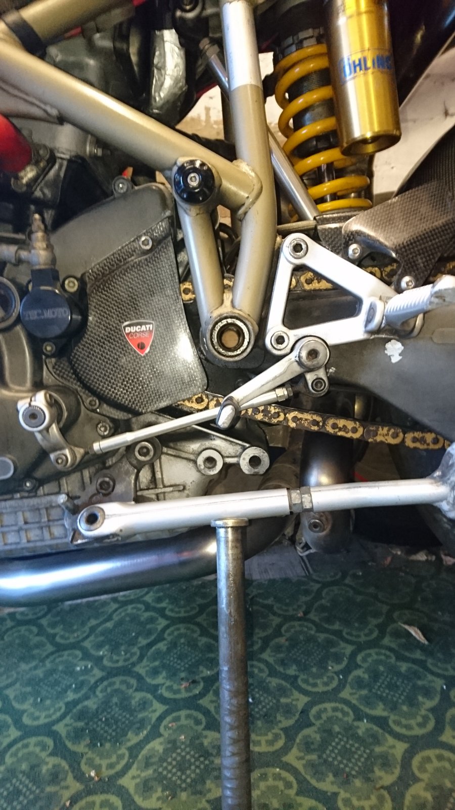

  8. Just re-greased my swing arm pivot bolt this morning as the fairings were already off, took no more than 5 minutes, supported by the rear axle stand only, as you can see on the bolt itself, it only had to be tapped out to get it started and then it was wiggled and pulled the rest of the way out by hand.
    As you can see straight through to the wall behind.
    Yes the chain has seen better days but as it and the sprockets are fine it's staying on for a while longer yet.

  9. Indeed.
    As Stu said, thing to do with the 999 is to knock it through with an equal size pin
  10. Incidentally.
