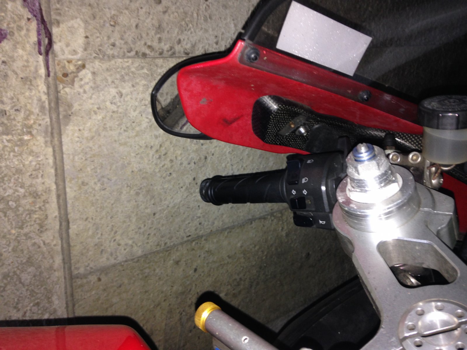

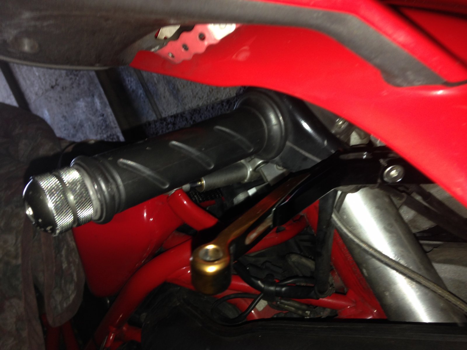

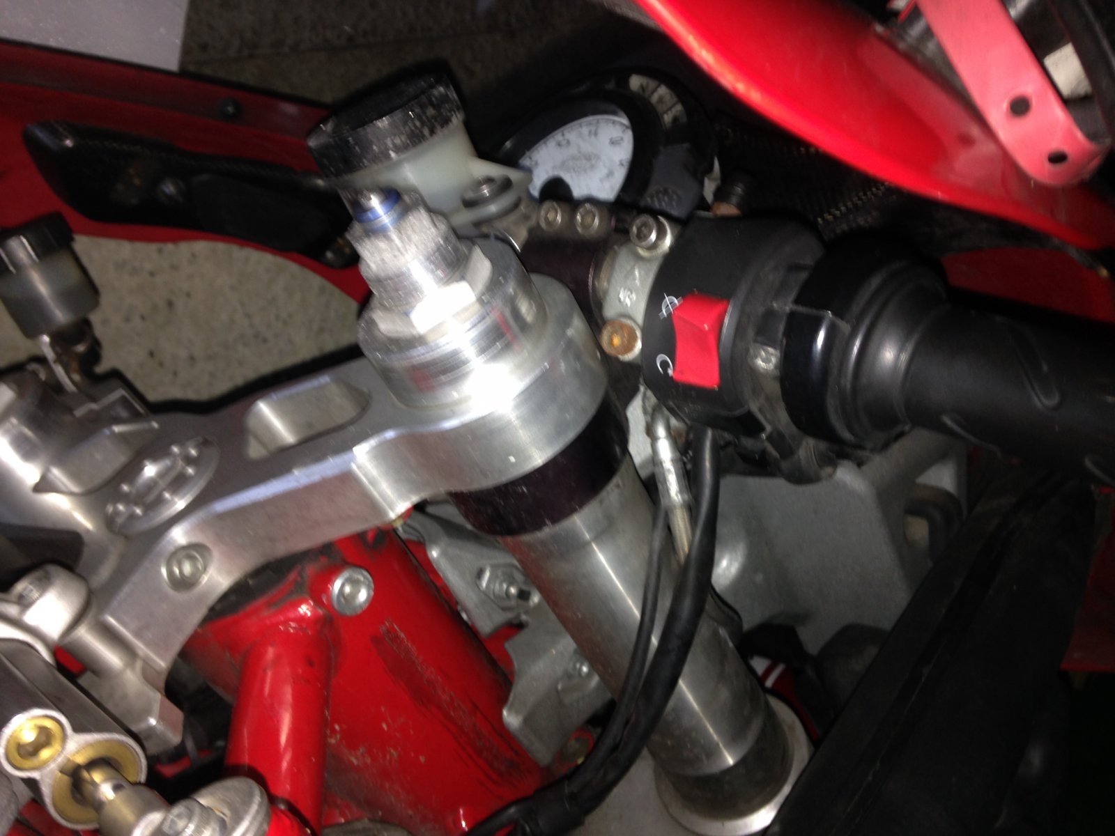

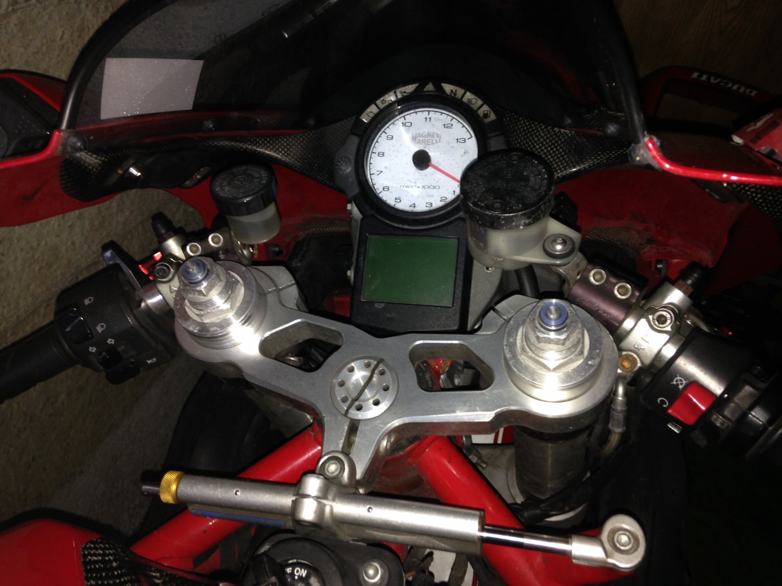

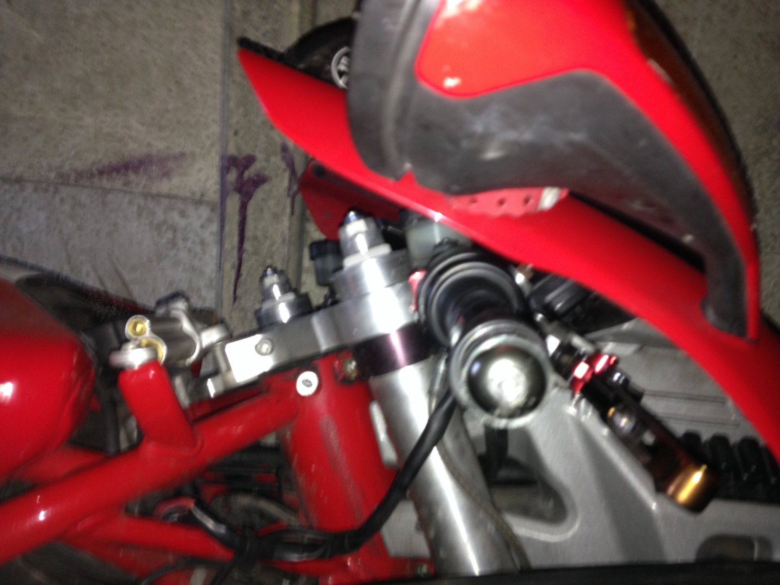

  2. I have cyclecat raised clipons on my 05 999. They came with round clutch and brake reservoir kits that fit on brackets that bolt on the inboard end of the bar. Cyclecat seemed to think the originals would foul something??All original cables and hydraulics are used. I have them as high and flat(the bar tubes have a concentric cone sleeve to vary angle) as possible. Round town I have to ride with my hands outboard with little finger round the bar end, otherwise when on full lock my gloves can catch the fairing cutout. I don't find it a problem as its a habit now and only took an hour or 2 to get used to. Well worth it as the bike is so much more comfortable. I can post some pics if you like.
  3. please.. although I'd like use the original reservoirs, dont think round looks good on the 749/999
  4. The round kit was supposedly reqd for the bars to fit but i cant see where std would touch anything. I got them s/h. I like the reservoirs, old school. As you can see not much raise and tight at the upper fairing. I cant angle them back any more as my thumbs would get trapped, but they made it comfortable for my lanky old body. IMG_4472.JPG IMG_4473.JPG IMG_4474.JPG IMG_4475.JPG IMG_4477.JPG
