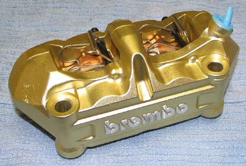

    Is this down to the type of calliper, the brake lines or the master cylinder? What would be a sensible upgrade path to try, changed pads, braided hoses or master cylinder first? I'd be tempted to change the callipers if this would have a big impact for road use, I'm not looking for racing performance.
    I'm not sure what the issues would be with the Anti-lock? Do callipers and master cylinders from other Ducati's fit straight on?
    These are the babies used on the Tuono

  5. I'll be fitting a set of M4 monoblocks on Friday. No problems with sponginess or travel, but the brakes haven't got the grunt I would like despite new pads and several checks by the dealers.

    Scrub the rotors with a kitchen abrasive pad (sponge with green abrasive bit) and detergent, rinse and dry....or you can find a proper tool something like this:

  10. TBH the OE hoses aren't bad...they're a mix of steel hard line and flexi line that appears to be made of a super tough plastic, about as good as one can expect under the circumstances. What probably has a greater effect is the sheer volume of line needed due to the location of the ABS unit - you're looking at 3m of brake line between the M/cyl and caliper.
    I picked up a spare line from a breakers in the US, cut into the hardline and flared it to accept a union. Then make up a flexi hose section to join this. You need the caliper banjos to be 20deg, this is the same for the new crossover line that you will also need (although a line from an 1x98, Streetfighter or 848Evo may also work).
    Snells are doing the fitting/bleeding at the same time as the rear brake upgrade.

  12. I've already had the rear fluid done with 5.1, pad change will be the last resort after the "upgrade". I have no concerns about ending up back with a soft pedal as mine has been fine since Snells bled it through at the beginning of last year.
    As for the front brake upgrade, there's a variety of reasons behind it, as already alluded to above.
    As previously mentioned, ABS bikes will always be worse...your average normal setup has maybe 1m of brake hose between M/cyl and caliper. A typical underseat ABS install will double or treble that, not to mention the effect of the ABS unit itself. Even with the best will in the world, that is going to make quite a difference.

  14. The line mods were done by Earl's up at Silverstone - I have neither the tools nor the experience to do that one myself.

    I'd be interested to see what the new callipers are like, I'm thinking of something similar myself.

  19. Update time. Not really had much of a chance to ride since the job was done (I've been suffering with a particularly nasty bug) but the hurried ride home gave a good test.
    The front lever feel is different, more progressive. You can just keep squeezing and squeezing on until the back end lifts or the ABS kicks in. Power is definitely increased, the same stopping effort takes a lot less lever pressure, so it's achieved what I wanted. Doesn't honk/squeal so much in the wet either.
    All in all very pleased so far.
