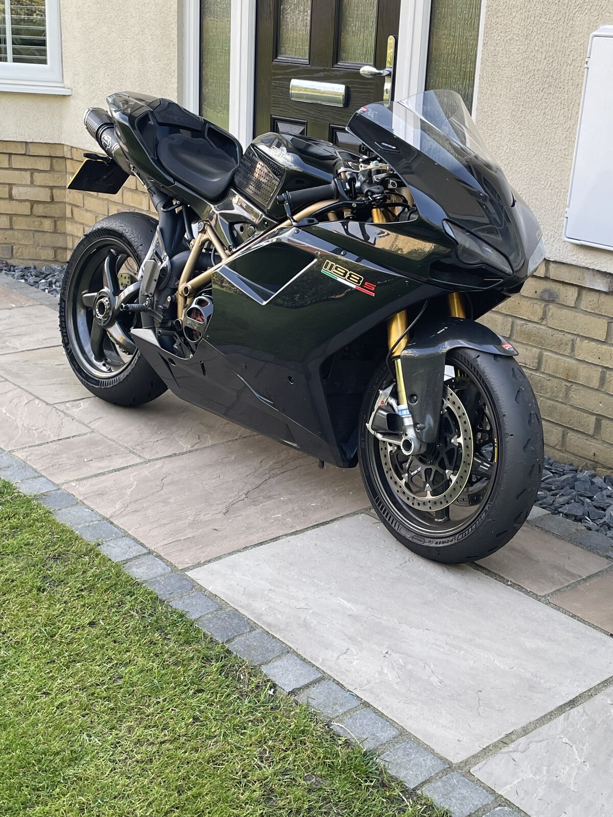

  16. @Andy 1198, i see you cerakoted your 70 like I did my old one. If you cut a 50mm x 70mm sheet of that fiberglass silver heat shield material, edge it with some gaffa tape to stop it fraying and put it over the inside of your right calf secured with one of those medical sock things, you will not get 3rd degree burns from the exhaust.
  17. ;-) it does kick out some heat, i've got little legs so when i stop I put my left foot down & move my right leg away from the heat
