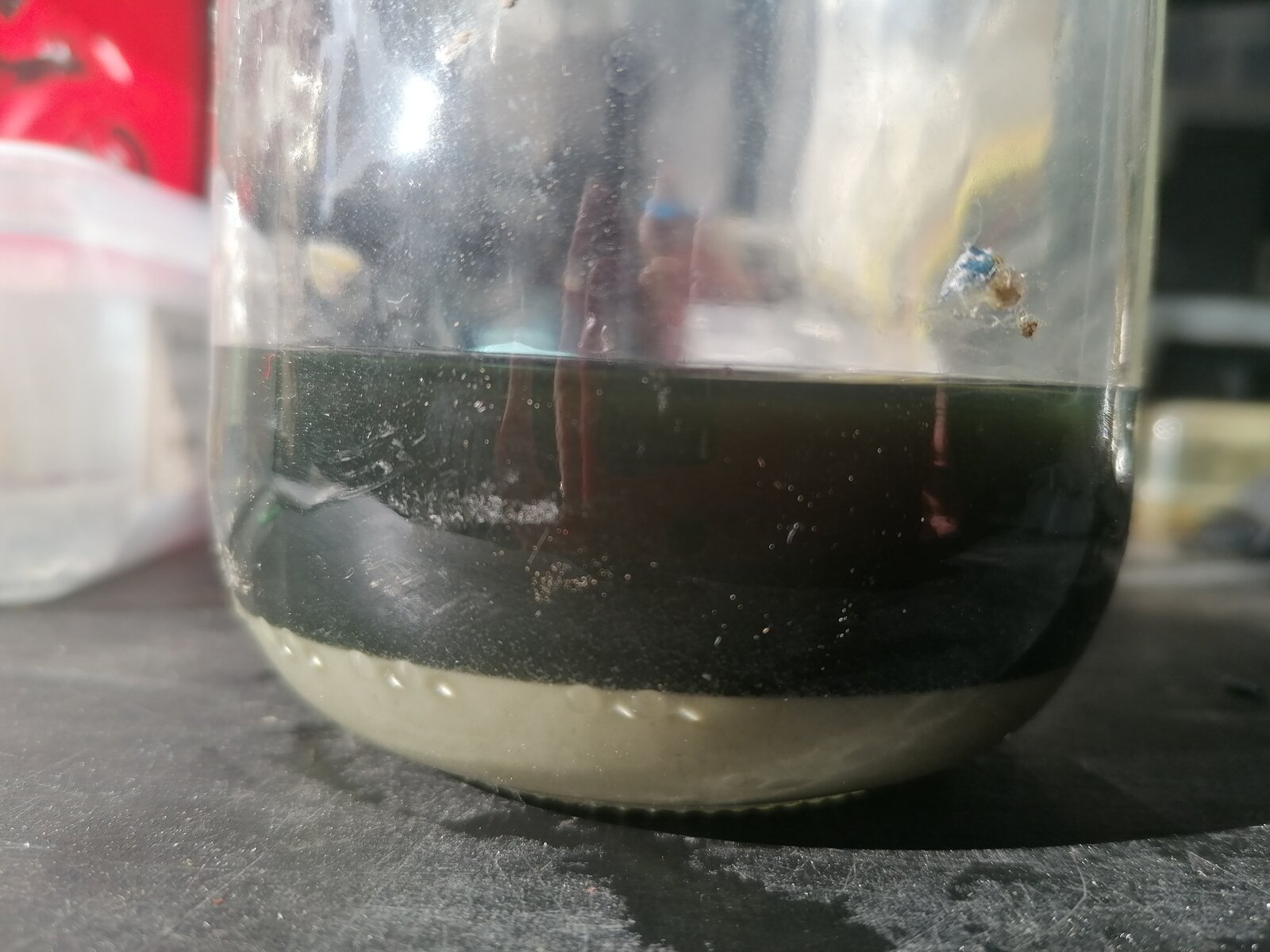

    Investigation found:
    - minimal coolant remaining (none whatsoever in expansion bottle)
    - nasty sludge instead of engine oil as below
    My gut feel is that it may be due to the water pump impeller shaft seal failing.

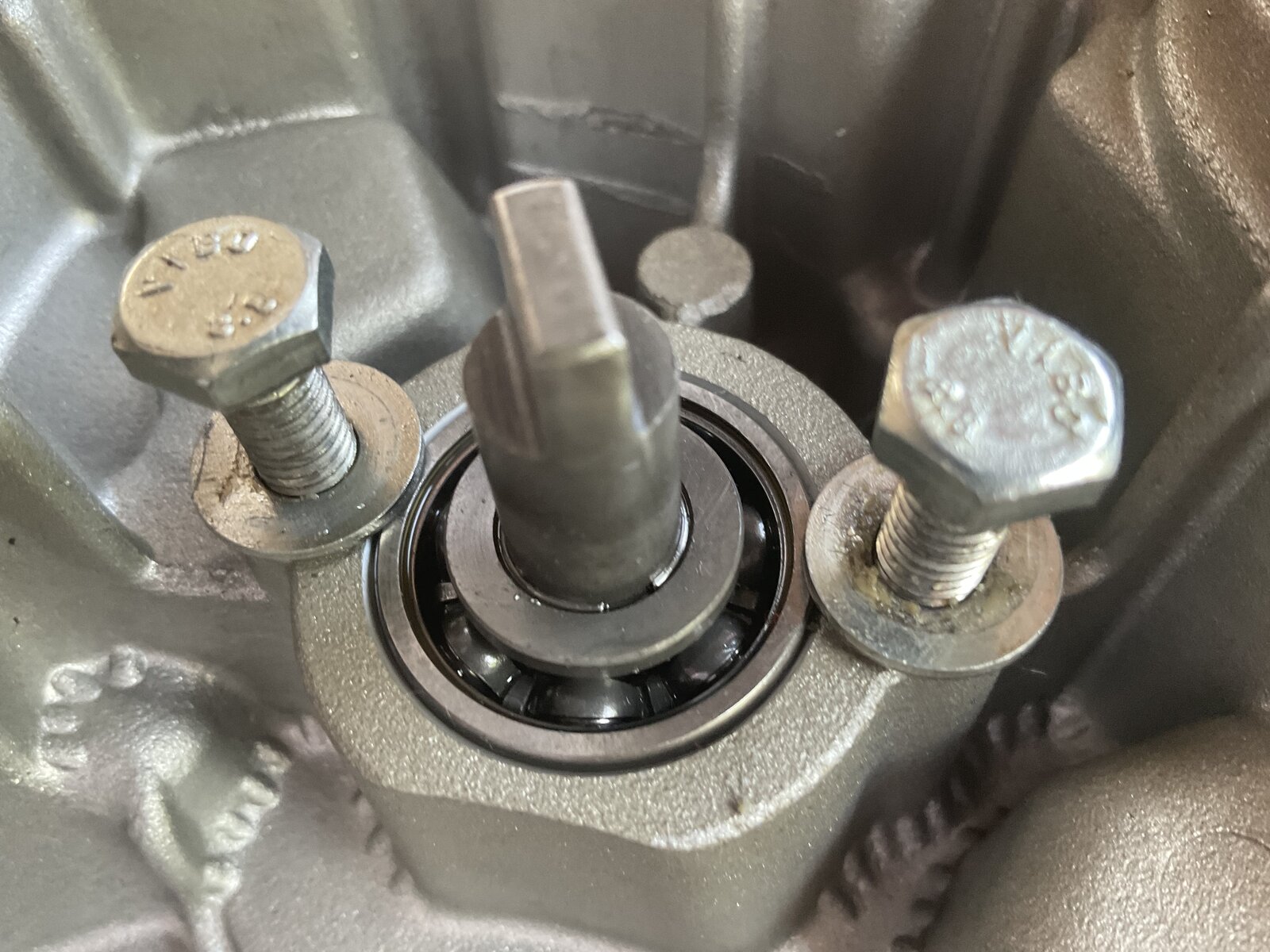

    A couple of years ago I fitted a second hand alternator case, complete with water pump impeller of unknown history.
    Looking at my original alternator case, I was wondering how to remove the pump shaft.
    See below, there is a tiny wire snap ring that needs to be removed first - the recess/access to get to the ring is very narrow, too narrow for my circlip plies or any screwdrivers or scriber/bradawl.
    Does anybody have any advice for removing this clip please?
  2. What about grinding one down so you get the thin point you are looking for?
  3. Ricky, you need the dentist picks. They have a finer pointy bit and theyre surgical stainless, so fairly strong pointy bit. I used to have a set but lent to a 'mate', never returned. Dont buy cheap ones as the tip bends n snaps.
    • Useful Useful x 2
  4. I've got two sets, one from Draper - quite easy to bend if you apply any force really and some that my mate gave to me ( he's married to a dentist and they were replaced by some new ones in the surgery ) that are to date incredibly strong in comparison

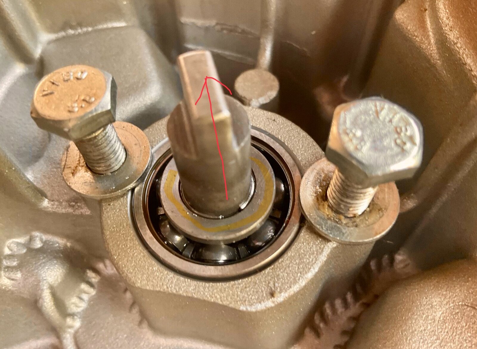

  5. Small update on this.
    Still haven’t dropped the sludge out of my bike as I hadn’t been able to remove the water pump impeller snap ring on my old alternator case so had put the bike to one side.
    Dropped in to my old friend @Sev ‘s yesterday to sample his lovely coffee…just happened to have my alternator case in the footwell of my car.
    Basically, one needs to push the impeller shaft from the outside and it raises the snap ring above the washer (in yellow), allowing much clearer access to the ring to flick it out.
    Top stuff…no excuse now to stop me stripping the real casing off and replacing the seal assembly.

  8. We found out by complete accident - when we put the case on the bench, Sev noticed the the impeller shaft moved upwards and that allowed the access. Top spot @Sev !!

    Today I finally managed to get around to pulling off the alternator case to move a step closer to sorting out this issue.
    Having previously worked out how to remove the water pump impeller snap ring by practising on my original casing [thanks @Sev !] (chain snapped some years ago and cracked it so replaced with s/h case, including water pump), I removed the impeller and found that the mechanical seal was in two bits and basically shagged.
    I am pretty sure that this explains how the coolant got into the crankcase.
