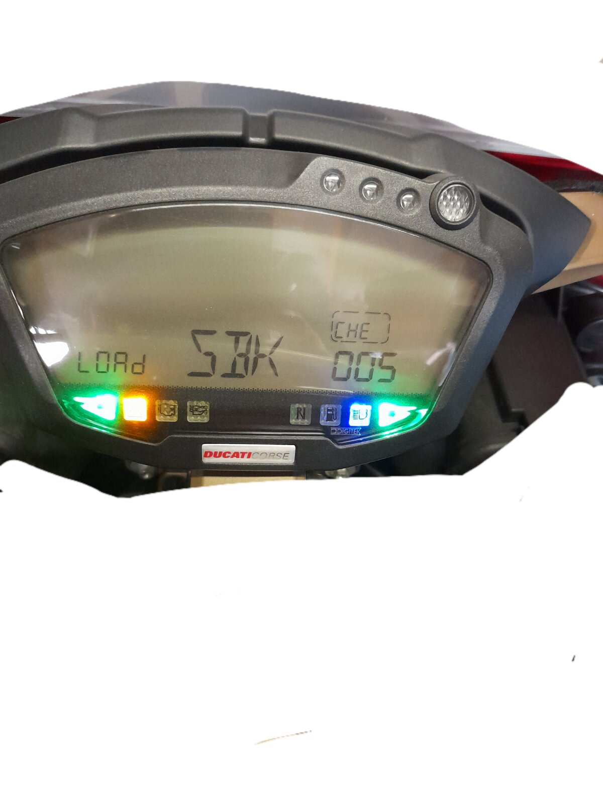

  1. Hi fellas. So, i bought a delivery mileage 1098R from the USA. I guess it hasn't been fired up for many years. I have fitted a new battery, and when i switch on the ignition, the warning lights (indicator, oil, neutral etc) along the bottom of the dashboard, are rapidly scrolling towards the middle from both sides repeatedly. In the middle of the dash is "SBK", to the left it says "load", and on the right in a box it says "che", and below that "005". Has anybody ever encountered this?
  2. Here's a photo.
  3. Thanks Chris.
  4. Been doing some more reading and found Monster owners were suffering from a similar error on their dashes. Solutions ranged from new coil/injector/pump relays, new batteries to new regulator rectifiers. Most reported that dealers had been unable to identify the cause.
