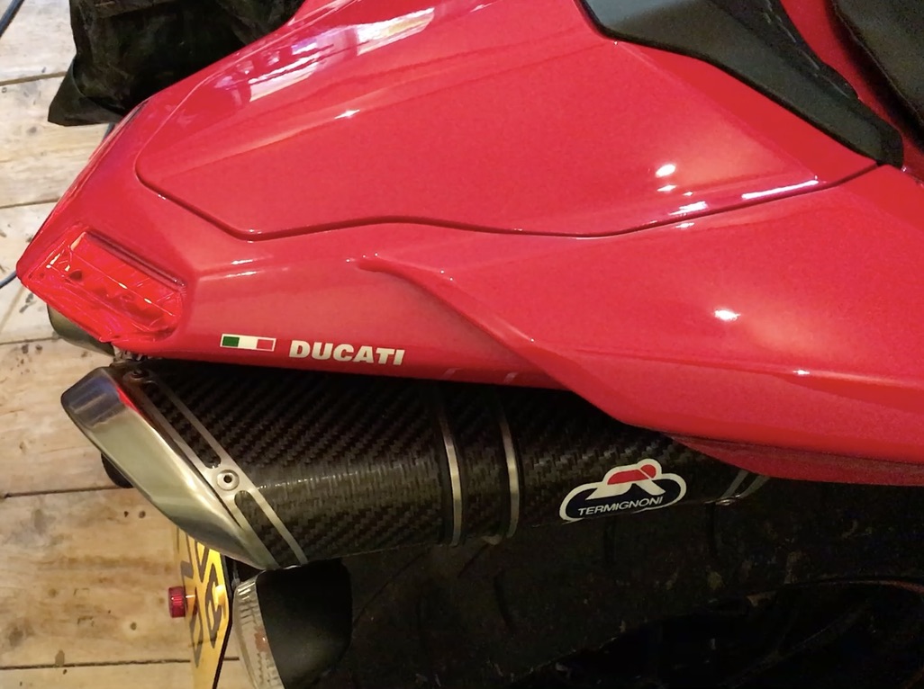

  3. These termignoni were on my 1098 and it looked pretty tidy.
    Some pipes protrude a bit past the tail unit and don’t look quite right.
    And yes, it should have the DUCATI RACING ECU which is displayed on the dash LED during start up.
    Oh, and check it comes with the baffles, it'll help during MOT time.
