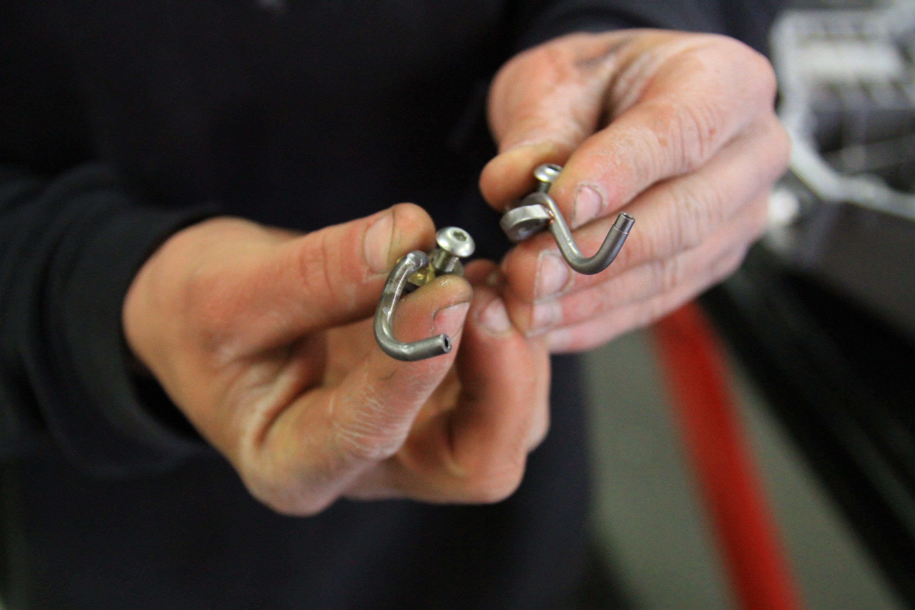

  15. Had my 1098R recently rebuilt at Moto Rapido. These little buggers were a possible cause of engine failure. These are the oil spray tubes that lubricate the cylinders. I was told one or perhaps both were skewed. Maybe, maybe not. What was for certain is that a cost a bastard fortune to fix!
