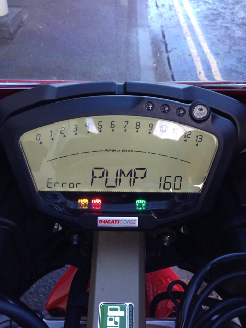

  2. I've just had my fuel pump relay replaced under warranty, similar circumstances however I did get an error on the dash (see attached). Do u have any error codes showing, u may need to cycle through the menu.[​IMG]
  3. I didn't see an error but do I need to go into a menu?
  4. Umm I did yeah, I think (was a bit pissy as I was on side of the road) if u press up on the left bar, I think the first thing it does is display errors, as u can see though my engine light is also on but I thought that was normal until the bike starts.
