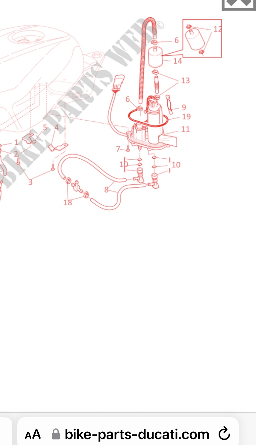

    I now have forgotten which of the 2 fuel hoses fits to which connector to the fuel tank, anyone have a photo of the pipes ?

    The parts diagram just isn’t clear

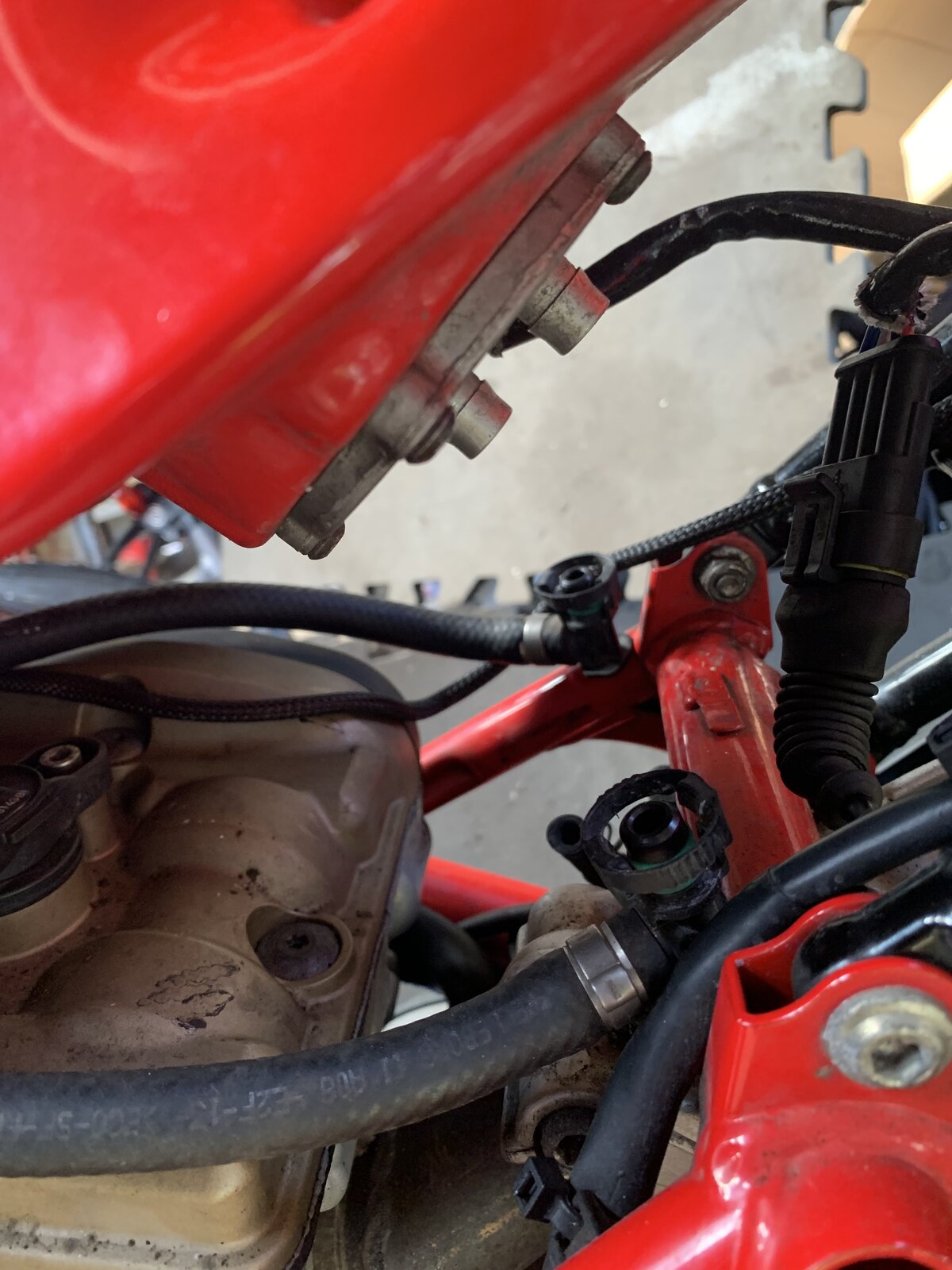

  15. because they meet at a one-exit junction (with no one-way valve) it confirms that it doesn't really matter which way round you connect (you will just have to place some trust on this one!) but it's clear that you just connect up each hose without them crossing over, i'm sure that's what i did. - I tried to enclose a picture but it didn't come through on here.
  16. One some models, like the ST2 the regulator is at the throttle bodies and it does matter which way round the pipes are but with a simple loop like the 1098 it shouldn't matter. It's only the runs of the lines which may determine it.

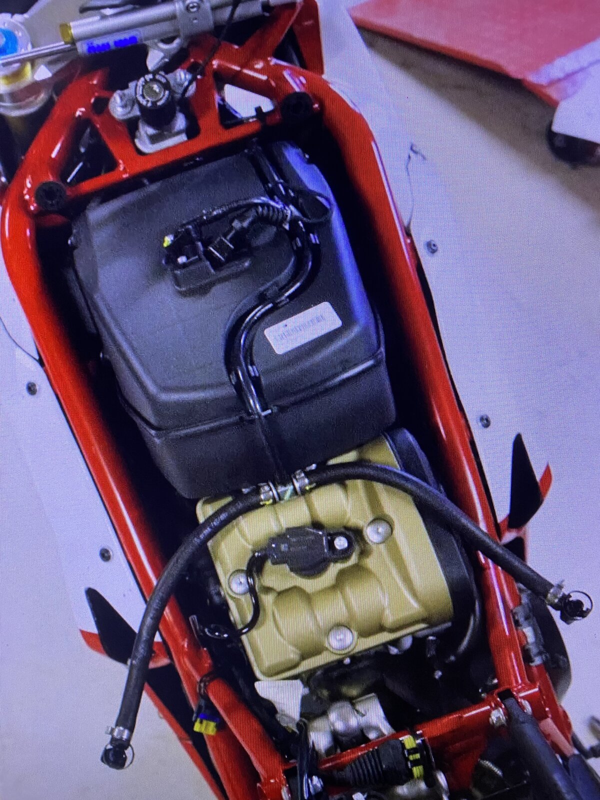

  17. here you go, just layout as per picture without crossing hoses.:upyeah:
  18. Hello Chris, yes, I’ve no problem with the layout of the hoses over the air box, but which hose goes to the IN on the fuel pump in the fuel tank ??
  19. I think that if you've been reading our posts above you will see that it doesn't matter. Whichever fits best with the lay of the hoses.
