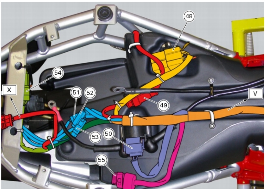

  3. Try a new pump/injector/coil relay. Cheap part that causes no end of problems. Once sorted the codes will clear.

  7. IMG_1209.jpeg Only a single relay controls pump/coils/injectors
    48 in the photo
