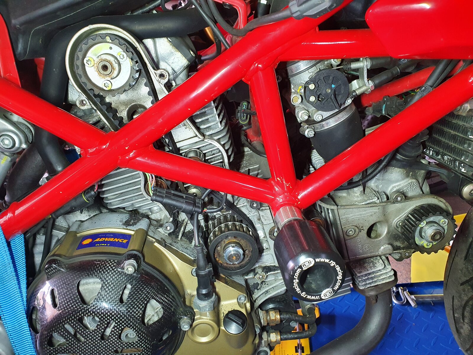

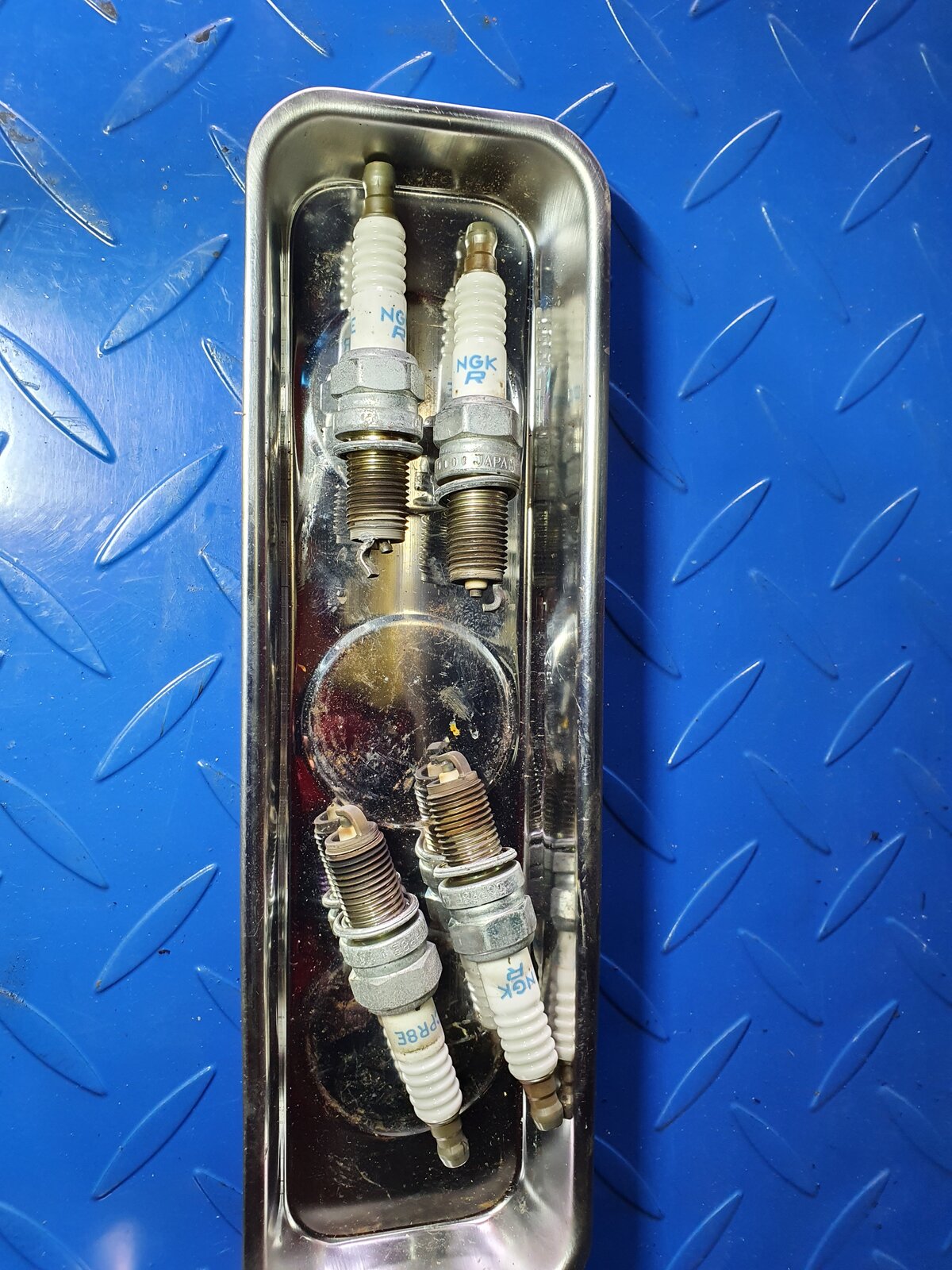

  1. Hi I'm new to the forum and am looking for advice and options following the engine letting go over last weekend on my 2008 hypermotard 1100s. Engine lost power following an overtake the back wheel did not lock up. It felt like hitting the rev limiter but I'm sure it did not. when I pulled over found that the cam side front plug lead had been broken and the timing belt was shredded inside.
    Initial strip down revealed the front belt had shredded and the rear belt was still in place. Front cam will not rotate and with the engine crank turning tool the engine with the rear belt in place will only turn about 3/4 of a rotation. front plugs look ok but the rear plugs have taken a bashing so suspect the problem started there maybe a valve broke ?. Any theories and advice welcome. Belts.jpg Plugs.jpg
  2. Hello :upyeah:, i'm sure someone will be along with some advice!! Looking at those rear plugs there has been some impact there.
  3. Ooerr chief, complete engine strip and rebuild, deffo damage lay within horizontal cylinder, may be cheaper to source a replacement engine with the belt letting go at high rpm's.
  4. Hi, not heard of this letting go before! Guessing its belt then the rest rather than other way round. Sounds like full rebuild or replace :(

  6. A friend had similar happen to his air cooled numpty and we wondered at the time if the plug cap had somehow been loosened and as the belts run very close to the cap if that had eventually caught up in the belt and caused the damage?
  7. I would say he has dropped a valve. That stopped the camshaft and the belt shredded trying to spin over a locked cam which in turn has done the plug lead
  8. I take it back. It happens all the time!! Lol

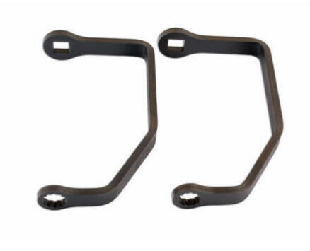

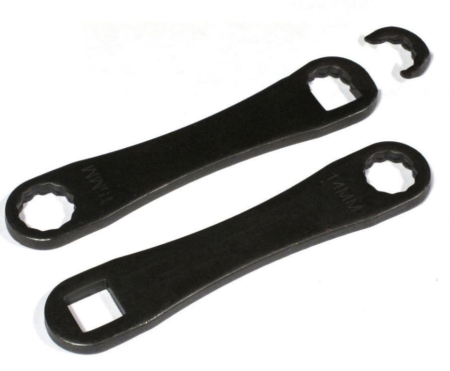

  16. Found some time to look at the bike again over the weekend and found none of my 14mm spanners fitted the head bolts with the engine in the frame. I found some specialist spanners on ebay and my question is do I need these spanners only to take the heads off while in the frame ? or once the engine is out of the frame can I get the heads off with just a 14mm ring spanner ?.
  17. Those are for applying a torque wrench to cylinder head nuts on re-assembly, you can get access with a conventional spanner when dismantling.

  18. Thanks Chris so once the engine is out the frame a normal ring spanner will do the job.
