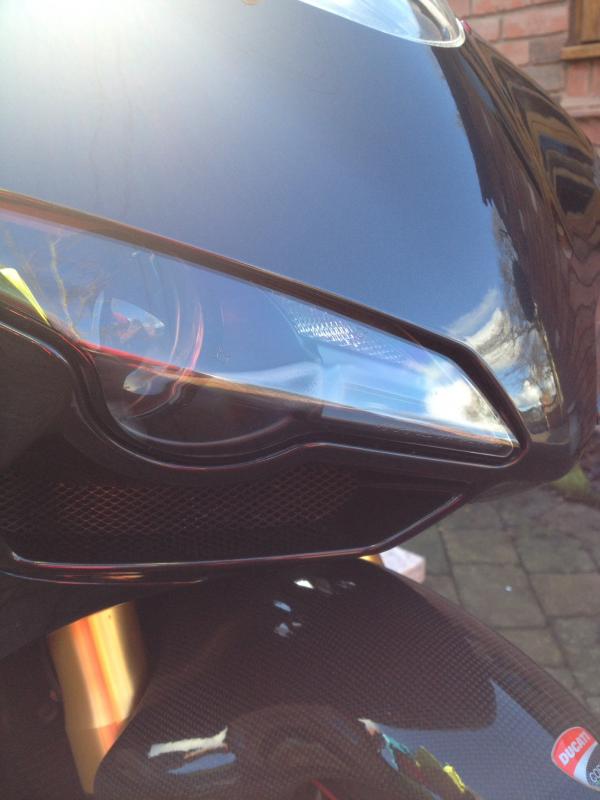

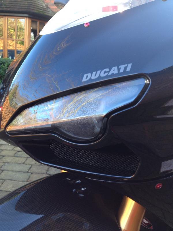

  1. Hi all. Upon cleaning my bike this afternoon I noticed that the headlights were all fogged up. The bike is still under ducati Coventry warranty so I hope that it is covered. Have many of you had experience with this and how did you get on? Would just like to know your thoughts and experience with this problem.
    Thanks Lew.
  2. Drop a very small gel pouch inside, like you get in shoes boxes etc. A small one. Ask SWMBO.
  3. They all do it.........................................it's part of the character :biggrin:
  4. Mine does it always has. Goes away after a bit.
  5. Yup mine has done it since new especially when you get temp changes. Seen all sorts of attempts to clear it, from sealing to gel packs but there has never been a definitive fix as far as I'm aware. Happpens on mine more with main beam as its used less, I just don't worry about it as there are a host of other things to attend to first, the misting dash is more annoying as far as I'm concerned.

  6. Thanks for replies. I'm just waiting for jhp to get back to me about this and see what they can do.

  10. If you pop the plastic covers off the back of the lights that cover the lamps, drill a small hole in the bottom maybe 4mm and refit. It's not a cure, but helps the air get around the lamps and reduces the amount of condensation that gets trapped.
