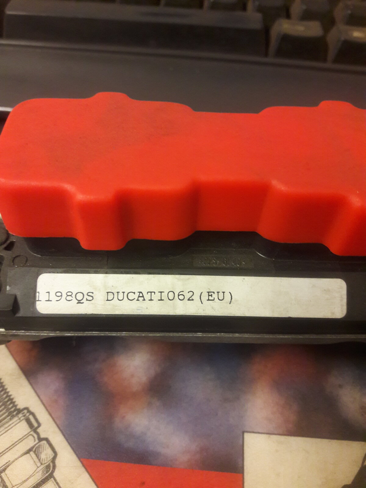

  7. what part numbers are you looking for its got 1198qs ducati062 (eu) written on it

  9. I think that ECU is for the 1198SP and will have both DTC and DQS in the mapping. Does it have 3220MA14 on another label?

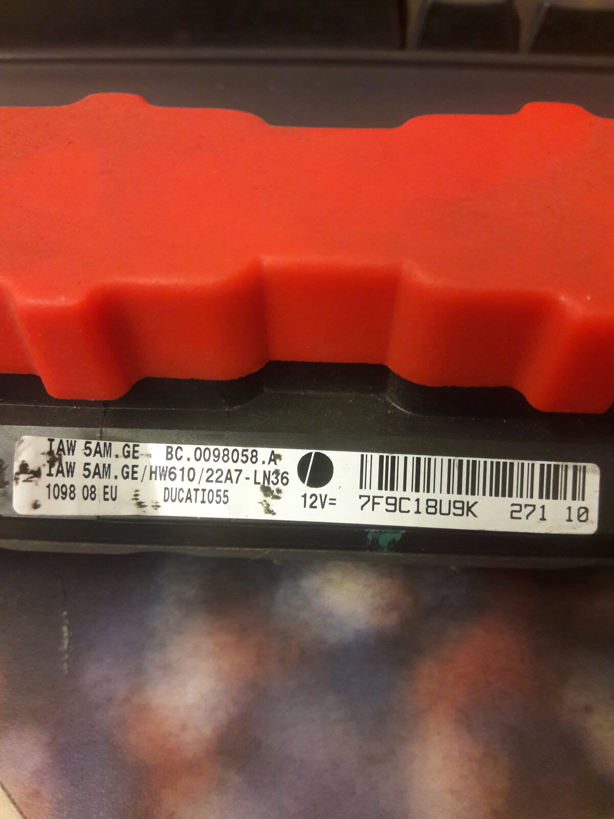

  12. the ecu i have here has got 22a7-ln36 on it
  13. If you are not the first owner, it looks like your stock 3215PQ58 ECU map 28641831A has been reflashed to the DP map. Only way to tell is to hook it up to JPDiag. @cookster ’s ECU can be reflashed to that map, as can any IAW5AMHW610 ECU.
