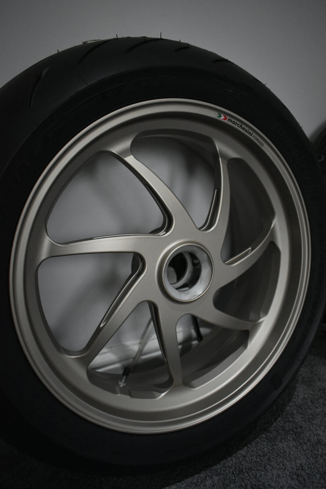

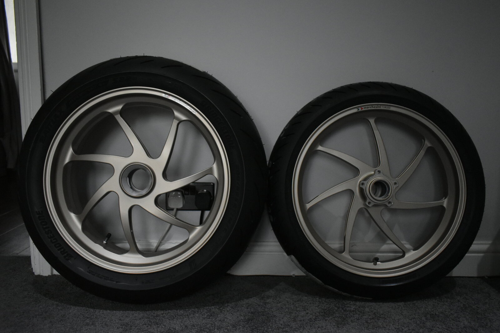

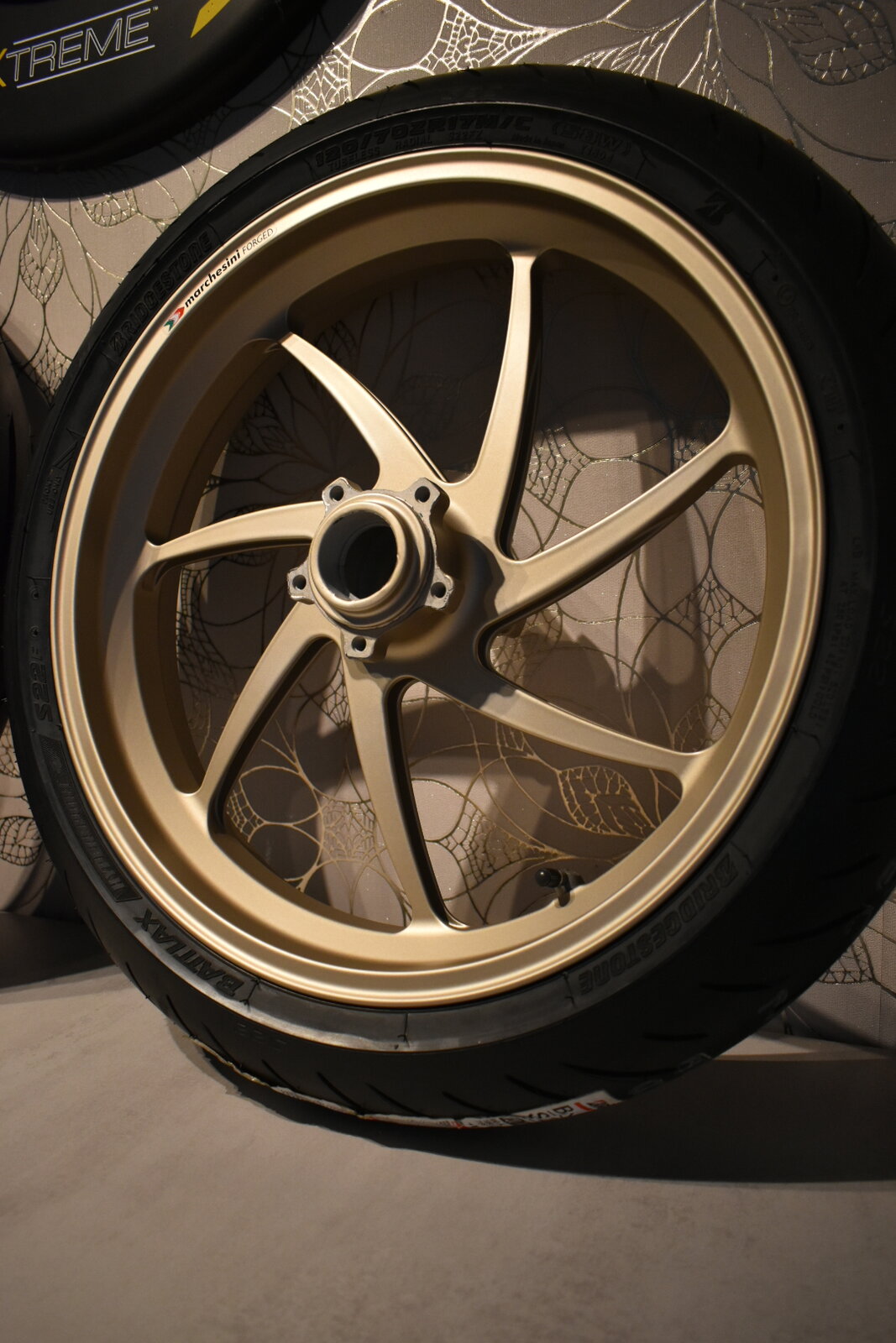

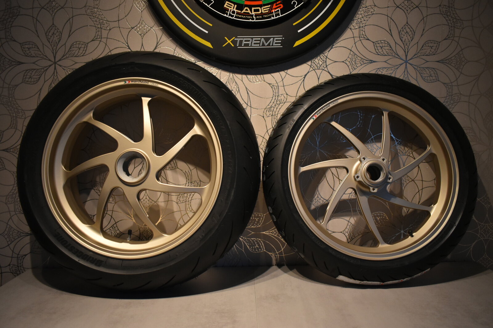

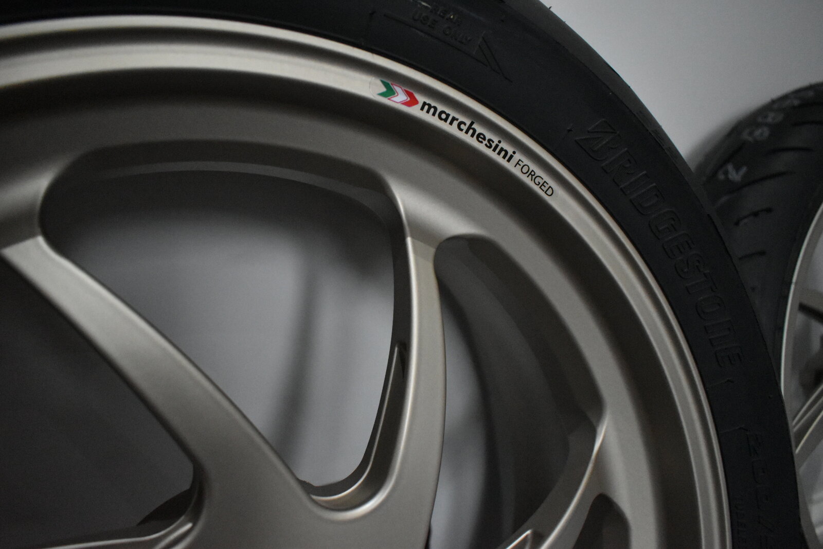

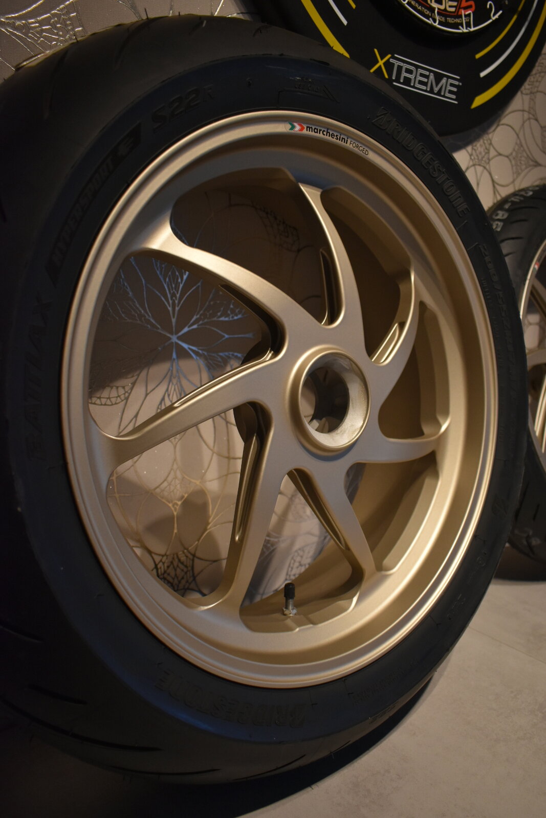

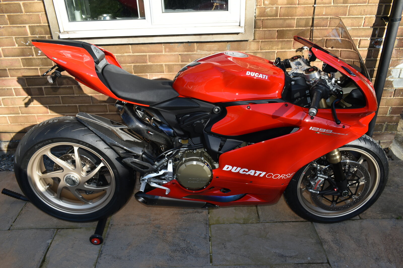

  1. Just got the wheels back from the powdercoaters, I have fitted new bearings and seals.
    Fresh new set of Bridgestone S22 200/55 & 120/70 fitted.
    Will be mounting them to my 1299 base model once the wheels are balanced, time to say goodbye to the chicken feet.
    Very happy with the results from the powdercoaters so far, can't wait to get them on the bike.
    I ended up going for white gold with matt finish, when the light hits it you can see the metalflake, don't think the pictures do them justice.

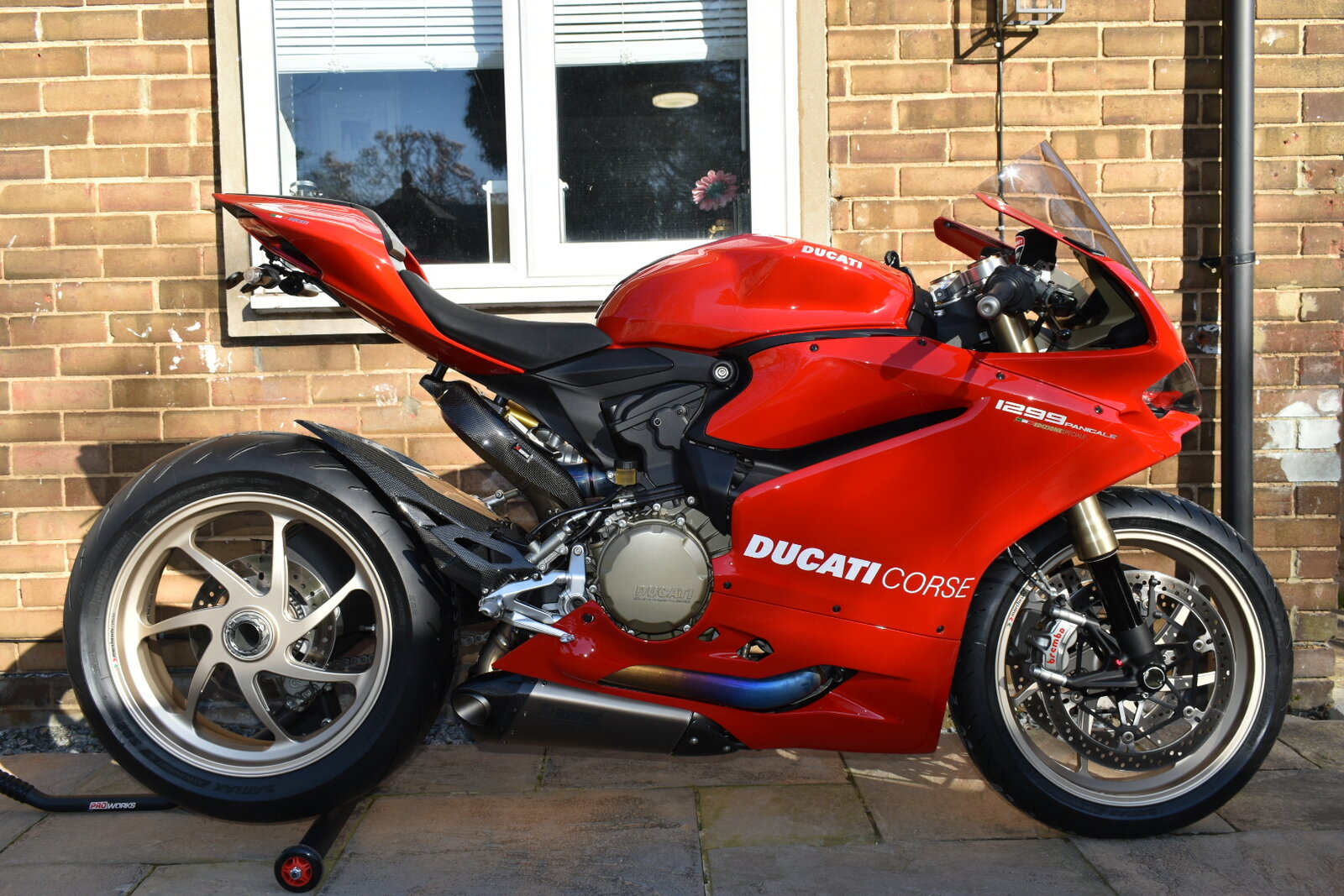

    Pic of bike before Akra install & OE wheels just for reference
    See pics below for 7 spoke 1198S wheels.
    Will update soon :cool:
    DSC_0023.JPG DSC_0024.JPG DSC_0025.JPG DSC_0019.JPG DSC_0020.JPG DSC_0021.JPG

  6. wheels look great - are they are straight fit?
  7. thanks everyone for the kind comments.
    No not exactly, rear wheel is a straight swap but the front requires a spacer kit, not sure on the exact dimensions off the top of my head but they can be found on google somewhere.

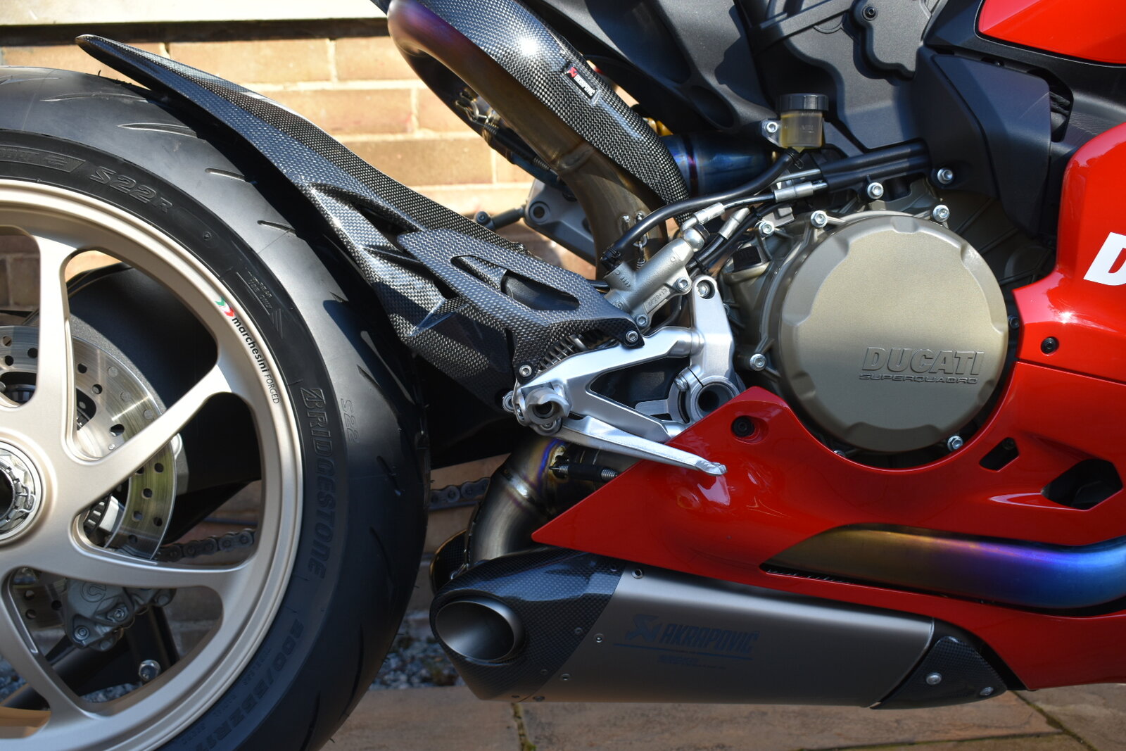

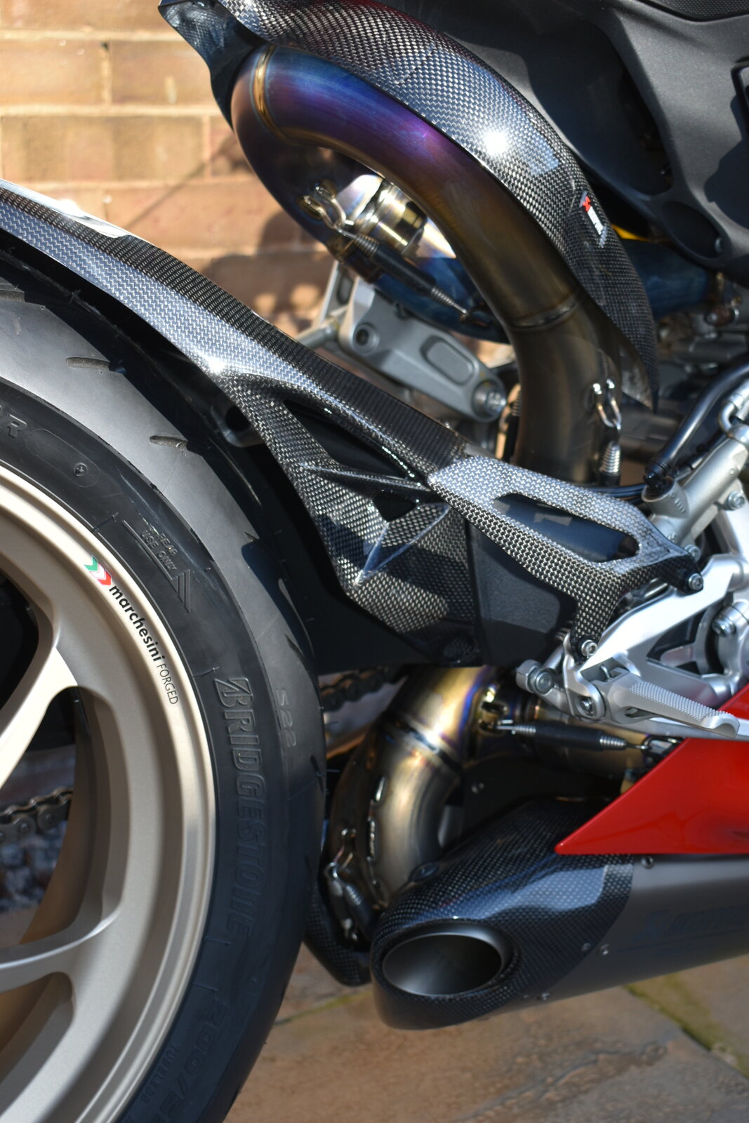

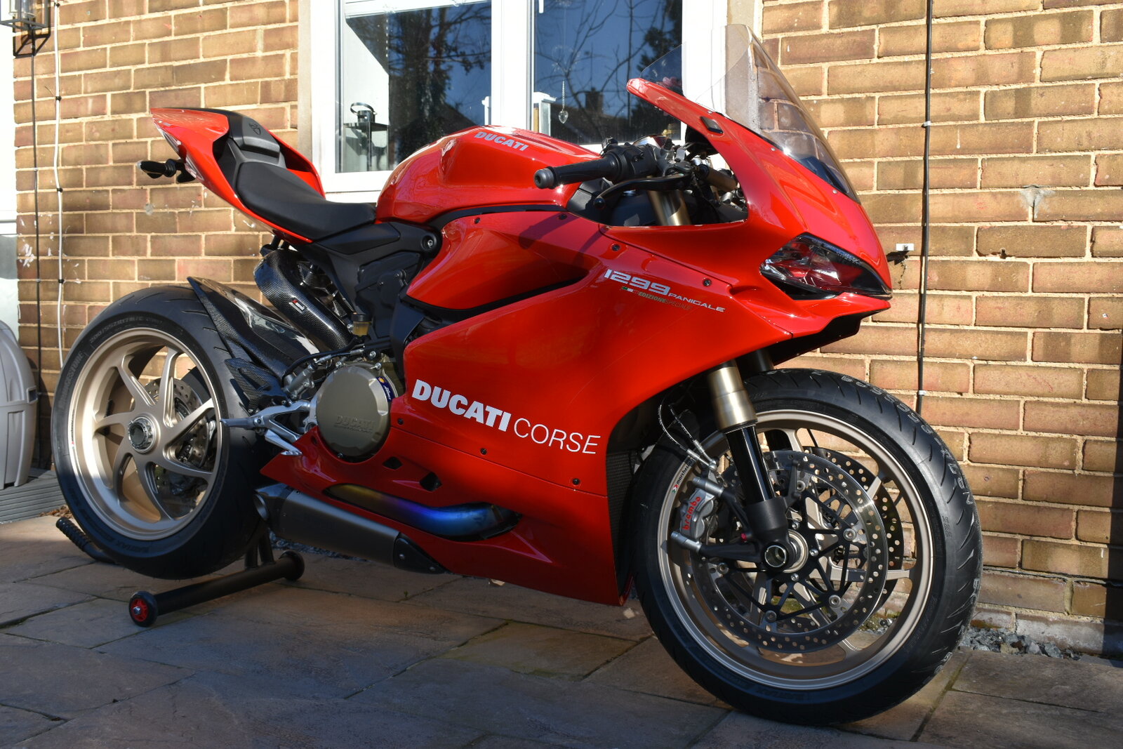

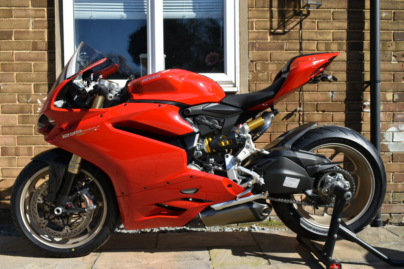

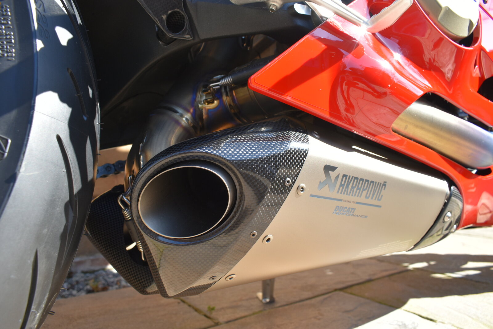

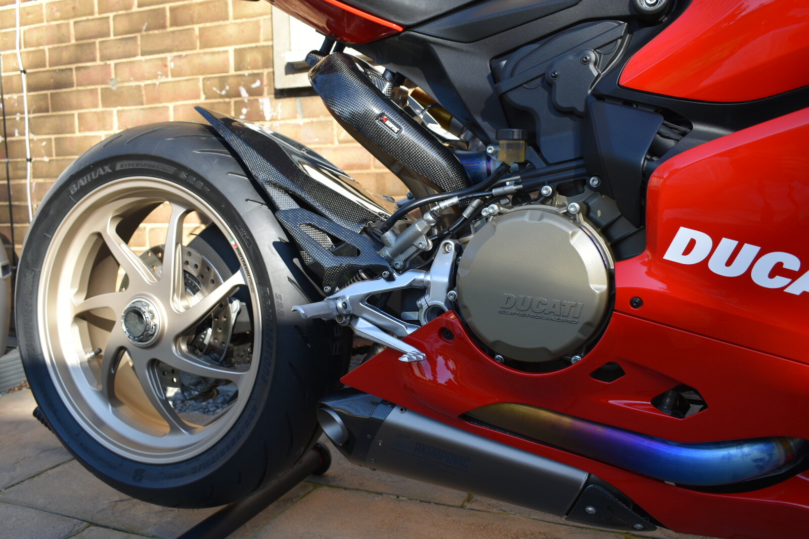

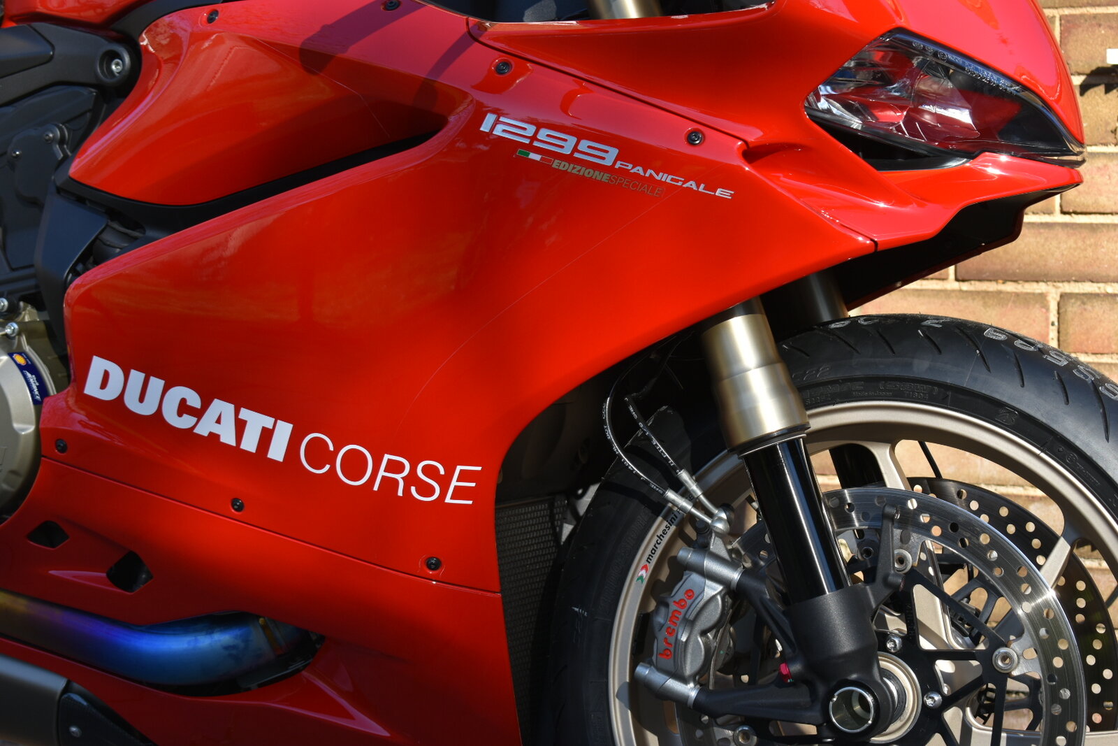

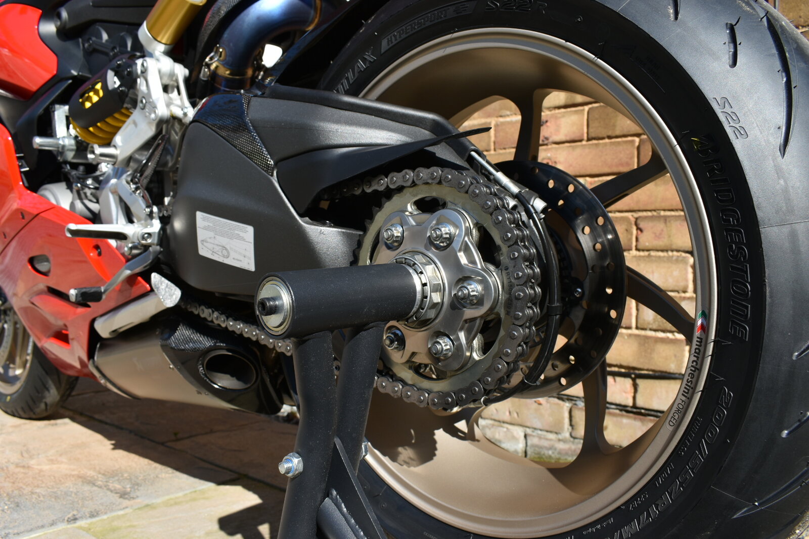

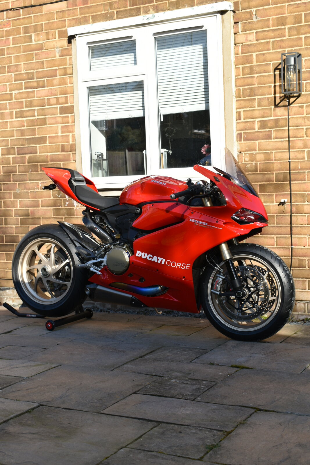

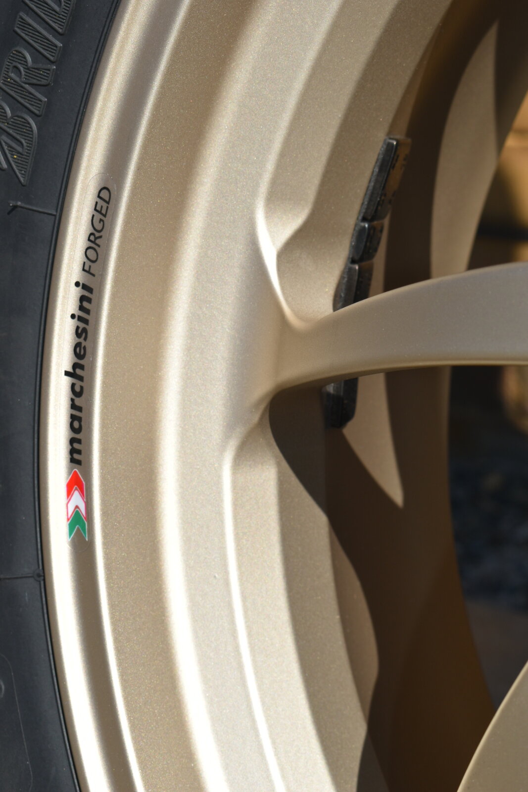

  14. Update as promised.
    Note :- Front mudguard not fitted, waiting on a brake line clip to hold the abs line in place ( Gloss carbon )
    Gloss carbon hugger + heelguards fitted to match the akrapovic.
    7 spoke wheels fitted.
    Stuck a couple of stickers on, not entirely sure about the Ducati Corse.. may remove.
    DSC_0064.JPG DSC_0062.JPG DSC_0065.JPG DSC_0067.JPG DSC_0068.JPG DSC_0069.JPG DSC_0071.JPG DSC_0072.JPG DSC_0073.JPG

  17. I knew I was skipping the rules a bit..
    Maybe I can have Ducati Performance instead ( as I bought the optional performance exhaust ? )
    :laughing:
  18. wheels look excellent :upyeah:, stickers look pony
  19. Appreciate the honesty
    Still in two minds..

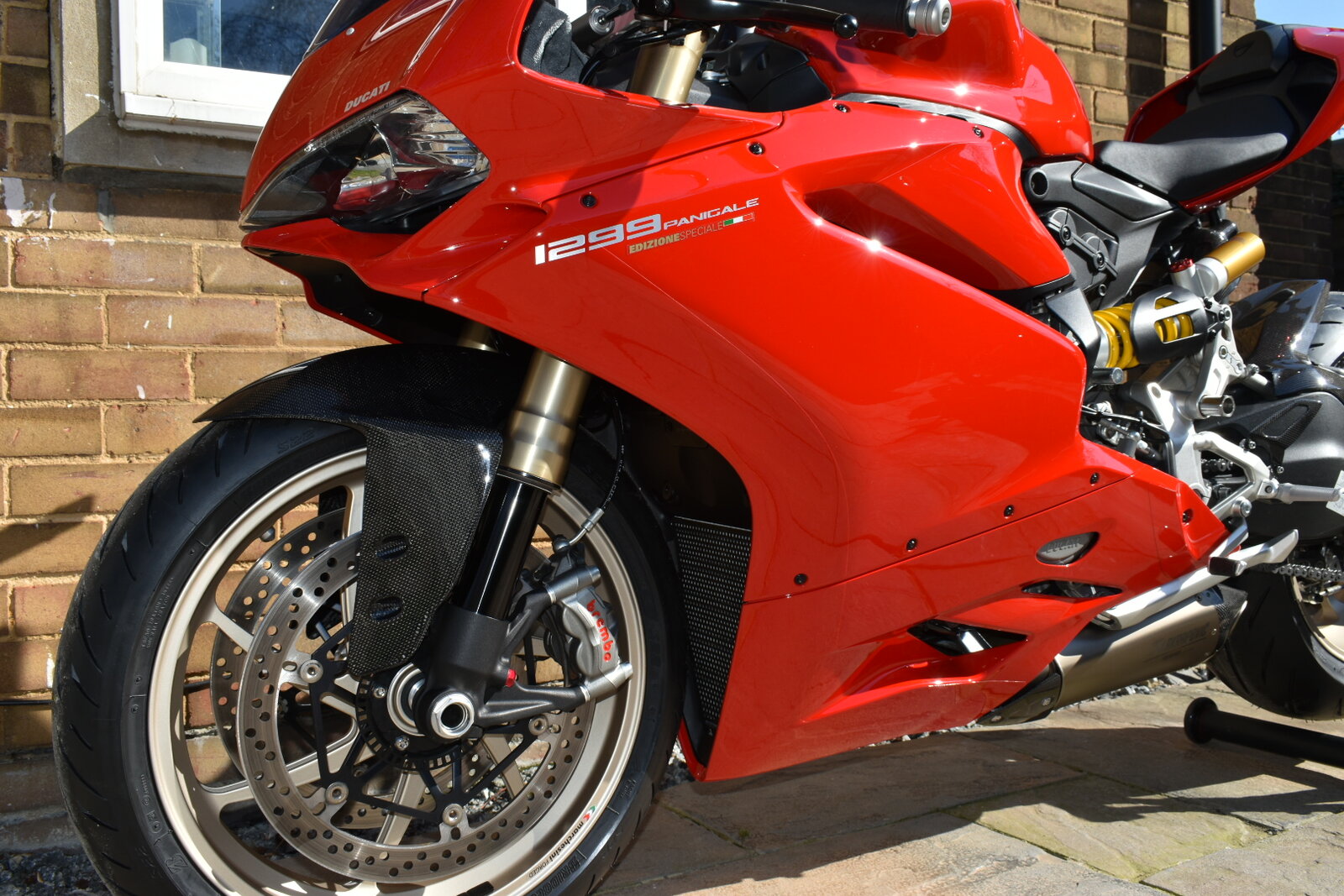

  20. Finally got the front mudguard on, decided to remove the Ducati corse decals.
    Final update to thread.
    DSC_0078.JPG DSC_0079.JPG DSC_0080.JPG DSC_0082.JPG DSC_0083.JPG DSC_0084.JPG DSC_0085.JPG
