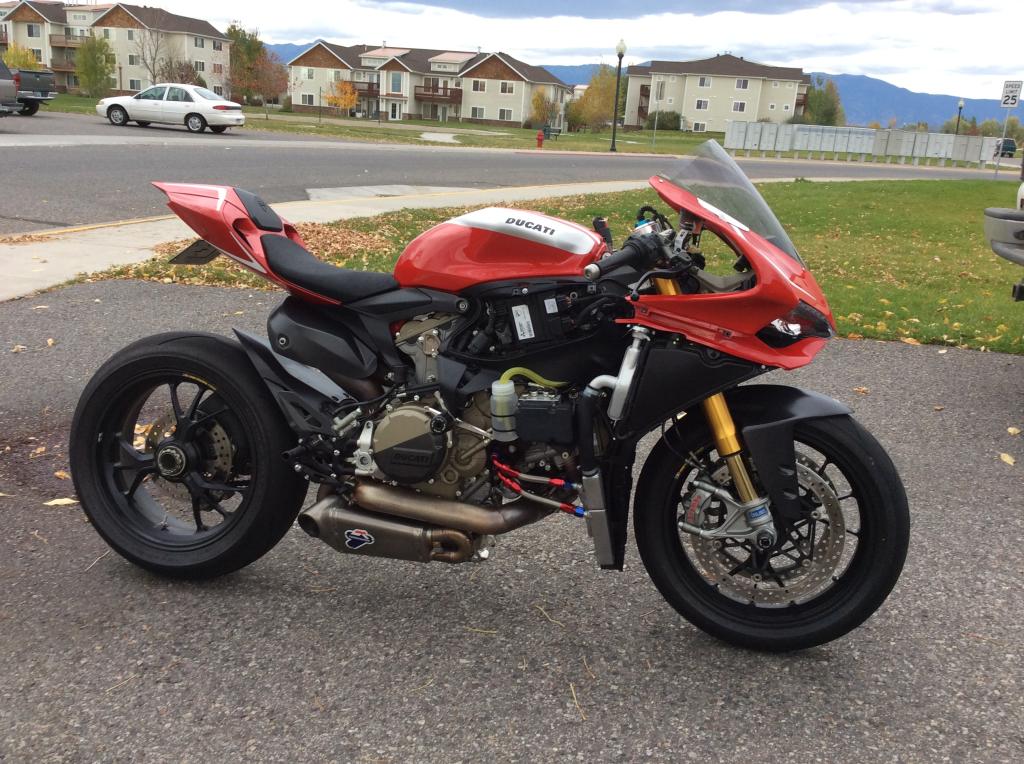

    Here is a brief outline for my R winter transformation, STTK (SuperStock) specification + a few extra's. My design brief is for a pure race look but (barely) street legal "Street Racer" no directionals - high beam - 1 bar end mirror, inspired from the early days of articles in UK's Fastbike & Bike mag's on pukka 916 955 SP road race builds, and most recently Koen's Roche Tribute & Track Bike builds.
    Stage 1:-
    STTK long header pipe kit (thanks "Thamer")
    Kaemna STTK ECU, with ABS & chip ignition switch delete
    Custom brake lines w/ QD connects, QD front wheel kit
    STTK radiator & oil cooler (thanks" Thamer ") Samco hose kit
    Moto holders seat & fairing w/ MWR oversized intake race filter
    Tamburini velocity stacks & injector stands & fuel tank ( larger air vol')
    Carbon/Kevlar fairing kit, DP race seat
    LH - RH race switch ass's, lanyard kill switch
    Magnesium triple clamp adj' offset - OZ Mag' forged wheels
    Ohlins MK2 shock & Nix cartridge kit or may go with KTECH ? 24 deg insert
    DP susp' Gyro potentiometer sensors
    PS3 shift with auto blip down shift
    Thumb rear brake.
    Micro LED headlight hidden flush in air intake

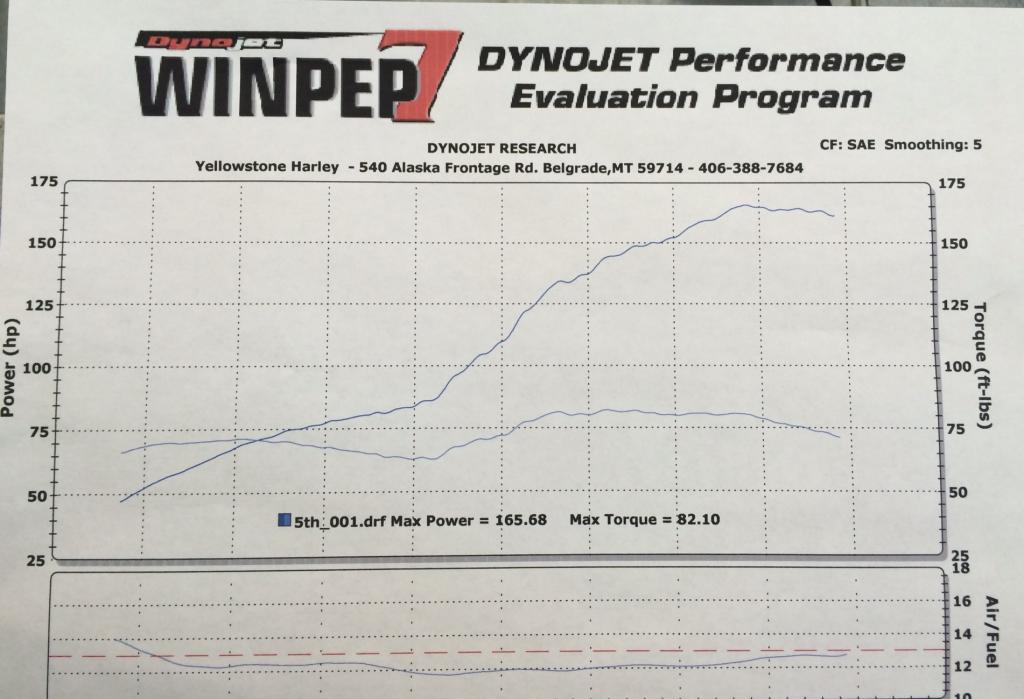

  11. Re Dyno runs, only thing that matters is using the same dyno & setting for all tests, once I have the base run I'm only concern with the total area under the power curve, I know the STTK header shifts the power and has broader mid range with a small increase on top end. I would like the WSB system but might have to wait a bit.
  12. Ok so today I removed all the bodywork and ran the bike over the the local HD dealer to get a base Dyno Run, the shop told me right away that they have low output readings and many people are disappointed with the peak numbers, most important think is the power curve and the total area under the curve.
    So here it is probably the lowest number ever posted but the curve looks good just like all the other R's I have seen posted.
    Well it can improve from here

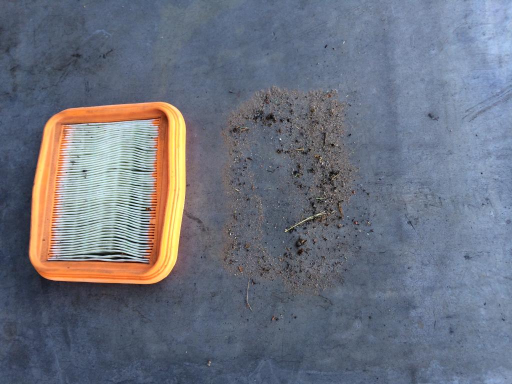

  13. [​IMG]

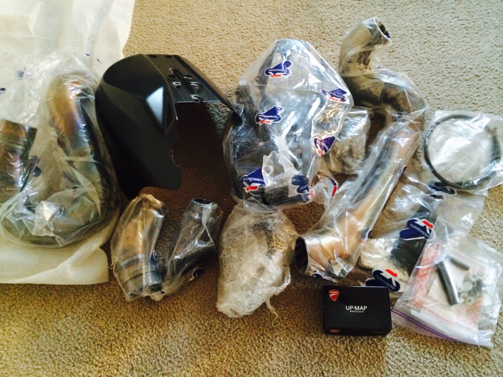

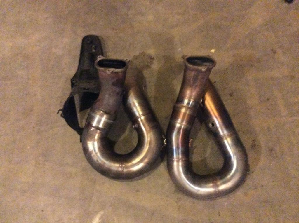

    This was first tap about 3x this amount of bugs & dirt eventually came out, OE + 3000 miles.

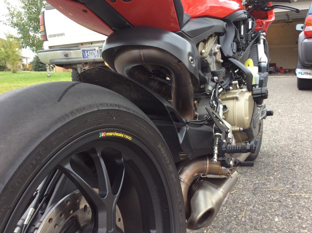

    Removed seat frame, full Termignoni system & lower radiator pretty pain staking work but very satisfying, galled threads on rear O2 sensor, dealer didn't use any anti seize, also had to remove the small M10 thread caps on the header pipes for transfer to STTK headers.
    I have the option to keep or remove the plastic lower radiator elec' fan with supplied modified tunnel & the thermostat housing. I'm removing both, I can see the grams & eventually KG's coming off, the full Term's have cast stainless Cyl' port outlets while the STTK is fabricated stainless, noticeably lighter.
    This is the mess I have right now as I call it a night
    This is only image I could find of how the installed oil-rad' cooler should look
  14. I like the way you post the before Dyno run in all it glory, just so it a bigger wind up when you don't post the final one for comparison, it could be fun - don't let me down ;)
    Just out of interest, why are Dyno's not calibrated so they are accurate from one to another? If that one is running low and people complain why don't they get it recalibrated. Or is it just every Dyno in the country reads low as people always expect more and they are in fact all the same?
  15. Theirs just a lot of variables in the electro - mech sensors, bearings etc. I'm @ 4850 ft and the dyno supposed to have a calibration factor for sea level, as long as I use the same dyno the results will be valid. I bet If I went to the west coast and used one of the new units v 10yr old I bet I would have higher peak numbers, I'll probably do that at some stage with same tune level just for a comparison
  16. I thought American Dyno's were always calibrated to read more? - we call it American BHP over here to distinguish between the two... :Shifty:

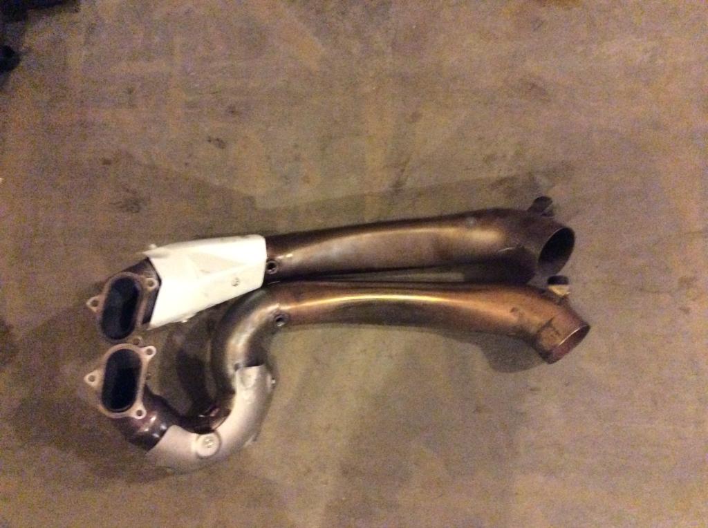

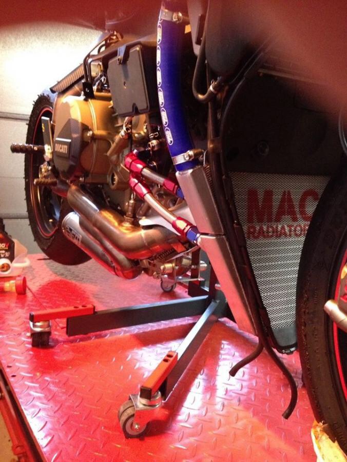

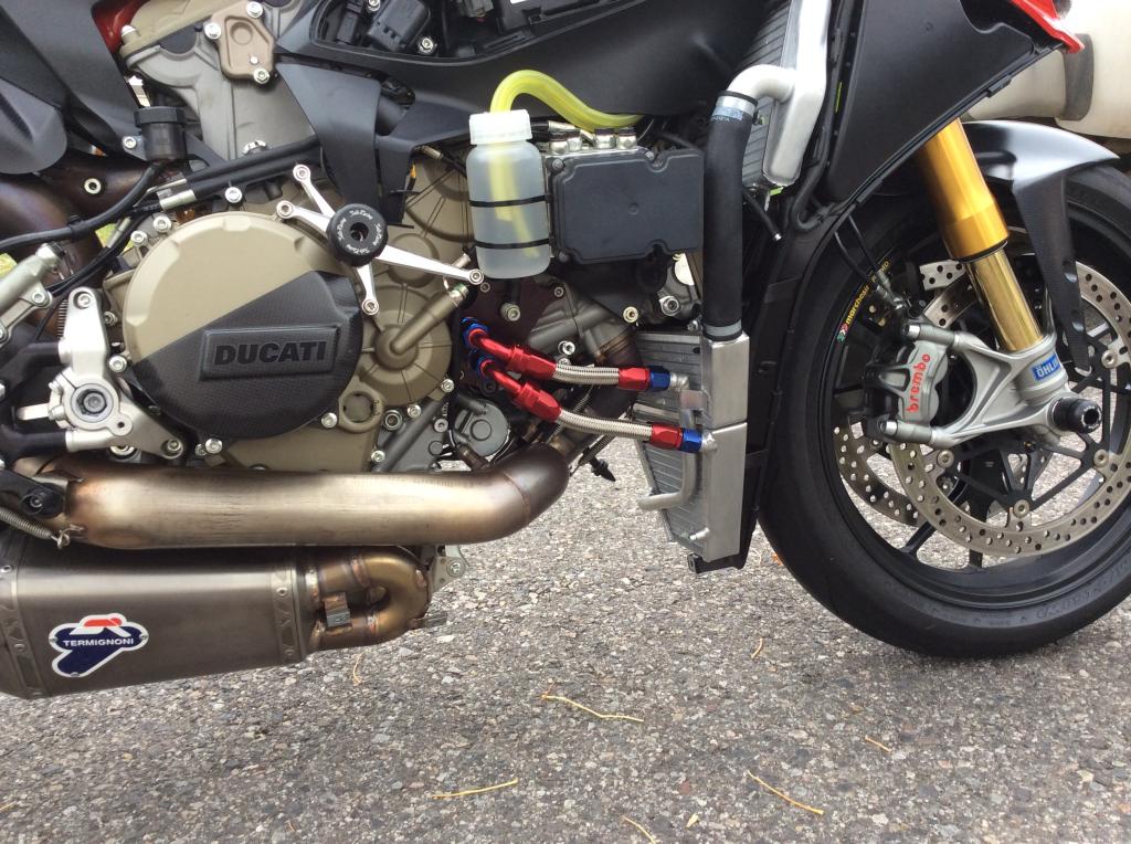

  19. Worked all day, had to skip the thermostat removal requires pulling off the airbox frame so will leave that until i can combine it with SAS servo removal - 24deg steering inserts - triple clamps etc. I now have the STTK long headers, replaced stock water/oil cooler with the MACS front mount oil cooler - radiator & adaptor plate. Tried to upload the STTK map but display this map was already loaded.
    See the difference in length because the Cyl' head stub mounts are fab'd instead of cast these longer pipes are noticeably lighter, could be thinner wall stainless , coated all slip joints with copperslip took quite a bit of fiddling to get the cans on though, once it heat cycles a couple times should take a set. The fan & tunnel no longer installed, some weight loss already achieved, wait a see when I finished where I end up.
    Just took went out for a ride, has noticeable improved mid range hit V the fully Term' s short header, even after a hard quick blast the temp never went above 176F, it's even more of a wheelie machine than it was before

  20. Remember you have DIN SAE @ PS power ratings, Dynojet is default SAE as quoted on print out
    Since I'm at 4850 ft elevation which equates to 14.4% power loss
