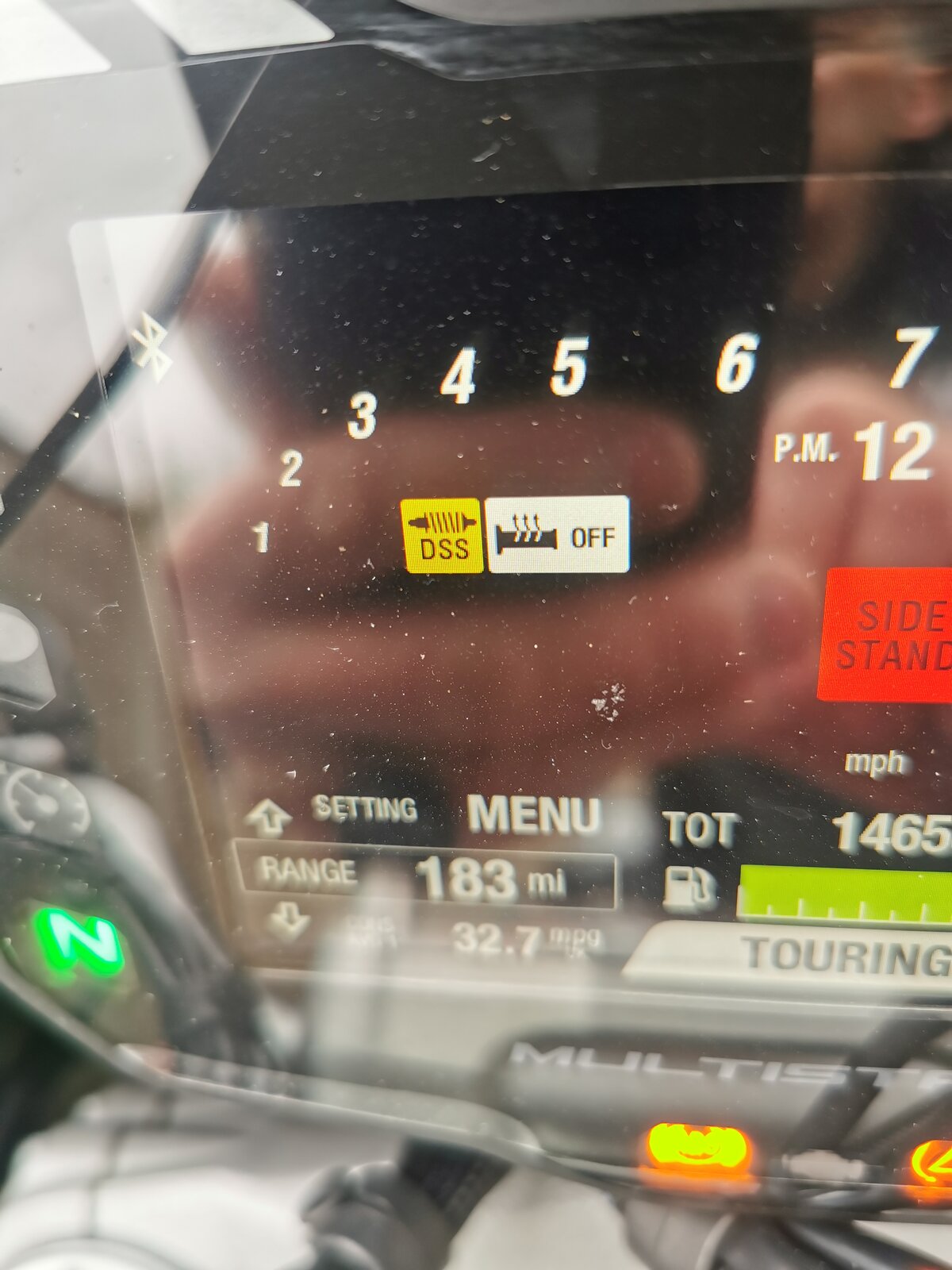

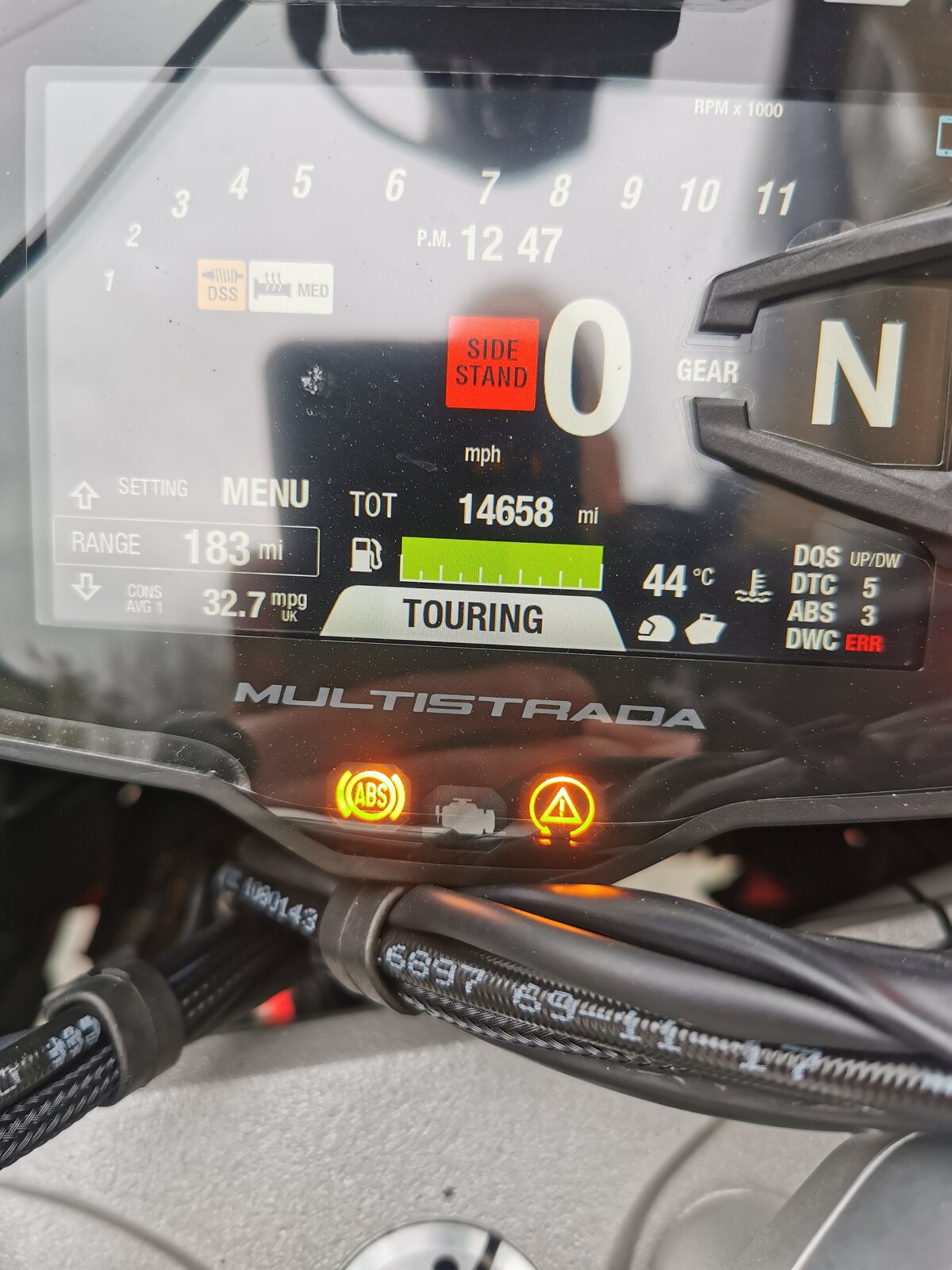

  1. Hello.. Dug the bike out last week been out for a ride, the DWC is displaying an error and the bottom of the display the triangle is flashing, the rear shock is lite up yellow on the display.
    Ive checked the connections on the black box nothing damp and all the fuses test OK.
    Any ideas??
    Thanks Gary

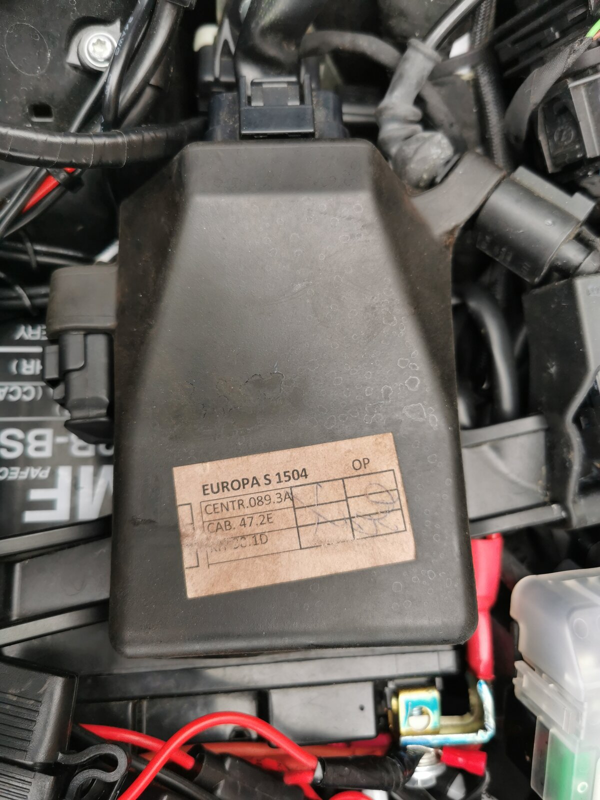

  8. Had the bike into the main dealers this morning, the small black box under the seat is the problem.
    A new one is on order, to be fitted in a few weeks £328 job.
  9. I would very much like to see what is inside the box and see if it is repairable. Will you ask for the old one back?
  10. Yes I'll ask for the black box I'll open it up and see what's gone on inside.

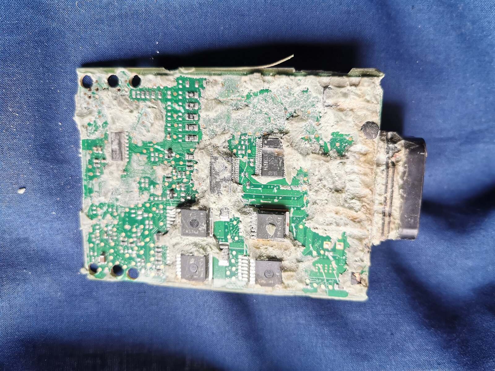

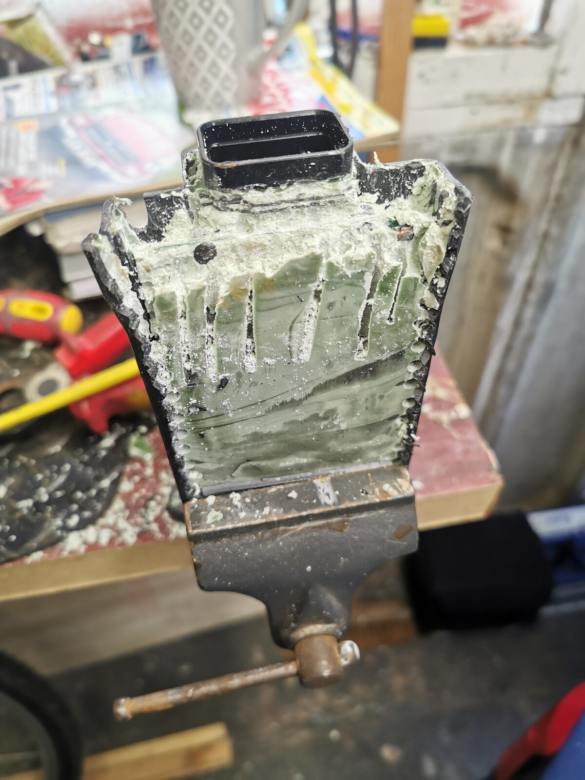

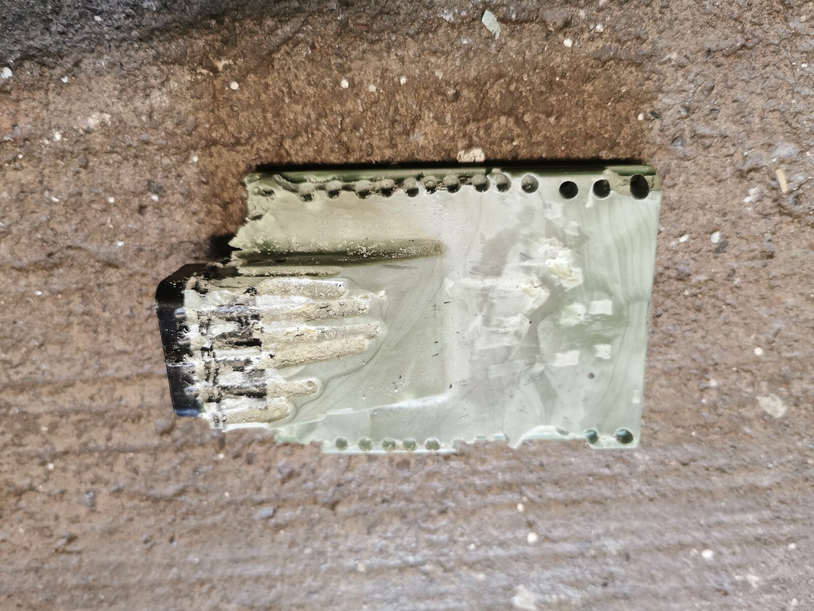

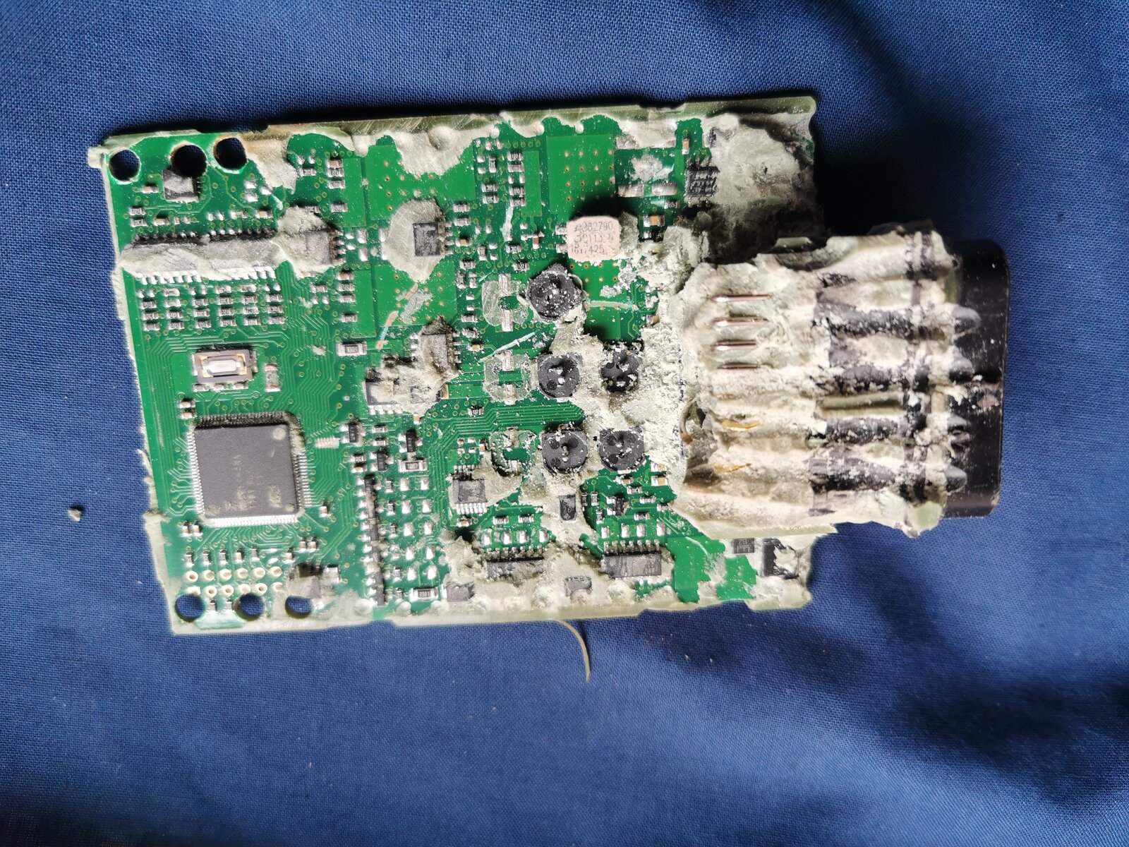

  12. Bike been fixed today, new black box fitted all OK now, borrowed a ducati multistrada v4s was a great bike felt lighter and flickable the quick shifter worked better than mine and at lower speeds. I did press the toggle switch instead of the indicator switch as the position has moved slightly apart from that the bike was fantastic.
    I got the old black box from the 1260 apart but no evidence of any fault but must of been somewhere.
  13. With all that potting they clearly do not want you prying in there!!!
  14. Thank you for the update it is good to that they're potted so as to make them less vulnerable to the elements, though I'm not sure how the dissipate heat build up if there is any.

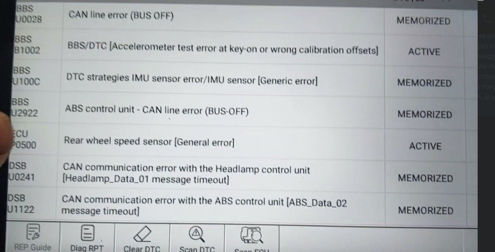

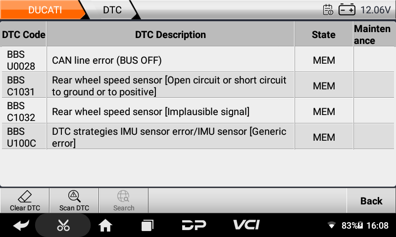

  17. Had a similar error on my 1260s the other day.
    Apologies for the fuzzy pic...
    Plugged in the ODBStar and read the errors
    Pretty confident that the top and bottom errors are the result of the middle two... Replacement rear wheel speed sensor from a V4 PP Multi sitting on my kitchen table. I'll be fitting that tomorrow if I can find the time.

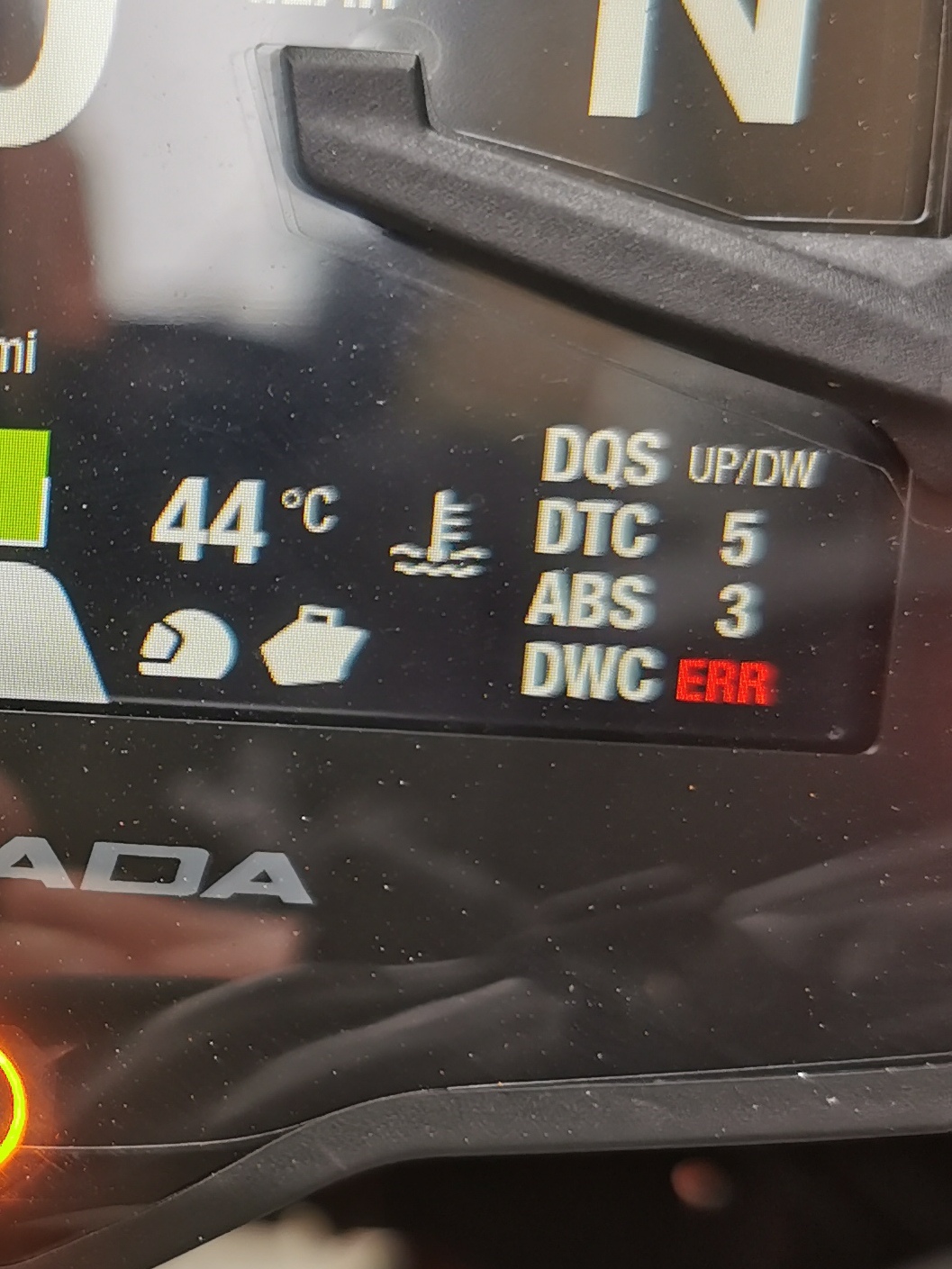

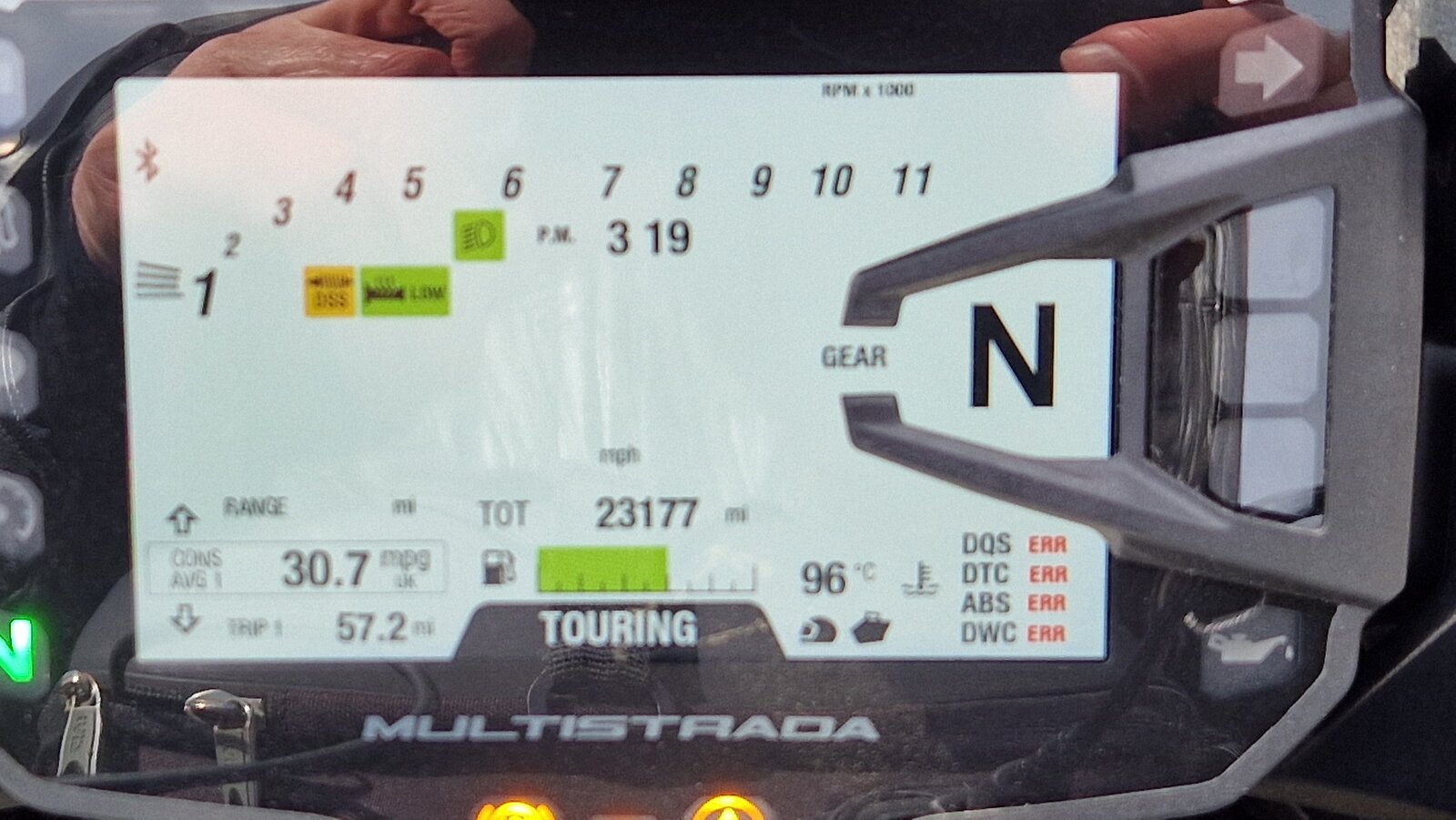

  18. I had a rear sensor error. After resetting the error went away. It didn't solve the DWC problem. I found a bbs unit from mts1200s (2016). According to the electrical diagram they are compatible. I will try to connect and test in 2 weeks.
