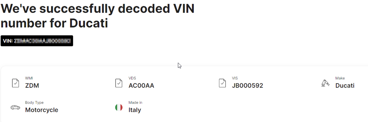

    Would like to ask more experienced owners about VDS numbers on our bikes.
    Trying to sort at the moment very bad experience with one parts supplier from Italy. I have recently done service on my leaking fork. Ordered the KIT 34921951A and for some reason Ducati decided that two top bushings need to be ordered separately.

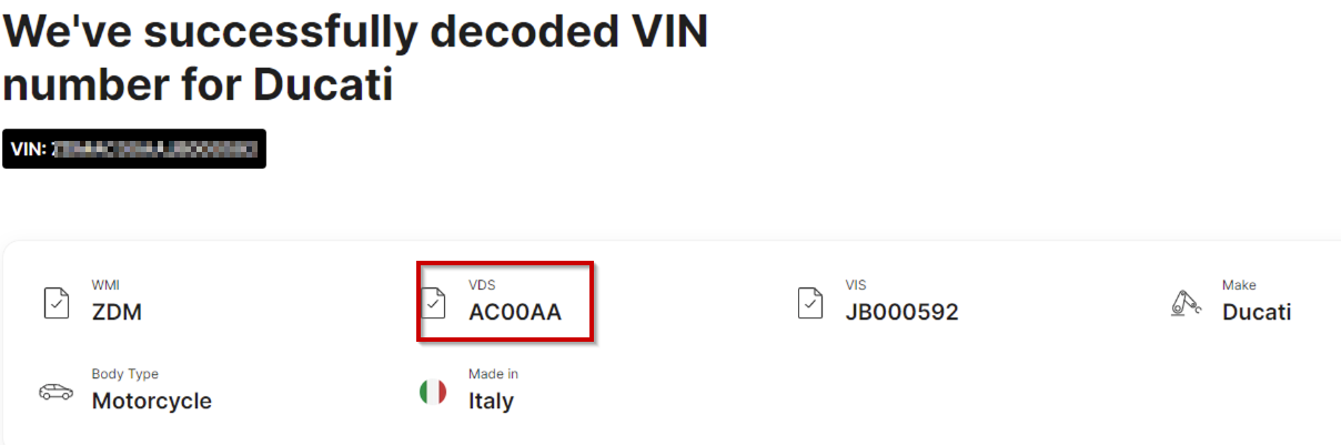

    So I have checked theirs website and found the two under no. JMP 751.01.66 which is listed for MTS -AC00AA. This VDS no. I found when decoded my VIN.
    They told me that I need kit no. JMP 751.01.65 which they have listed for Husqvarna, KTM and Yamaha.
    Now they trying to tell me that the kit is for MTS 1260 and they have the same VDS no. as my 1260S
    If I will forget all the emails flying back and forward and treating customer like a fool for 26e can someone confirm that all 1260 have Showa forks and only 1260s have Sachs forks?
    Do 1260 and 1260S really share the same VDS numbers?
    1260 - https://www.officine08.com/p76603_boccola-forcella-48-7x50-7x20mm-coppia.html
    1260S - https://www.officine08.com/p83475_fork-bush-46-7x48-7x20mm-pair.html
    Thank you for any advice
