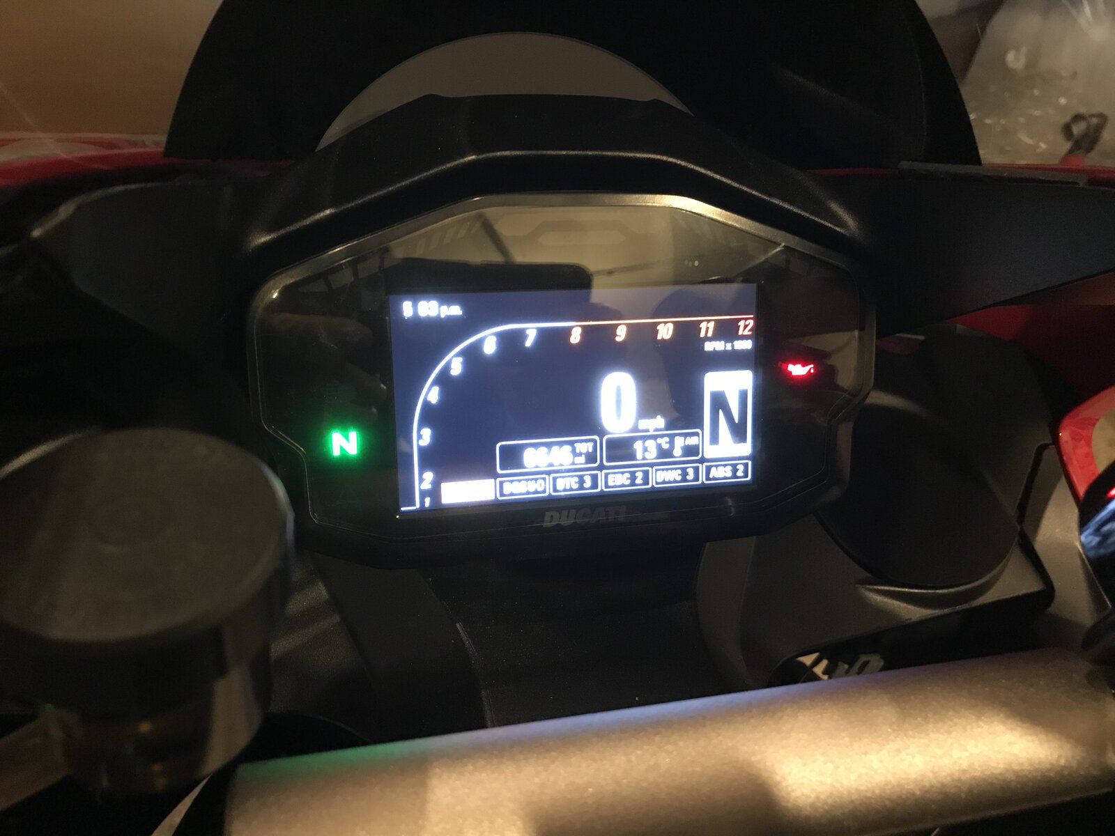

  8. Fitted. Got the unknown device and an engine error code which I can live with. Speedo, gear indicator and all other stuff seem to work ok but won’t know for sure until after a ride out. :)

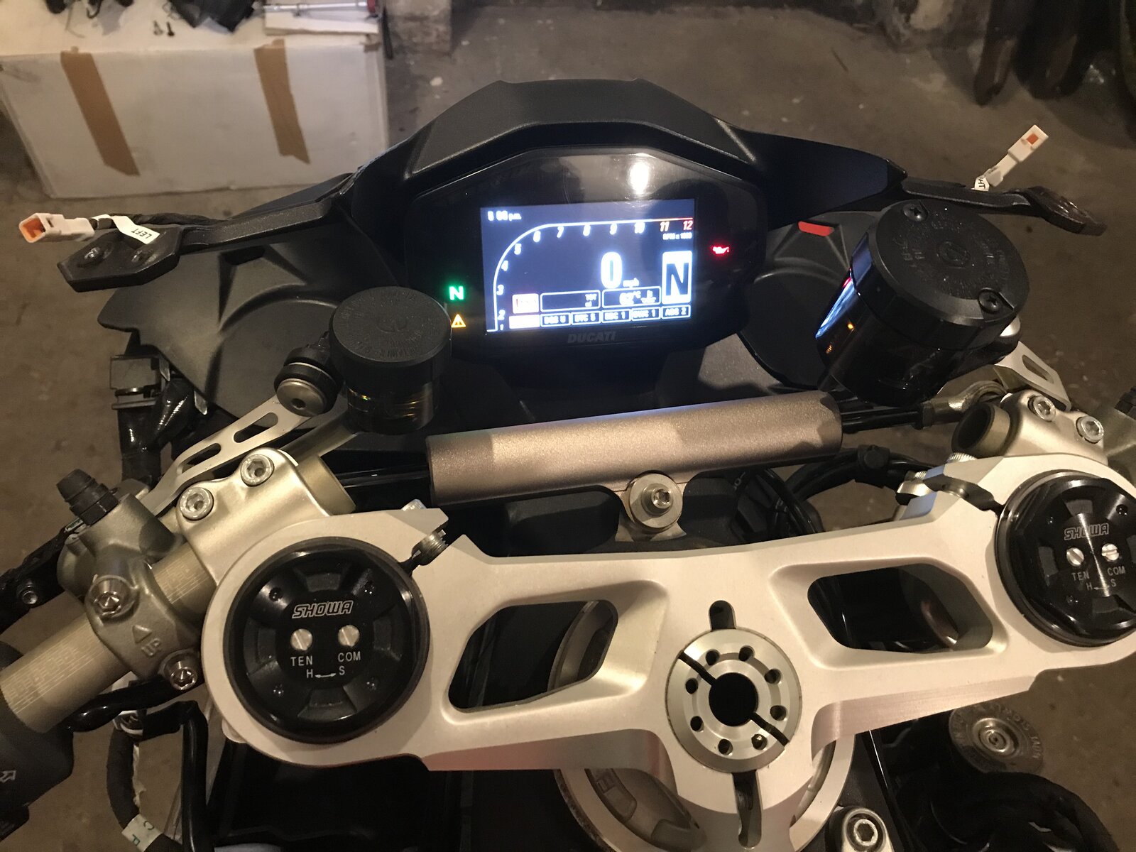

  9. Just to finish this off, the 1299S dash was too complicated to make work on the 959. I’ll start a new thread to let anyone else dumb enough to do this, how I tackled it.

  11. No mate, I did it! :)
    0 error codes and all working just like a 1299.
