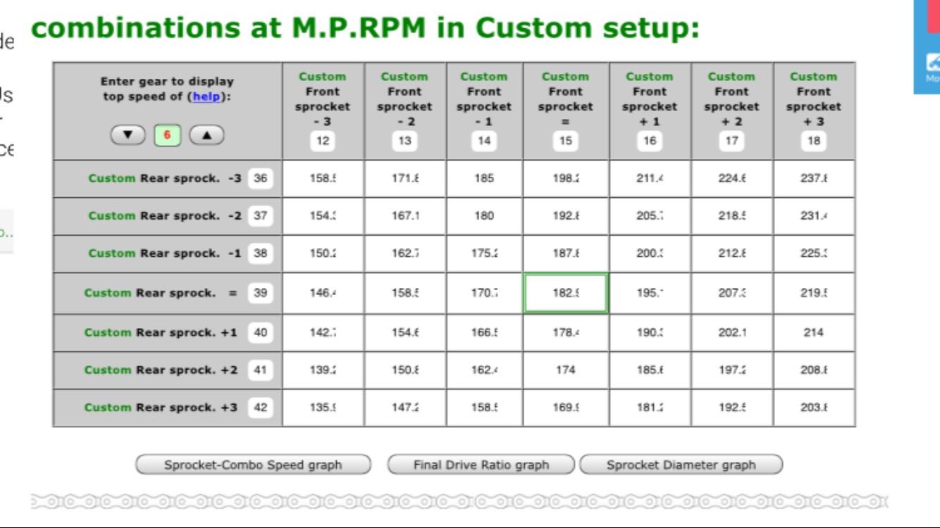

  1. I do admit, I miss the immediacy of the 1098/1198 lump so I'm thinking a sprocket change will give me back some of the old v-twin grunt down low.

  3. That is a massive jump. Knocking 20mph off of the top speed. I know top speed isn't important, but It is an indication of how stark a change it is. Hitting the limiter at just over 160mph is very short gearing....
  4. I thought the same Jolley but isn't the 1199R on a 14/41 combo? Riders of Barnstable recommended this option. I initially just wanted a 15/41 combo ya see. Cheers
  5. I went up to 42t makes it a lot better, its actually civilised at lower speeds
  6. 1199r probably pulls 190 plus standard gearing though so easily manageable
    You would need another chain too, so if you try it then there's no cheap way to go back. May be worth plus2 rear or -1 front first, standard chain, see how that works :)
