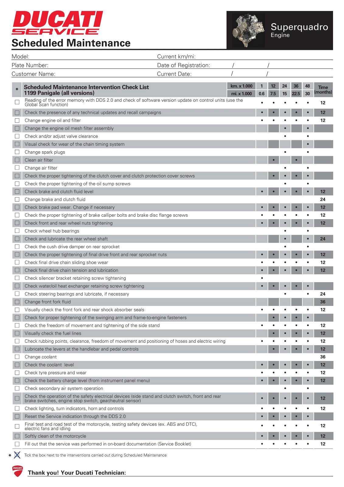

  1. Anyone had the 15k. Service yet ? What does it involve ? Can't find my service book so just quick question as mine it near thanks .
  2. Here up go
  3. Cheers Dave .

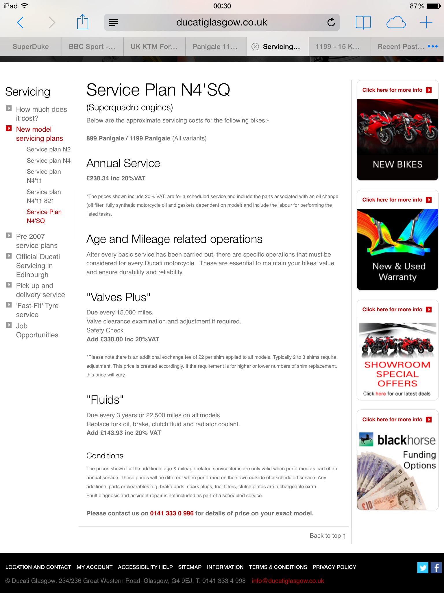

  6. Just taken this from Ducati Glasgow website. Add option 1 plus 2 plus the optional 3 I guess if you're feeling flush. Glasgow's nice this time of year too.
