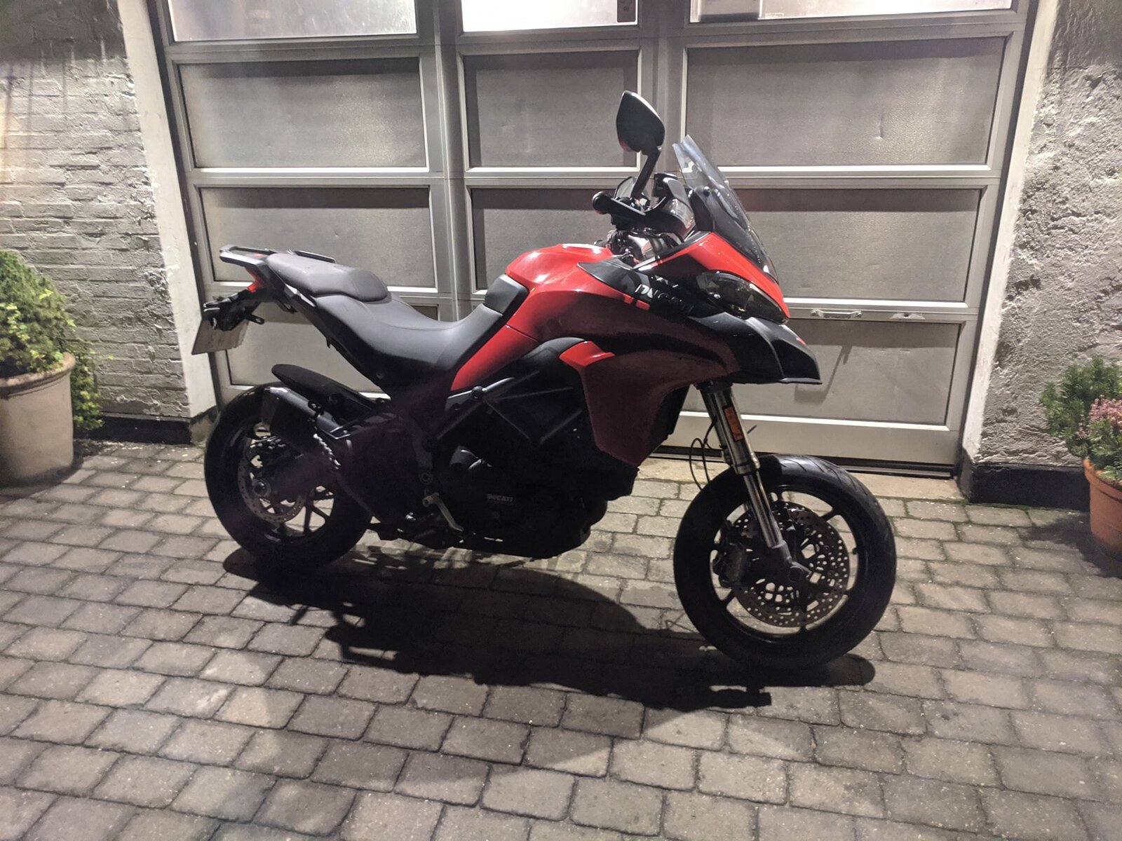

  1. Just wondering if anyone has ever tried a 17” wheel on an Enduro? I’m sure the answer to this would be “don’t buy an Enduro” but the simple fact is I’d never move away from the bigger tank. And I think if I’m honest I’m not going to be doing much off-roading, so a more road-biased set-up would benefit me for more of the time.

  14. Here is a copy paste of his answer
    The bike is definetely more nimble on a 17", almost to the point of being nervous. Turn-in is super crisp, and it also widens your choice of tyres to much sportier models.
    There are two hurdels to overcome though.
    1)You need to find a different mudguard and fabricate a bracket (The one from a 1200 is not a straight fit).
    2)You need to fabricate a custom tone-ring for the ABS, as the change in diameter throws an error.
    Honestly I reverted to the 19"
