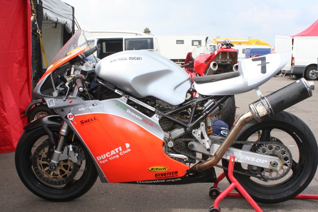

  2. I had a link pipe made and used one of the high level termis I had for my 620, which meant I also had a spare ;) I could never fond one that bolts straight on: IIRC the 620 SS has a different header routing so cant be used with cut/welding.
    Cant remember the place that did mine, was Nottingham way and only cost about £170 (2012 tho).
    Pic to show result to follow...

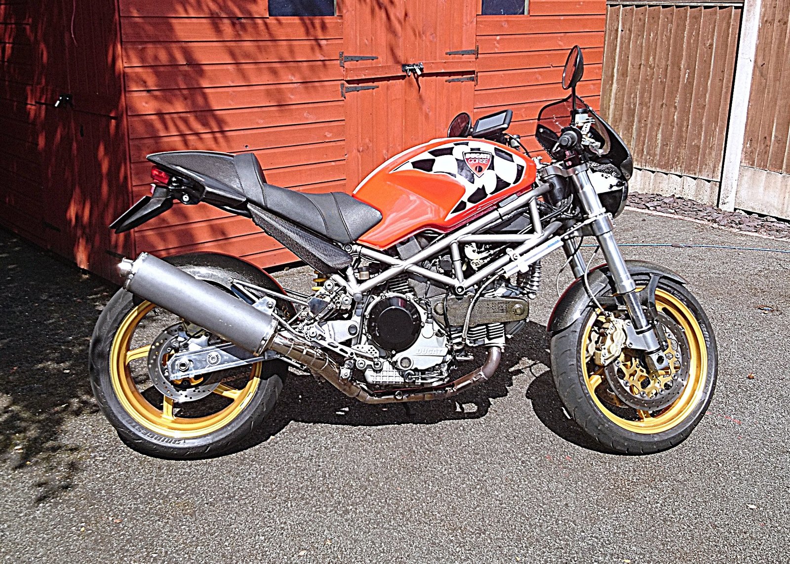

  6. well....you say that...you could bring pipe up under the seat and have single can out there. Looks better on a 620 (pipe clears frame better) but can be done on 620 monster
  7. That a 620?
  8. Nah its a 900ie.
  9. think system is different, when I was looking I couldn't find anything hence had one built. Its only the link pipe really.
    Looks nice btw, although can is a bit 1990's supermono rocket launcher ;)
  10. Yeah the can is a bit long... I have an original Ducati OEM cut down & half finished but it will need a link pipe to get the angle right. I will get there!

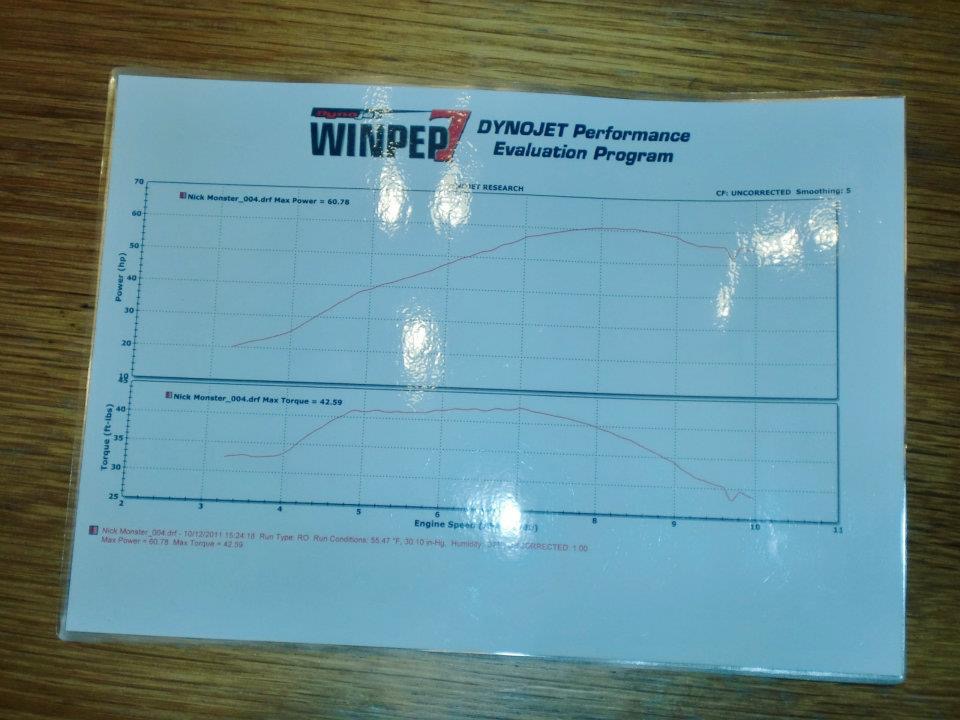

  11. Btw my old 620 had:
    ST4 alli swingarm
    ST2 fully adjustable forks (rebuilt by @PGP )
    916 Showa shock (rebuilt by @PGP )
    PC 111 and custom map with 63hp (think torque about 58lbft can’t remember) and was result of @PGP build of motor (class limit 65 and mine was easily one of the best staying inside the rules ;) )
    998 fairing (I still have the fitting kit actually, if anyone ever wants to do the same)
    Clip ons, make huge difference and iirc I had to change lockstops position but cables etc were all ok
    P4 calipers with full race pads. One disc was enough but after a mate nearly died when his overheated and locked on, I went with twin and accepted the c6kgs of weight (as an aside, on my 600 I had twin disc and at Cadwell mine did seize on and caused me to crash and be knocked unconscious when battling for a win on last lap)
    19x18 radial mc
    Can’t remember the seat unit, think it was a Honda
    Quick enough for 55’s around brands with 110kg rider and road tyres (real road tyres, not supercorsa type rubber)
    Boy I miss racing that thing sometimes

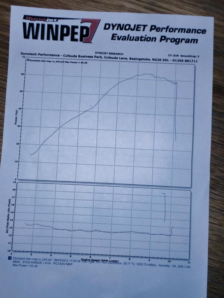

  16. I had them try it with different filters (removing the box) and it made perforce worse, so high lift filter, modded box to get it to fit, made best power :upyeah:
