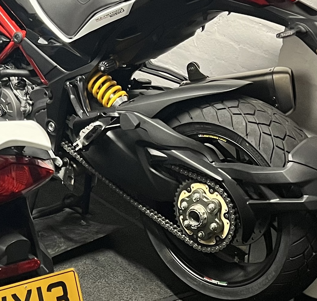

  4. It’s an easy thing to do for most. Ime the chain can also stay same length, just about, but will affect ride height a little if you keep standard chain. Not enough to worry about imo.

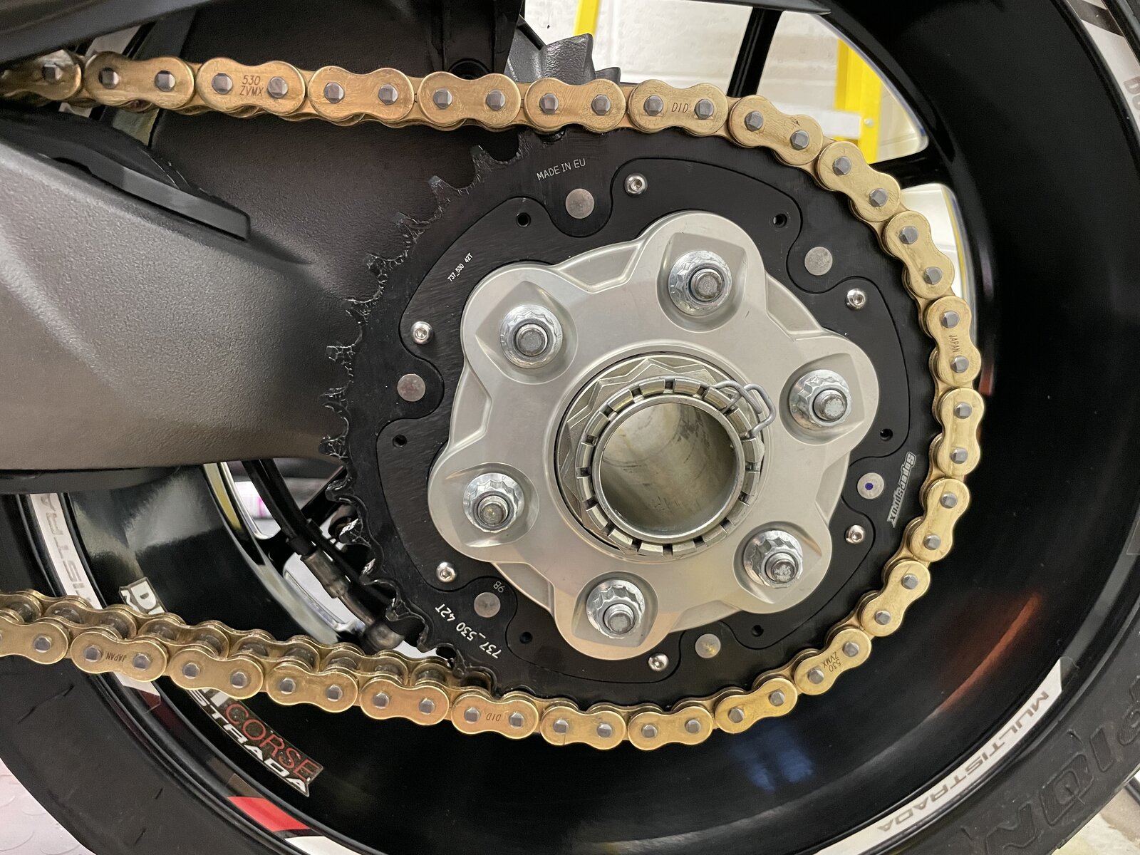

  5. 18CD77B2-C8C4-44B6-BA8C-7A4AA27C2076.jpeg Agreed, 42 is an easy job, hardly changes economy and gives a noticeable extra punch under hard acceleration.
    Supersprox looks by far the best.

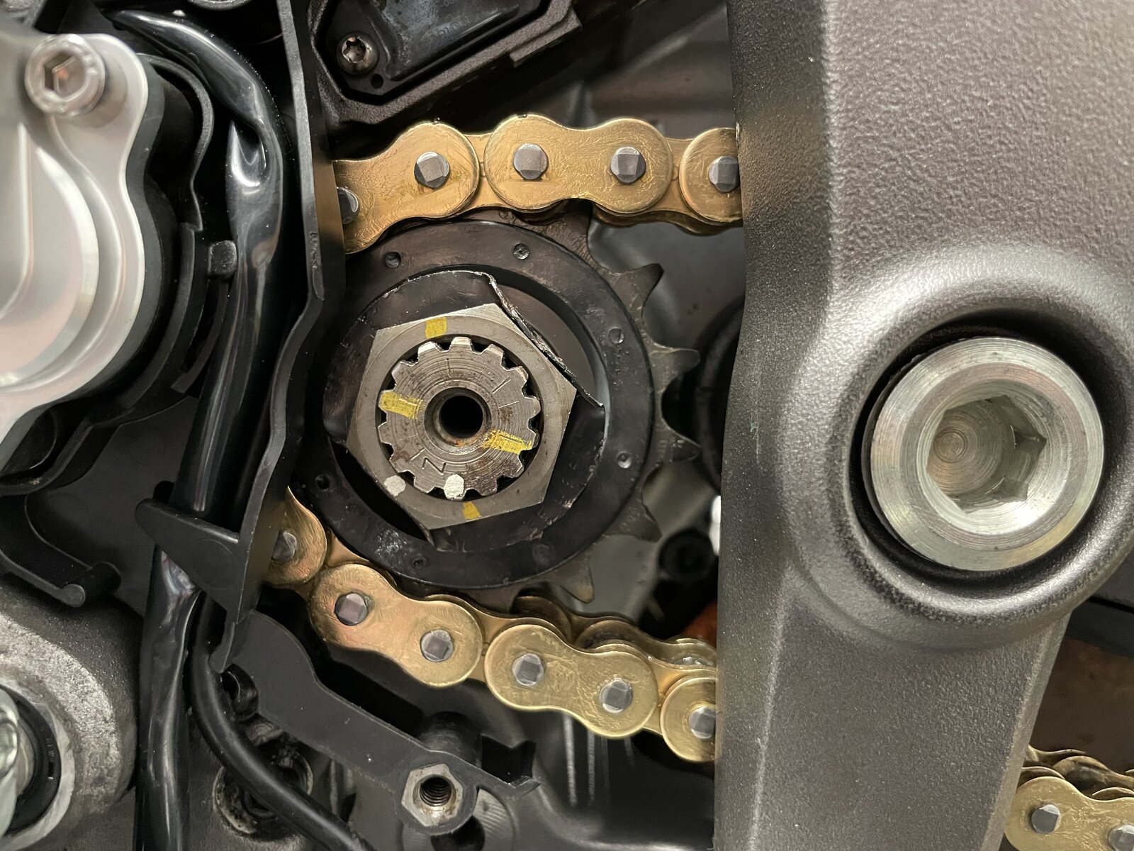

  13. I’m with @steveb123 - without an impact wrench that front sprocket is likely to be a proper pain! The rear isn’t too bad.
    I fitted up a new front sprocket + 42 Supersprox rear + DID VVMZ (116) chain a couple of weeks back by myself. It’s not a hard job overall assuming you have decent tools etc.
    Getting everything off is easy (with an impact wrench).
    The hardest part was re-torquing the front sprocket. I tried with just the rear brake but couldn’t hold it. Had to use first gear and the rear brake - easy enough that way :upyeah:
    The rear nuts can be torqued just with the rear brake engaged.
    The rest is straight forward assuming you have a decent chain tool, a torque wrench that goes up to 230NM, a small hammer / mole grips to unbend & refit the front sprocket locking washer and some thread lock for the rear sprocket retaining / cush drive nuts.
    I’ve done quite a few chains in my time so already had the right tools already.
    As has been mentioned, if you’re buying all the tools to do the job it’s unlikely to be cheaper than getting a bike shop to do it…….but you’ll have the tools for another time of course which is how I’ve always looked at generic tool purchases :cool:

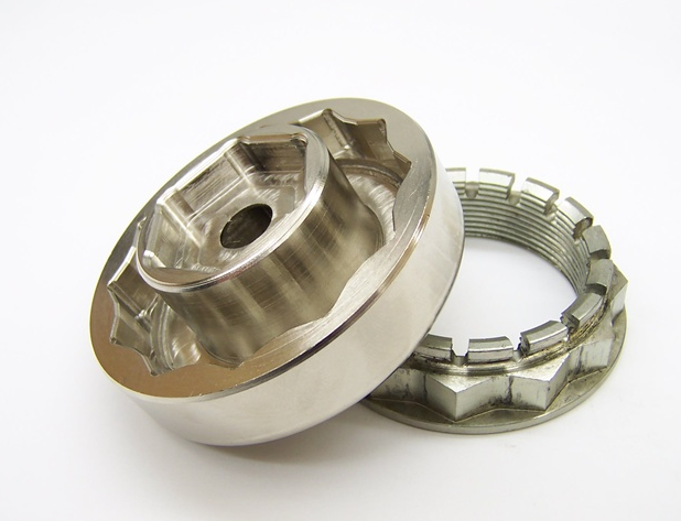

    About the rear socket tool if you don't already have one:
    This info has been posted probably ad-infinitum but worth repeating to avoid searching for it.
    Do get a steel one.
    Moreover, I would suggest one where both sockets sizes are on the same side like this:
    Screenshot 2022-11-05 at 09-14-32 Steel Ducati 1098 1198 SF MTS1200 wheel nut socket.png
    The one I have , although is ok but has the front socket on the backside of the rear socket thus my impact wrench doesn't quite seat all the way into it. It works but could be better.
