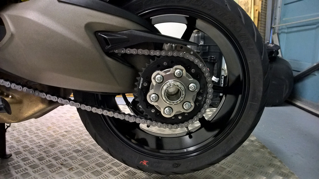

  4. Tobers, any chance of a pic with the sprocket on the bike pls
  5. [​IMG]
