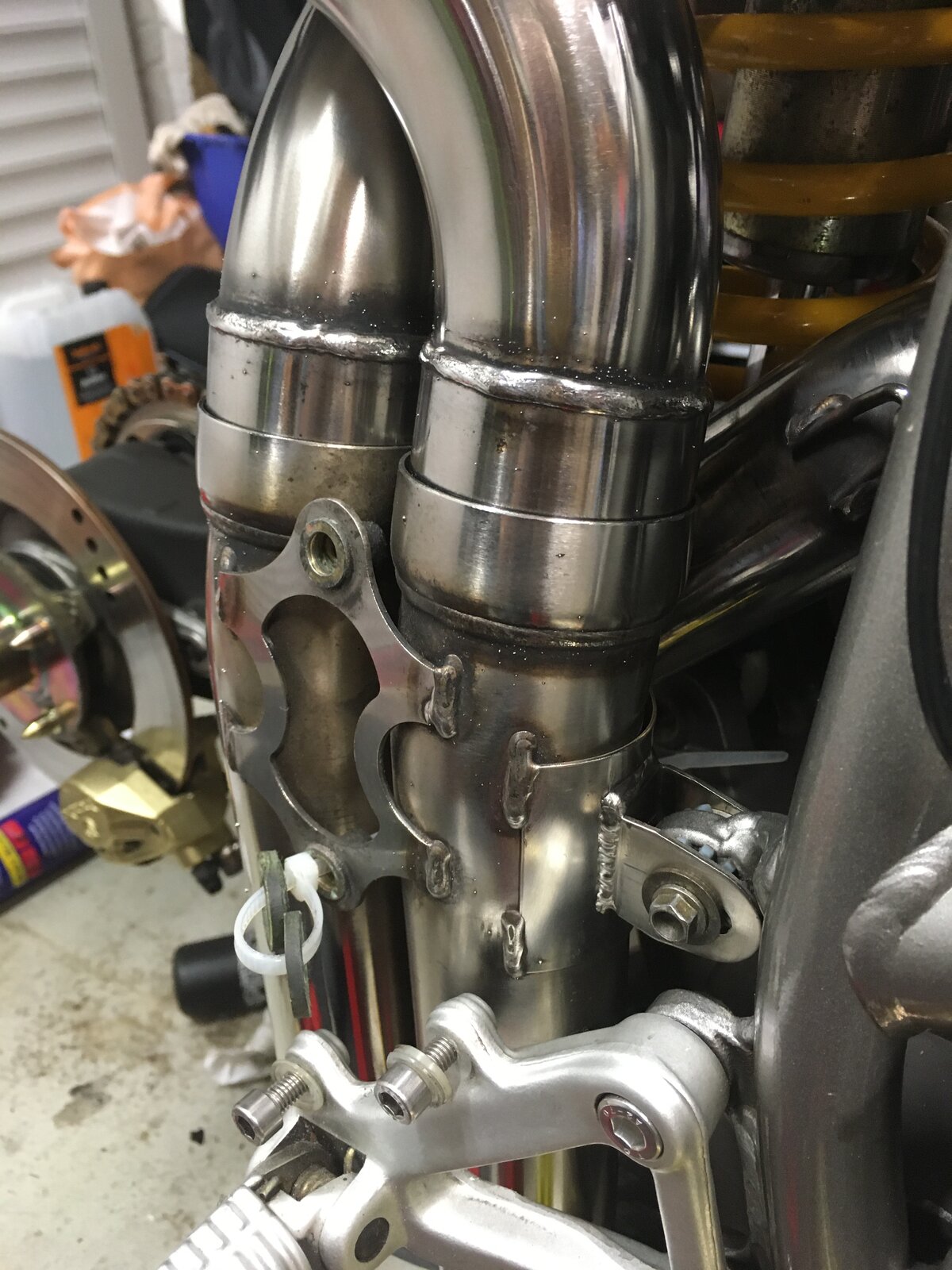

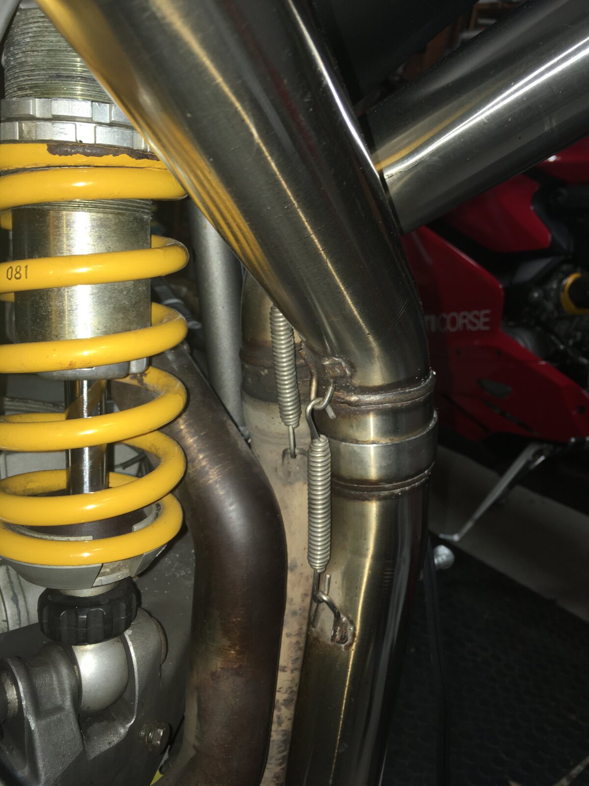

  1. Hi there , I’ve finally got round to working on my 998 now I don’t have to contend with summer in east Asia.
    the 45/50 link pipe I bought which was from a 748r I just can’t seem to fit. I now understand there seem to be 2 types. The length is clearly different from the original 45.
    I assume I have one that one fit my bike or do I just need to spend more time wiggling everything about ?
    thanks for the help.

  5. Every link pipe should fit, if it’s not modified. The diff between a 748 916 996 and a 998 has to do with the heatshield mounting. Looking at the pic the 45-50 seems original and should fit.

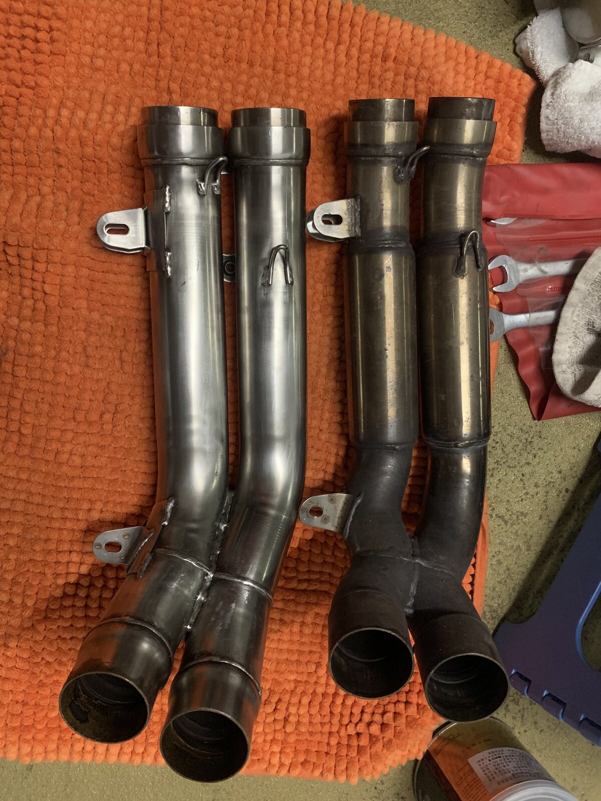

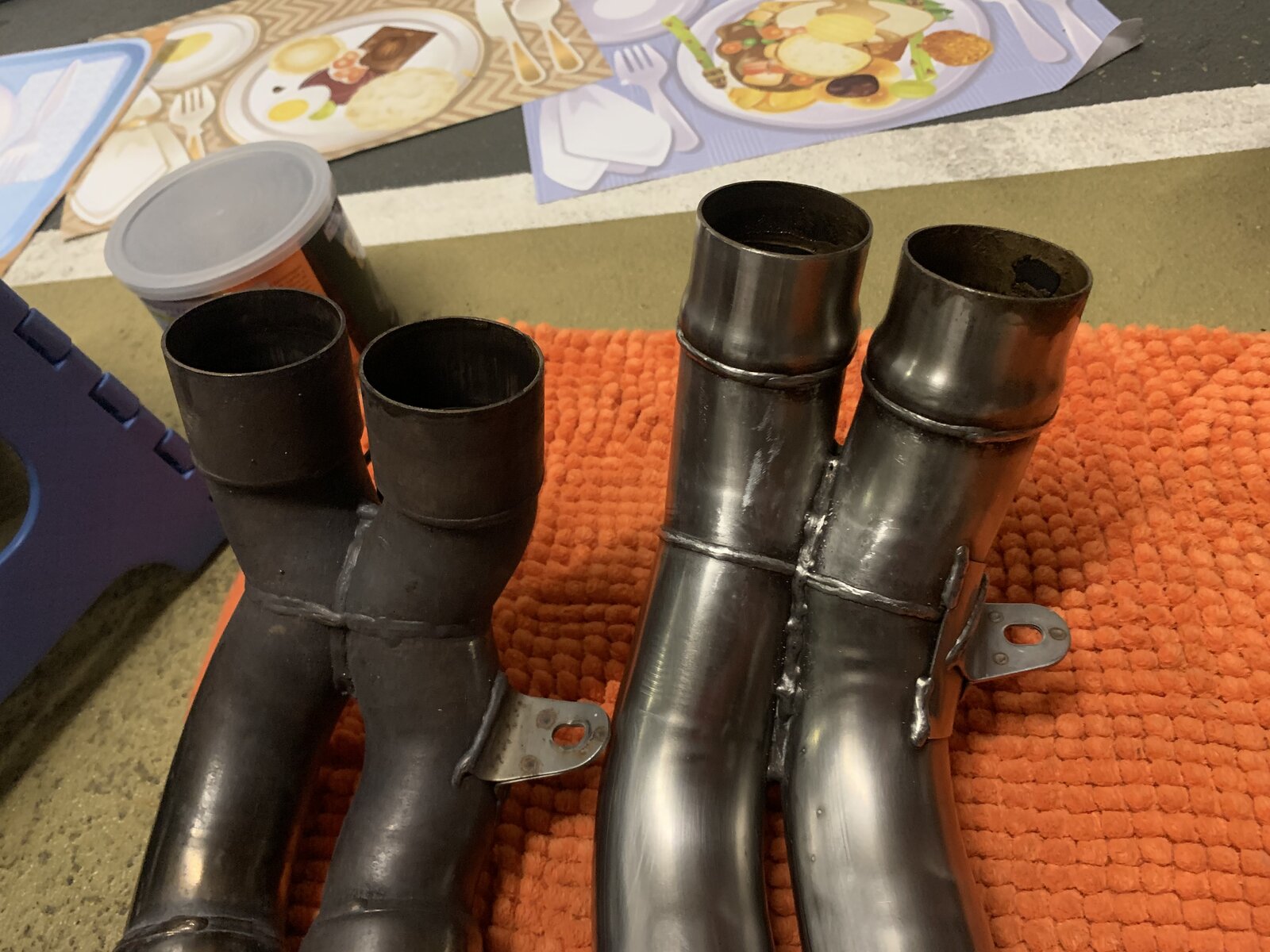

  11. Thanks , even given the length being clearly longer per the photos ?
  12. You need 45/50 ones with the same short length or else they’ll never fit. I’m not convinced the link pipe you bought is off a 748R but I may be wrong.
    Calling @Expat Jack , does that look like a 748R link pipe to you? Is the shorter section longer than usual on the 748R?
  13. E83D96AC-281C-4052-8509-DE0AE1C3F38C.jpeg 49EEF0E1-3B92-4C82-A519-B3A5B4E8F39F.jpeg ACF50134-23BD-484A-8482-F79B0EB690C8.jpeg 748r looks like this:-
  14. I’d say the OPs is as sold from a 748R but it looks like the down pipes on the 998 are longer than those on the non testastretta engines hence the shorter length of link pipe where they join.
