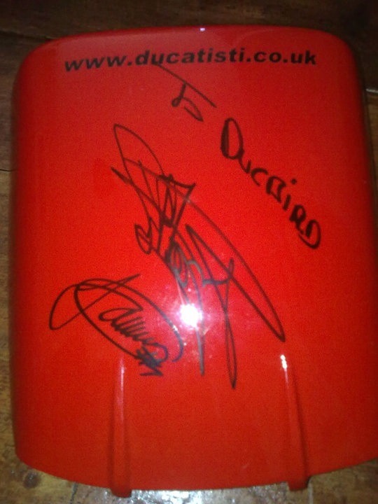

    Forgive me if this is a dumb question, but I note that some have a rear seat cowling, is this removable to accommodate a pillion?
  6. Yes it is removable
    Foggy and whit have signed mine ;-)
  8. It slides onto the seat itself then locks onto the bike

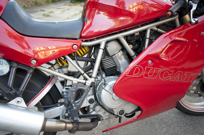

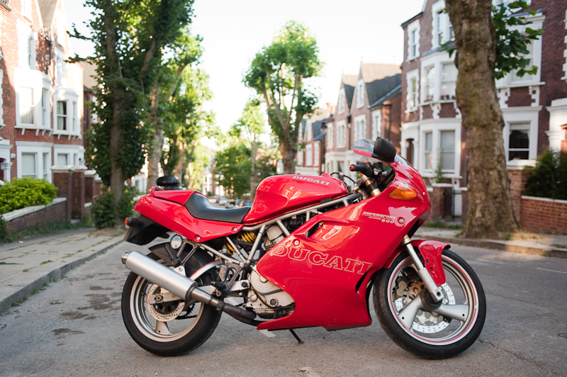

  13. I found this one on Motorcycle Supermarket which looked ideal as it was not too far from me, but I have been unable to make any contact with the seller or even the people at motorcyclesupermarket.com.
    Here are a few pics:
    Looks like it would make a good starting point especially as it going for £800! Not too pristine in case I make a mistake! But presentable enough.
