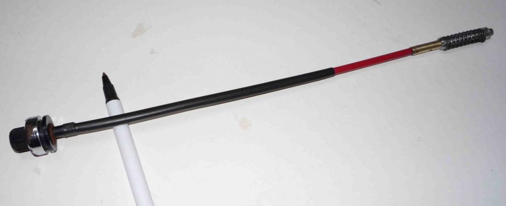

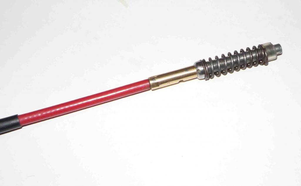

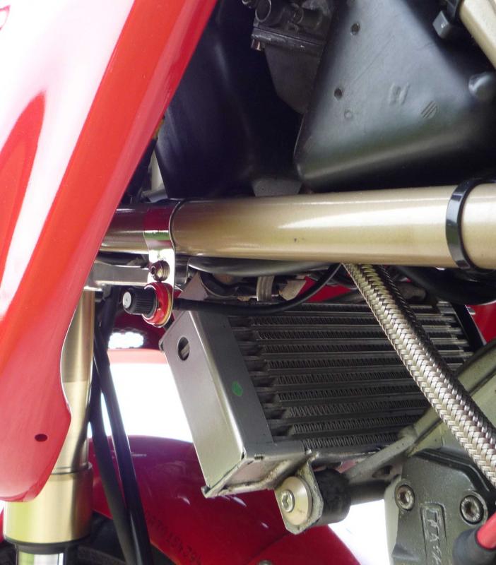

  19. Al - I cant find the pic of that remote idle adjustment cable thinger you made? Such an item would make my life a LOT easier at the mo... :)
  20. Wot? This you mean?
