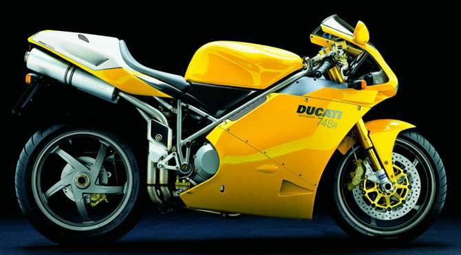

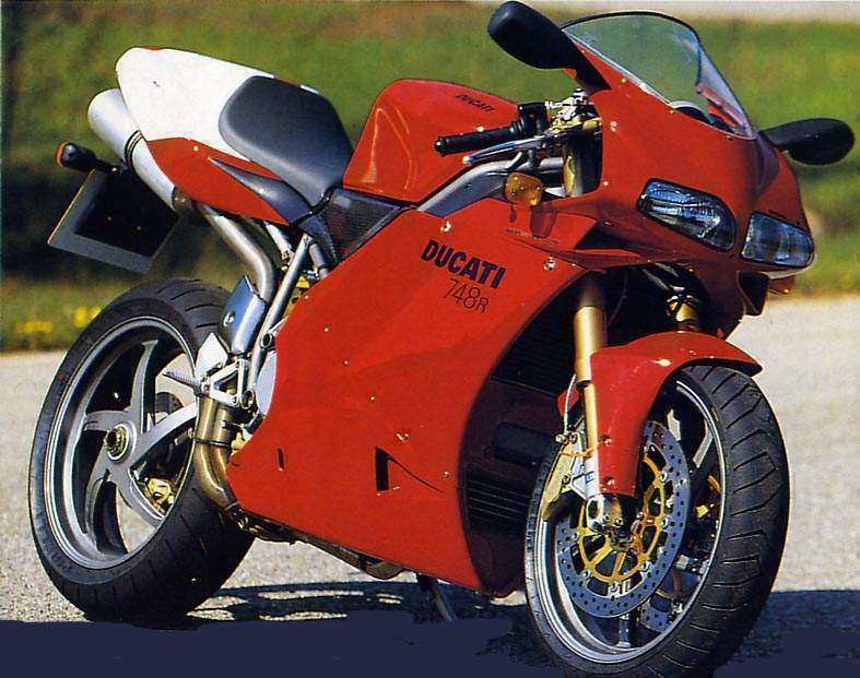

  5. MY02 748R were fitted with two piece unvented fairings similar to the MY02 748S, E and 998 base models although they did have different part numbers, they had no belly pan and had Carbon airboxes fitted. They left the factory mostly like this
    or this
    These are Ducati official photos
    I would recommend downloading the Ducati parts book for that specific model year to get an idea what has been changed from the OEM equipment

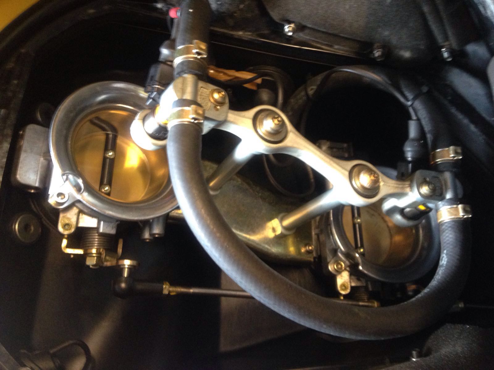

  10. The large injectors were on all models and they can only be fitted if a 748R frame or 998 frame are used or the frame is modified to allow them to fit. It would need to be gone through to see just what is original and what has\may have been replaced on the bike you have in mind.

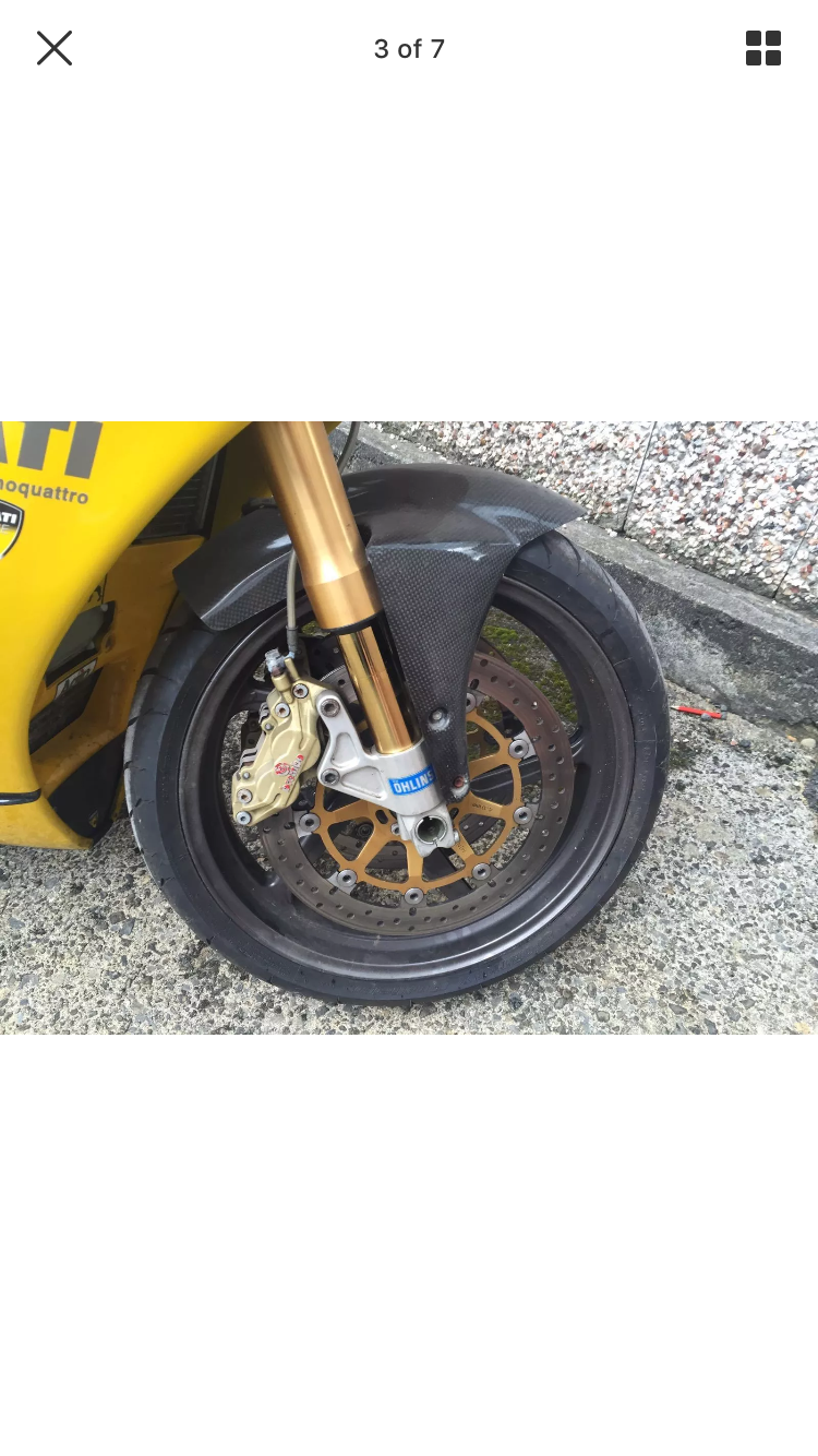

    What front brake calipers does it have? it should have P4\34 front brake calipers which have four individual pads per caliper, early models did not.

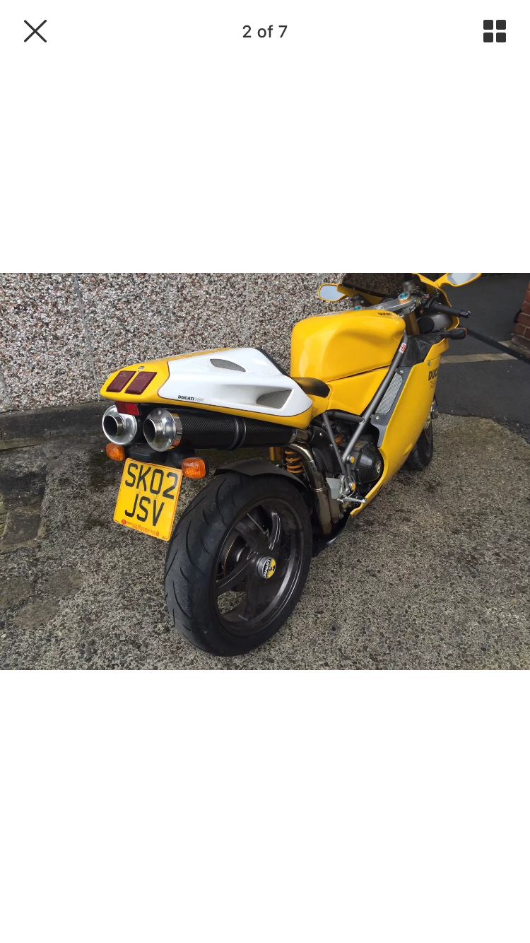

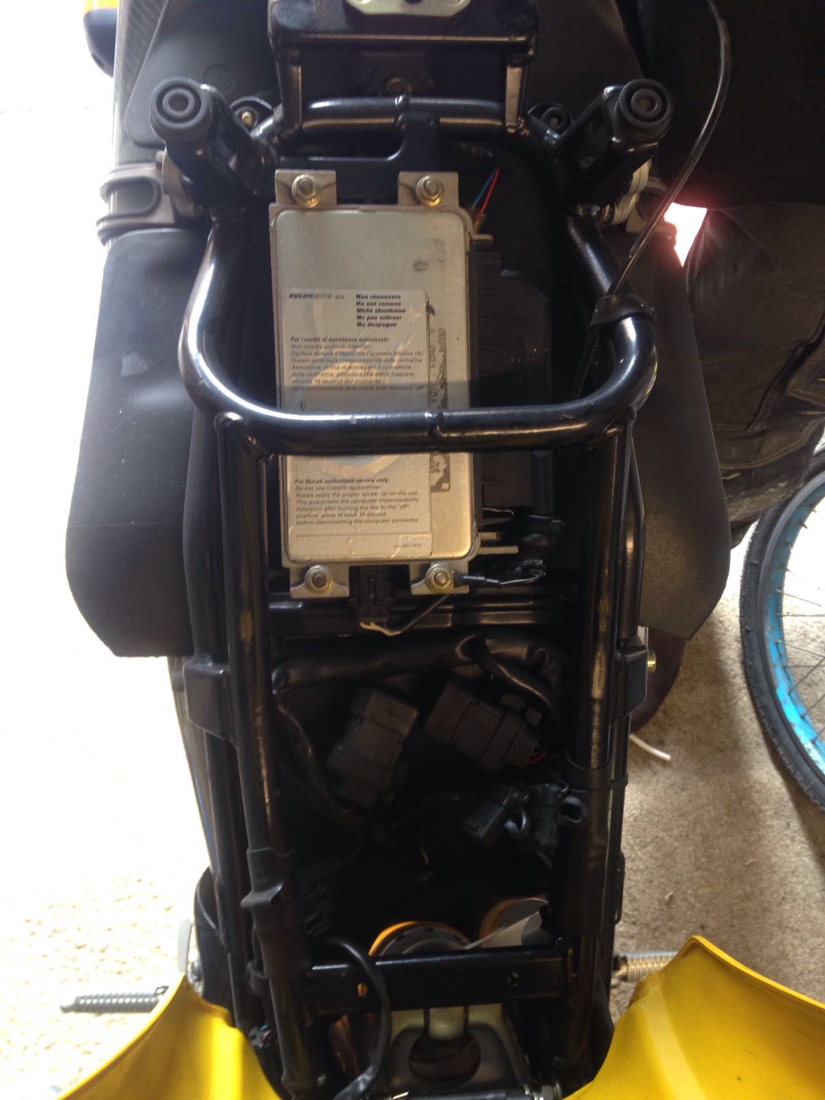

  11. Here are some shots. It all seems to stack up as an R from what I can tell. I'll try get some better pictures, hoping to go see over the weekend and collect next week
  12. Subframe is wrong and most definitely not the one fitted to the R. Caliper doesn't look right either but I need to check mine to be sure. I suspect that this is a bitza restoration using whatever bits came to hand. May well be a genuine frame and engine but a lot of the other bits appear not. Just re read your first post and as a Cat D that is exactly what it is, a bitza from varioys model year parts. If you want a genuine R my advice is to walk away. If you are happy with bike made from bits go for it but don't pay more than £2500 because that's all the bits are worth. Andy
  13. Messer some more details follow. Check the fairing, I would suspect a racing (cheaper equivalent) fairing has been used and an air box from a MY00 bike. Interesting that both have been changed - is there any other evidence of a prang. Bar ends, footrests, levers, fairing stays can show much. As Andy has said below (edit) this is a bitsa that has been repaired by someone on a budget, buyer beware

  14. Here are a couple more. You're bang on about the brake caliper, I thought something was amiss but couldn't put my finger on it until I looked at that beauty of a red one that was on car and classic..
  15. And the price I was expecting to give for it is £3,000 but don't fancy a bista, don't mind a project but not a bitsa.
  16. Clearly there are a lot of wrong parts on this bike for the model year, it looks like it has aftermarket exhausts, the wheels are the wrong colour, as mentioned the subframe is wrong, wrong fairing, the seat is wrong, the brakes are wrong and no doubt with more close up photos there could be other things missing or incorrect.
    As for price that would be up to yourself and what you want to pay.
    Fundamentally though it is still a 748R engined bike which if you don't want originality then it could be worth a look.
    Performance wise it will be better than any stock 748 Biposto and some of those are now going for much more than is being asked for this one. I would weigh it up, possibly make an offer and then go from there. Originality could be restored if you wanted that to happen but would take time and money.
