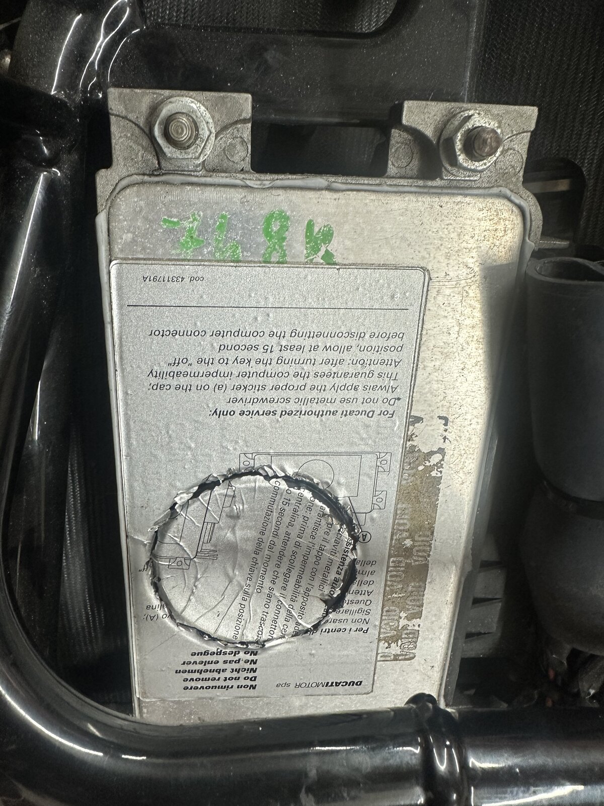

    My 748r is running very rough, Back fires and cuts out…..had a check over from garage and we cannot connect to the ecu…is there a place I can send ecu to for a check over in U.K.?
    I’m based in midlands
  2. Yes I reckon that could be moisture damage - hope not ! It's been chipped or tuned and they've not sealed up the ECU afterwards

  4. Miss fires from cold…..mechanic has done some checks… but because he cannot connect to ecu….thought that might be a good thing to check next
