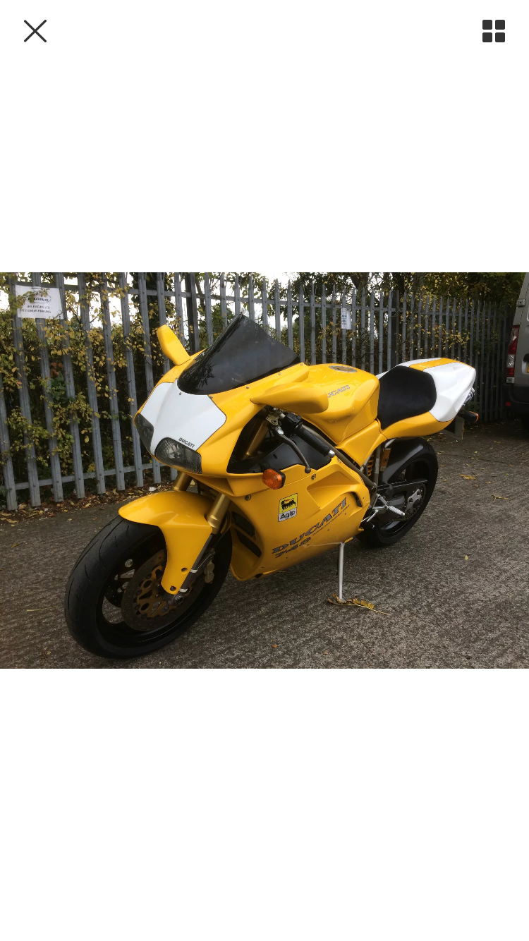

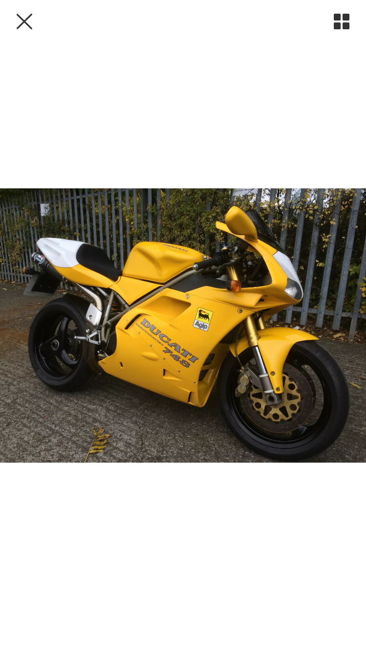

  1. Can anyone identify these forks on this 748sp as they don't look to be correct for the bike
  2. How about a better photo? Those are too far away.

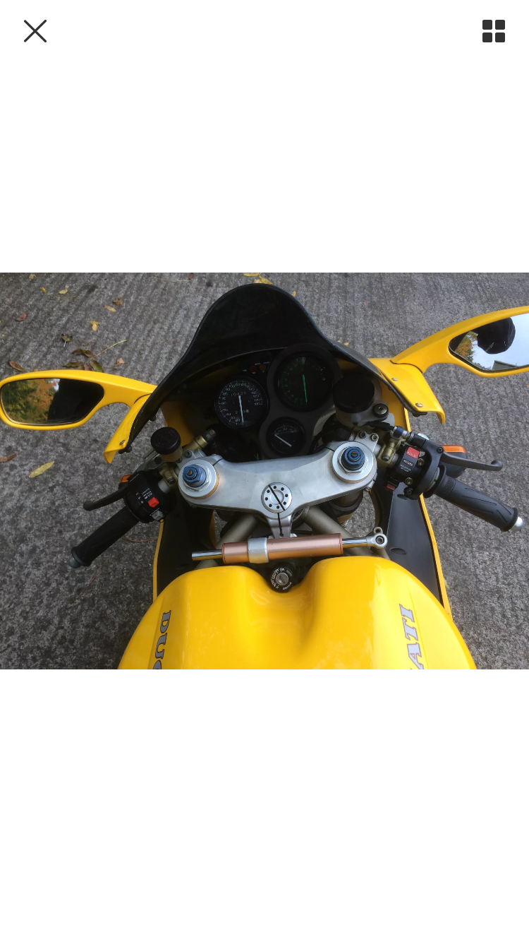

  3. Unfortunately that's all I have available, but you can see the colour is wrong and the adjusters/tops are the wrong colour for an SP
  5. There the right forks just the outer tubes have been anodised and made to look like ohlins.
  6. What about the tops they are different colour too?
  7. They look the right shape but may have been anodised blue.
  8. Ok cheers for responses!
  9. I'd agree with the above, they are also early forks with 45mm brake caliper fittings and early fork bottoms. They have just been made to look more like a later Ohlins set of forks.
