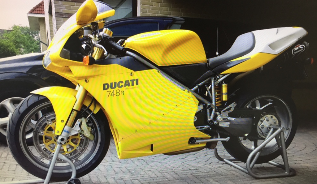

For the SP? For the one in question maybe about 4500? For the R above it looks lovely but as per previous discussions is out of my price range especially so given the weakness of the ££

Quite a bit really, ohlins forks, later calipers, different body panels, marchesini wheels, different injector system, different belts, different pistons and rods I believe and different cases plus probably loads of other stuff
It depends on the year. Earlier models were more like the SP\SPS the later 2002 model had a lot of what has been mentioned above. The engine cases are in fact the same across all the 748 series however the heads are different and can be recognised by the lack of "writing" on the castings as they are totally plain. A ramp style slipper clutch is also fitted on the R which the SP\SPS does not have. Slab sided body panels were only fitted to later models and early R models feature the same bodywork style of the SP\SPS having the side vents. The R does feature the highest lift cams of all the 748 models and runs wider belts with different belt covers. Engine mounting spindles also vary between the models in terms of diameter. Interchangeability between the R and the SP\SPS is quite high and I have a 748R engined 748S, which I built myself and after setting up by CJS is only 1/2 bhp down on the stock R despite having smaller injectors and airbox.
