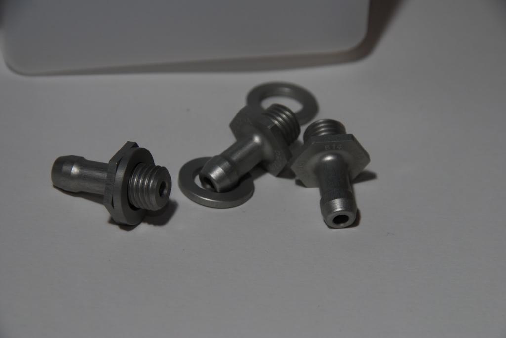

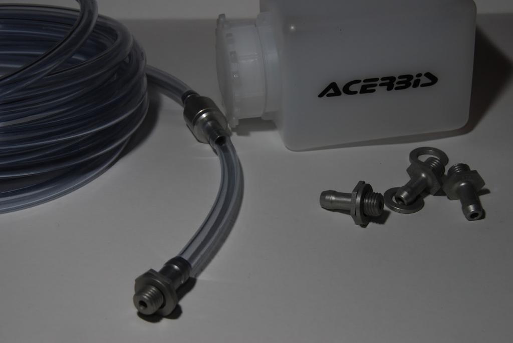

  3. Taken from Jerrys blog site
    I fitted one of the kits a couple of weeks ago

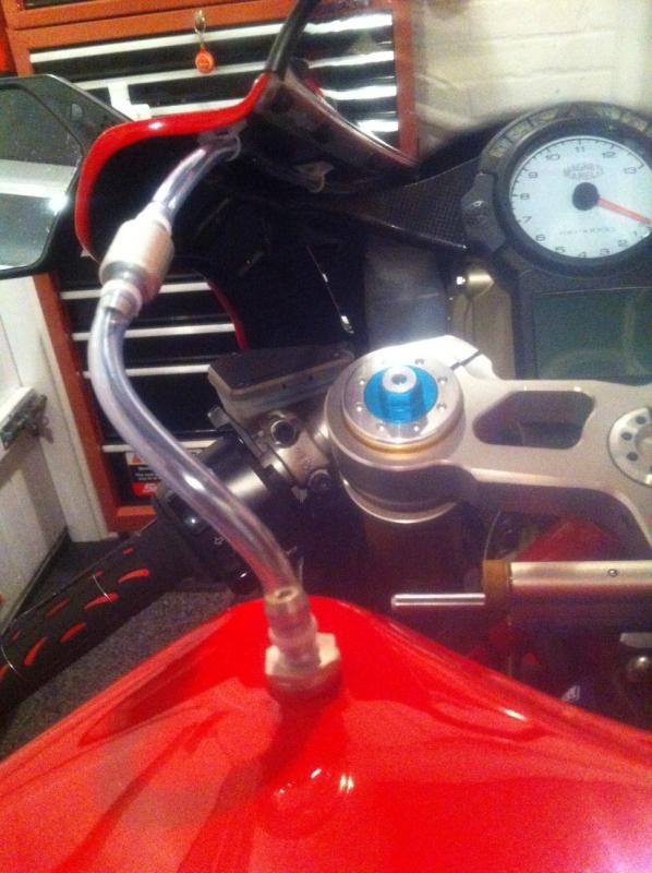

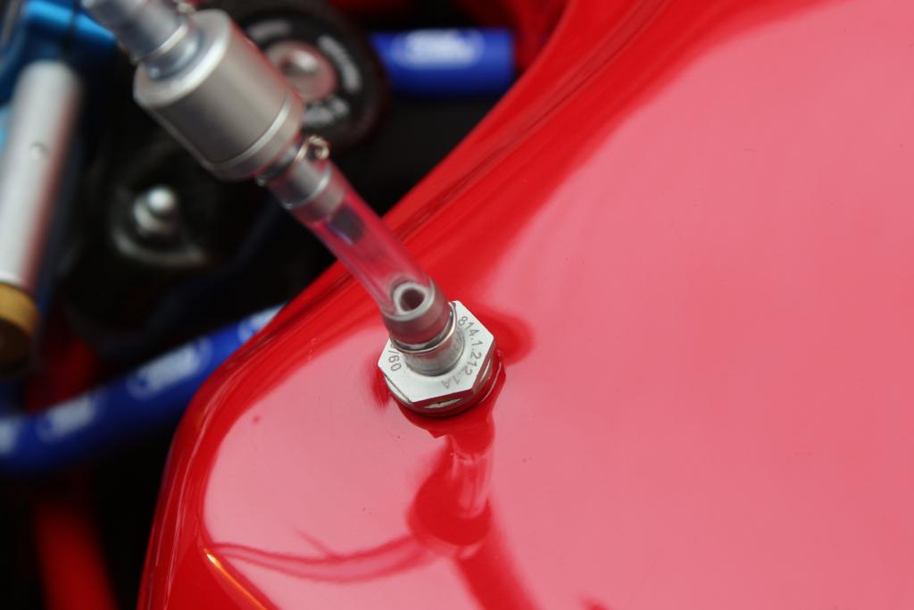

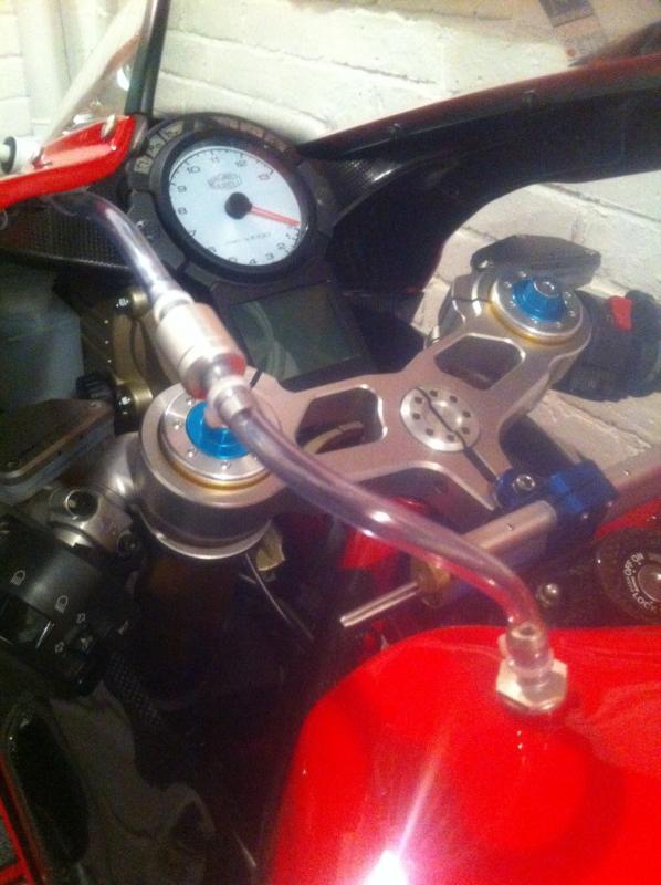

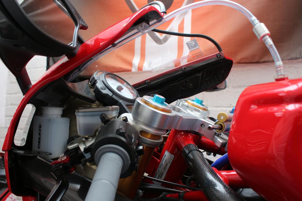

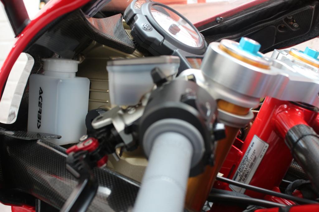

  7. For all the factory part number geeks out there....and those that like looking at nice parts, :wink: I've finally invested in a decent camera so I can get nice quality close up shots! Here are a few better quality pics of the tank breather kit your after and how it fits onto the bike. IMG_0501.jpg IMG_0502.jpg I've mounted the breather bottle (as per Jerry's instructions) alongside the headlamp bucket. All it needs is a couple of Velcro pads on the headlamp bucket to secure it as it nestles quite nicely between the larger race carbon air tubes IMG_0503.jpg The breather pipe is fixed under the fairing with cable tie pads and runs over the top of the carbon fairing support. IMG_0504.jpg
