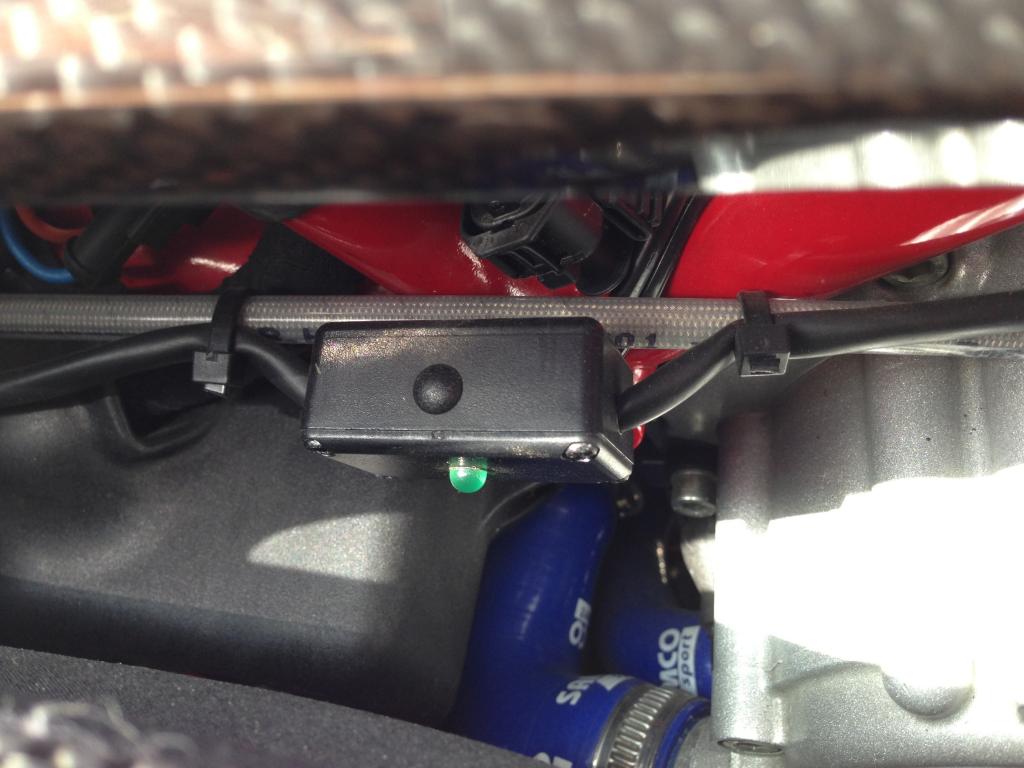

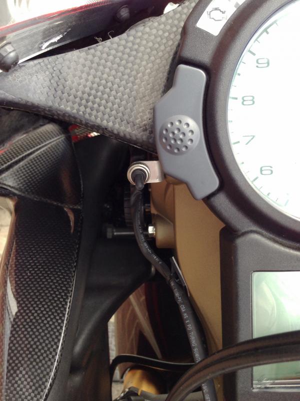

    Not sure what this little switch next to speedo is? It's wire runs down to foot gear change lever and there is a small LED box inside fairing, but it doesn't actually appear to do anything? LED light doesn't come on with switch in either position.
    Apologies for my ignorance, I'm sure the experts on here will know exactly what it is and how to check its working properly. Advice most welcome.
  2. It's the vto button! When u reach 160 it takes off.
  3. It's either an auto-destruct device or a switch for a quick shifter.
    Someone sensible will be along shortly to tell you everything.
  4. Someone has fitted that for whatever reason, definitely not standard fit. Never seen anything like that box before.
  5. switch for a quick shifter....

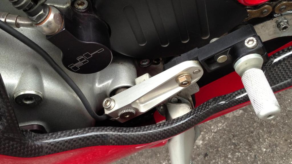

  6. Looks like a Translogic quickshifter, can you tak an image of the gear lever and the linkage if its not running corse style rearsets
  7. Quickshifter it is ;) Wahay!!!! Just had immense fun round the bends on the way back home stamping down & up the gears without using the clutch lever.
