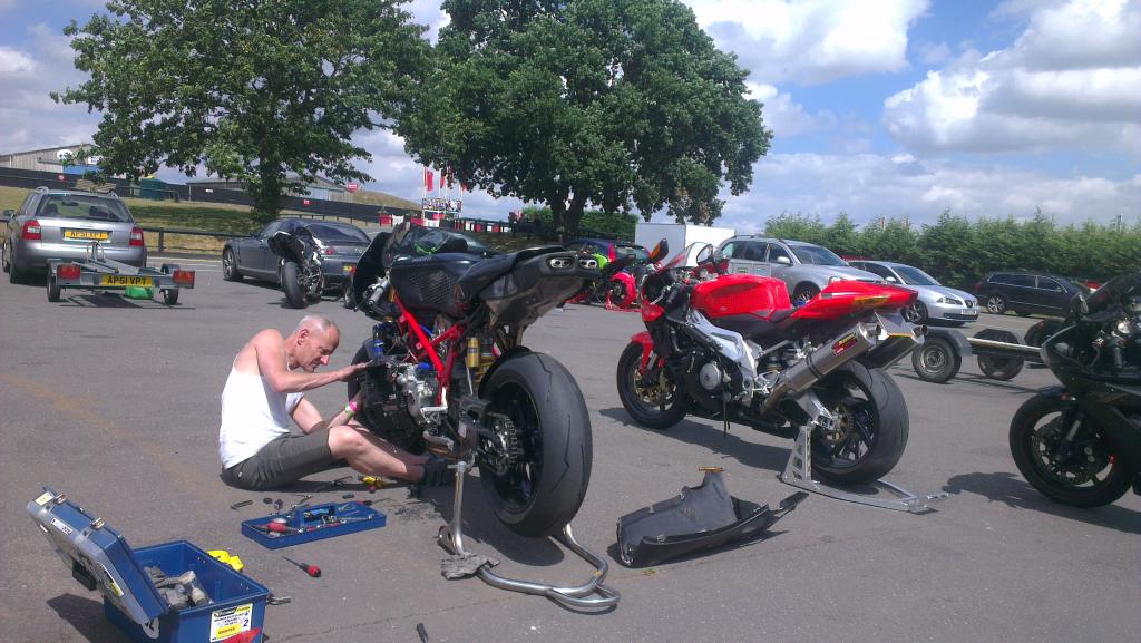

  1. Second session at a beautifully sunny Snetterton yesterday - third lap, engine started running mega rough with no power.
    In the pits: rear cylinder exhaust pipe was completely cold and orange engine light was on.
    Checked sparks: OK
    Checked injectors: rear not OK.
    Over the course of the next couple of hours: checked all fuses, pulled off battery box and wiggled wires to ECU, injectors, PC111 and basically everything. Still only ran on front cylinder with the orange light on.
    RH fan was running at one point even though the engine wasn't hot.
    Decided to call it a day and start packing up.
    After another hour or so, hit the starter and it fired up just fine, no orange light. Thought to myself - hey, I can get out on track again. Let it warm up for a while just to check and when it got to 78-80degC: tons of nasty smoke from the exhaust! Let it cool for a b it, tried again and then at the same temperature the smoke started again.
    Gave up.
    Bike now at MD Racing for investigation.
    Initial thoughts when I dropped it off and without checking fault codes etc are maybe a head gasket (based on smoke symptoms) but not sure about why the engine light was on and not running on rear cylinder.
    Fun way to spend a sunny Sunday, 6 hours travel and £129 trackday fee! :rolleyes:
