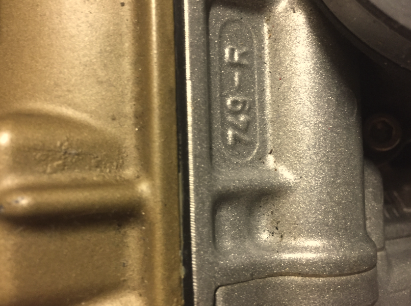

    This is what mine looks like:
  8. Mag covers, and carbon belt covers on mine.
    That looks a bit like it has neither.
  9. I think Airduck and Sev are right looks like it has neither and I would put a pic of the 749R stamp in the ad
  10. My old 749r also had mag head covers and cf belt covers
  11. The one on eBay is a shallow sump. 749R has deep sump
    • Useful Useful x 2
  12. Doh....obvious now you’ve said it....it was staring us all in the face and we didn’t notice!
    Thanks.
