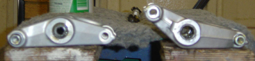

  5. @Sev Shock is different as well - shorter stroke, stiffer spring.
  6. the rocker is different as well...more linear..

  8. 749r rocker (left) versus 999r rocker

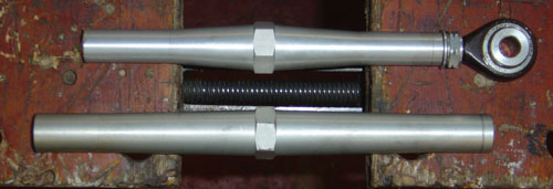

  9. 749R rod (top) versus 999r rod

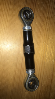

  12. Ive got this..goes from 130 up to 160 eye to eye.
  13. Just looked on my data sheet - length between rod end centres is 243mm.
    (Note that it has been at this length for 8 years and is perfect for me.)
  14. Cheers, I think I’m sorted for the measuring job now! Ta.
  15. no
  16. Yes.. pm me an email address and ill send you what i have...

  17. Got my “standard” 749/999(R) rod off @Nelson (ta!) today and immediately went tinkering in the garage.
    I reckon that I can cut it down a bit and still maintain the 243mm centres distance I have been using on my 749R.
    The threads are deep enough to ensure at least the same engagement as I have had with the R rod since with my 243mm centre length the rod ends protrude quite a lot with the short R rod.
    Time to come clean: I replaced the rod ends on my bike last week as they were getting a bit scuzzy. I replaced them with some from McGill Motorsport however the wait for the standard L/H thread Ducati alloy locknut was about 6 months.
    I ordered some steel locknuts from McGill (5 quid for 5). Unfortunately....I may have nipped one up a bit much and think I may have cracked the R rod! There is a teeny longitudinal mark about 2mm long at the edge of the rod on the outside. I cleaned it up with a fine file and emery and it disappeared. It was probably there all along but for peace of mind, I thought I’d rather replace the rod rather than have my suspension collapse on track.
    I will get the R rod NDT inspected at work to check sometime but in the meantime I will use the “cooking” standard rod.
