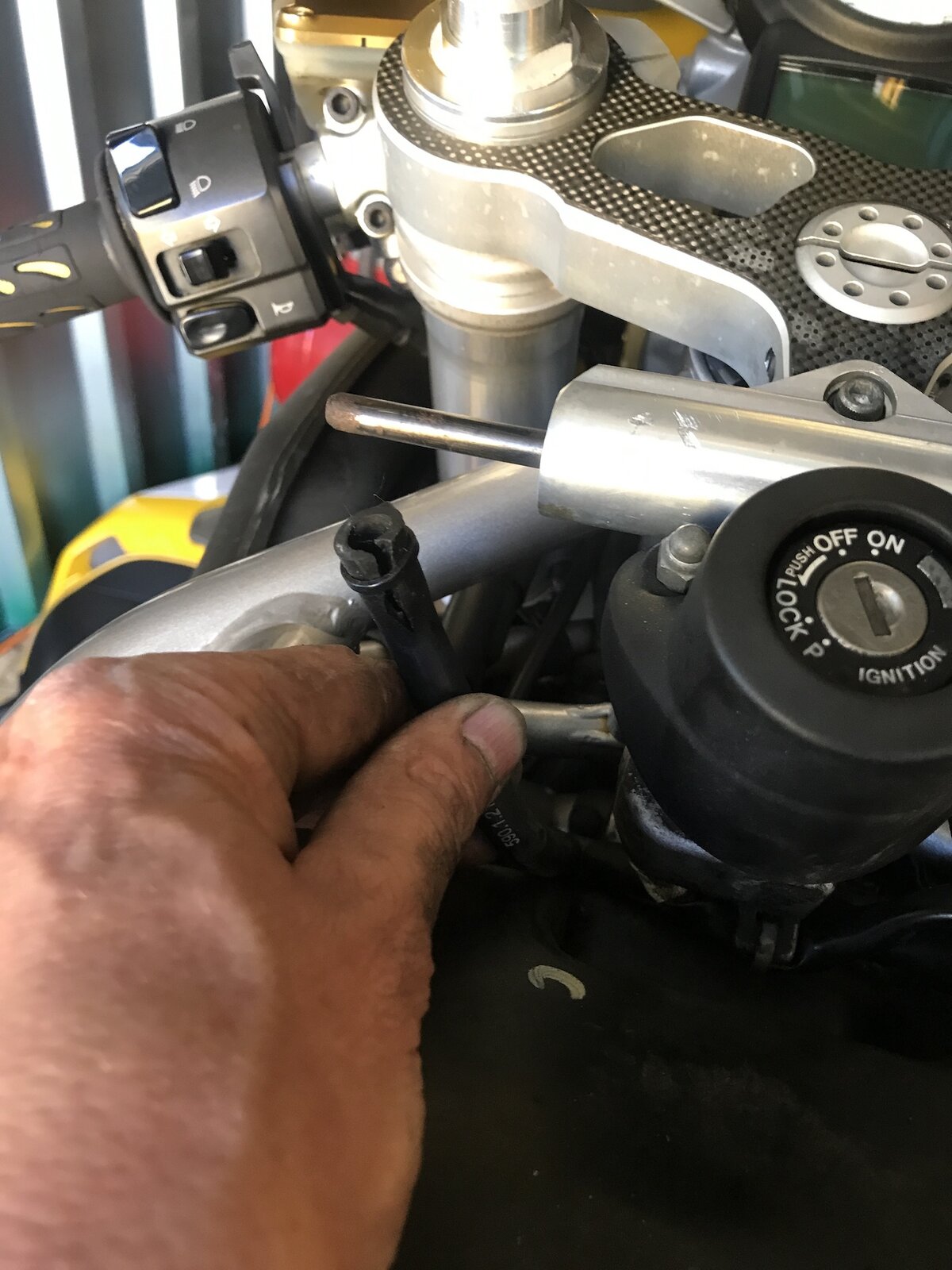

  5. nice one Chris, will look at that,will try and locate the coils. IMG_1196.JPG just found this split in the tank breather too

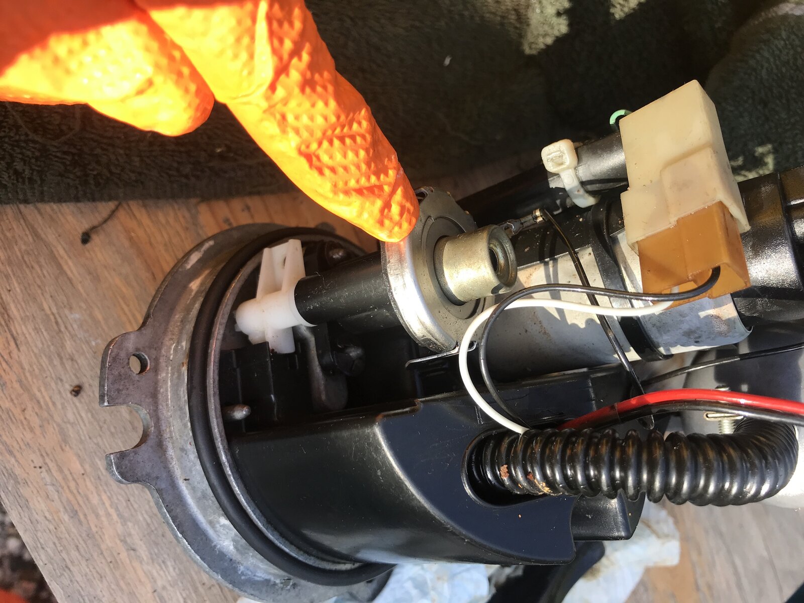

    took the tank off and despite the service notes saying it had been treated for rust it was FULL of shite, literally a sluice of rust swirling around, first fuel taken off was opaque coloiur with rust particles, not see through.
    cleaned the tank out best i can.
    noticed that the cap was popped off the top of this Also the wire was disconnected from Pic 3
    and that the wire was disconnected from pic 2
    pic 1 shows that part loose as the retaining rings were swilling around in the tank (pictures at the side of the part)
    so whatever that spring caop part is,it was bobbing around with the top half off.
    large O ring was damaged and glued back at a break, got a new one coming and a new fuel filter just in case IMG_1202.JPG
    also to note water on the rear cyclinder coil, wet on the plug. IMG_1199.JPG
  11. that 'spring part' i think is called a Thermistor, does anyone know what those thin retaining discs are called? I managed to push one back over the two pins that the thermistor sits on but could do with a second one to secure it properly
  12. it's a fuel pressure regulator Skyhook, they are simple and reliable generally, although i've never tested one for accuracy/consistency myself. I wouldn't rule out the coils immediately as could be intermittent. If you find that one cylinder is breaking down/not firing with regularity then you can swap coils to maybe confirm this, although both second-hand coils misbehaving cannot be ruled out 100%!
    It's safer to replace the submerged fuel hoses while you are working on the tank contents, as splits and bulges to the pipes are common particularly after time, and will cause fuel pressure loss and inconsistency which can result in rough running/might only just about idle and will have an inability to get engine to rev to higher rpm.
