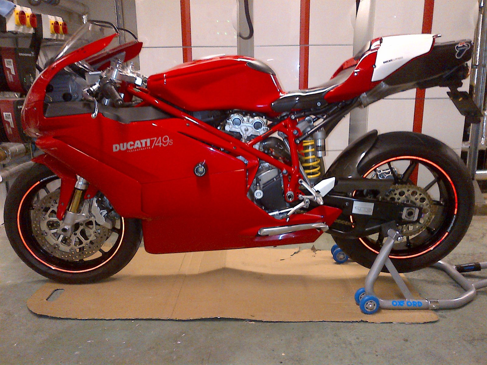

  18. just so that you can see the diff with the ser 2 :Happy: ( with Bi and Mono P )
    ( i might be a bit biased , but i also think it is the nicest Duc apart from the Pani )
