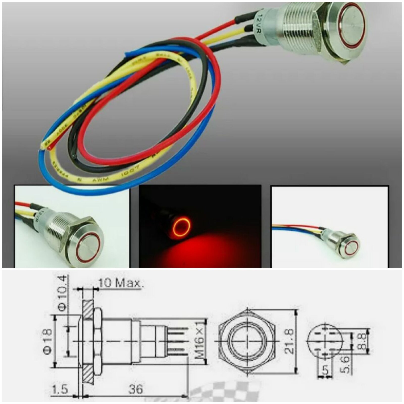

Hi folks My ecu shorted a while back on my second gen 749s, so rather than one fan staying on, I'm going to put them on a manual switch, they are currently disconnected. The bike is running like a champ, so rather than buy a new costly ECU this is a better option I think. My mech guy will wire switch into air duct on right/ left fairing - nowhere else to put it. See attached pic, this switch will do the job? 9 quid on ebay, uk seller . DC-12v STAINLESS STEEL PUSH BUTTON SWITCH Self lock ~ ON-OFF Button Push switch button in = on push button again to release = off This is a very high quality stainless steel push button switch with a neat ring led display and made to a high standard and not cheap looking Switch you see advertised. 20cm of wire already attached allowing easy fitment. Specifications: Type: Self locking Colour: Red Led (ring light) Voltage: 12vDC Amp: 6A Terminals: x4 Approx. 20cm of wire Switch hole diameter: 16mm Switch size: See diagram Made of stainless steel material, strong and durable. Rubber ring and hexagonal nut included, anti dust and waterproof, which make it great for outdoors use. Copper plating silver terminals for good conductive properties. Self locking, push in = on, release = off. Metal button head durable for longstanding press.

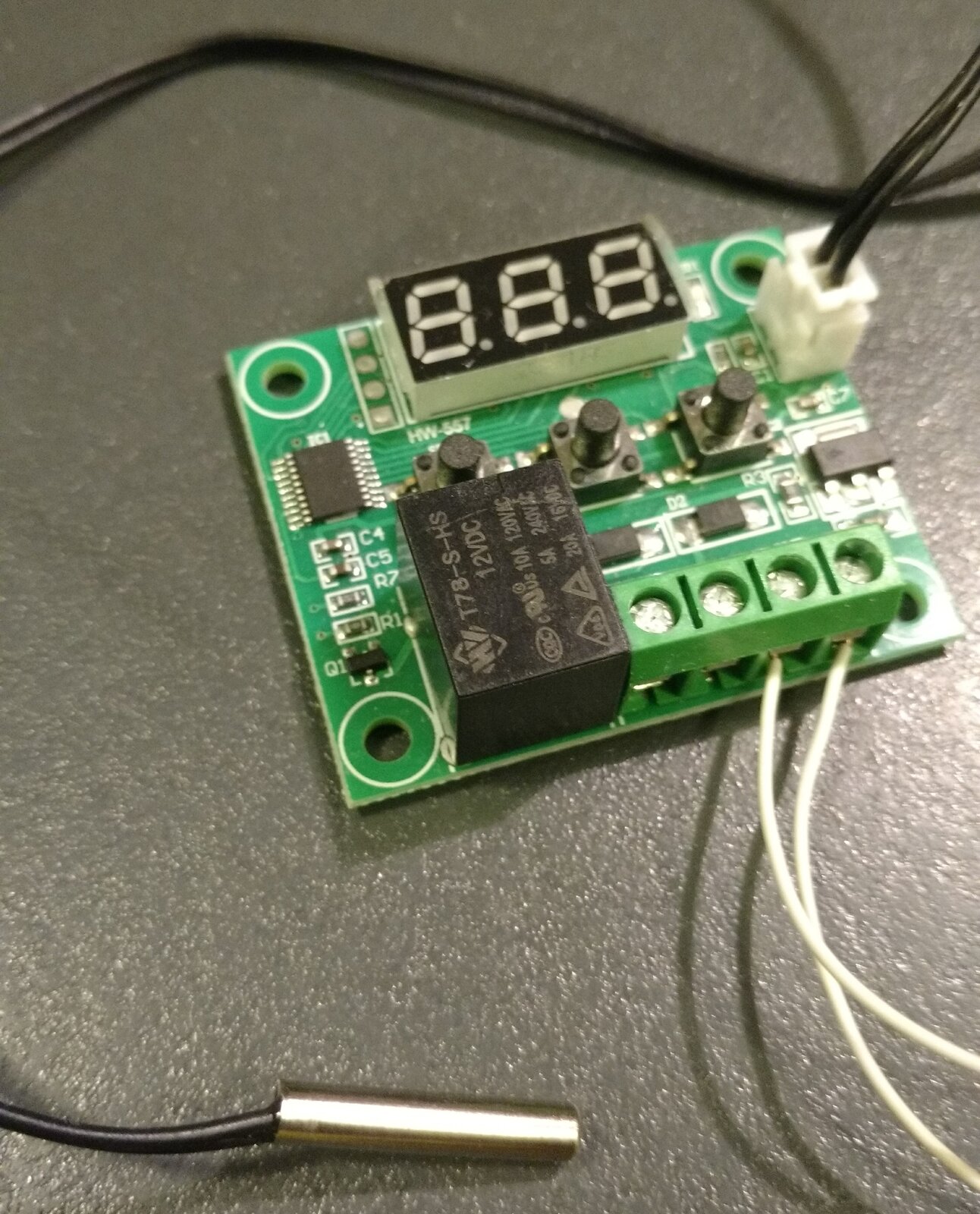

There are also little gems like this for about £5. Operates at 12V and settable as you like, with onboard switching of about 10A DC. Look for 'HW-557' (typo ammended)

Looks like I didn't upload the image the first time... Doh! Sorry - typo error - should have been HW-557 as per the image above. I have a PDF 'manual' too but I'm having trouble uploading here on my phone. The manual should pop up when you search, but if you can't find it drop me a PM and I'll email it.
