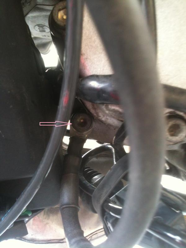

  17. Quite a few of us have had starting issues with our 749/999 bikes. Symptoms have included bike cranks over but does not start. After going through the elimination process (ie changing relays etc), it was found that by running an earthing lead from the -ve terminal of the battery to the starter motor bolt towards the centre of the engine (there are 3 but only one of the bolts is visible) the bike would start like a good 'un. 1st time every time.
