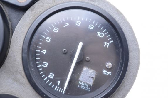

    I have tried to connect a 2000-2002 750SS tacho it shows the double RPM so it does not work either, see Tacho.jpg.
