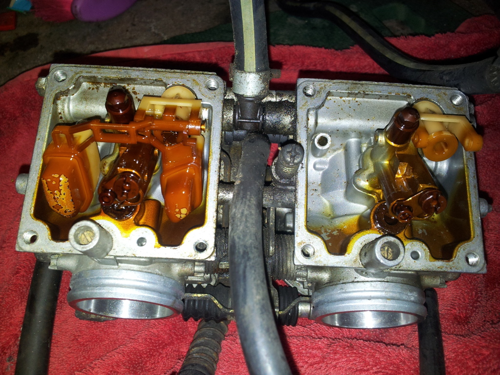

  14. lol....600ss engine wise I will stick with 750 and convert it to dry,im thinking of twin pluging is also,i have stripped the carbs tonight carbs.jpg
    they are in a right state,the needles were glued into the emulsion tubes!!!!
