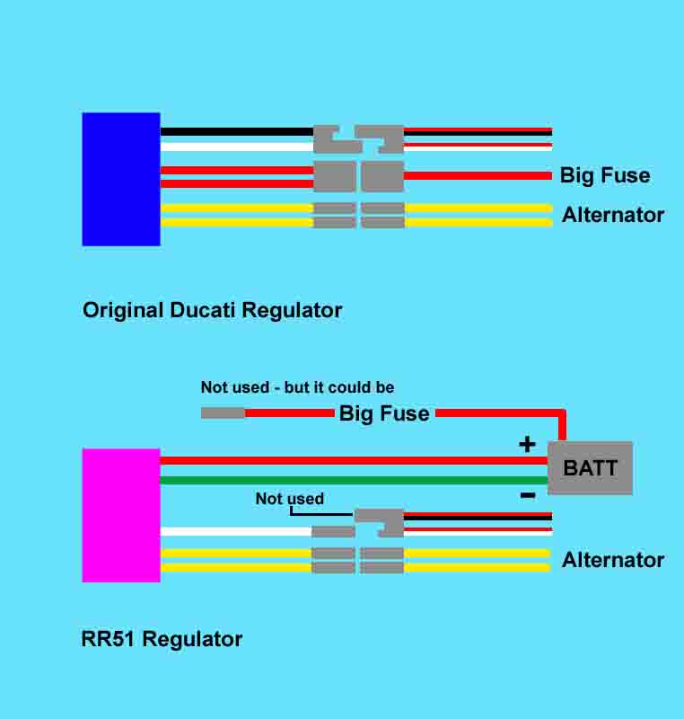

  2. If you have a new reg/rec, have you wired it up correctly?
    See below.........a lot of mistakes are made with the white wires, which need to be connected to make that light function.
    Check your indicators all round.........double speed on one side usually means a bulb has failed or isn't making proper contact..........or, it could be that one bulb is a much lower wattage than the other three.

  5. The SS has a 'Not Charging' light whether it is an early version SS or a later one......
    If the OP has fitted an RR51 reg/rec, it has the Not Charging wiring.
    I did do it myself because the Electrex wiring instructions are sh*te.............many people have had issues with the defunct and used wiring...........I had to ask questions when I first got my SS, because it had an RR51 reg/rec which wasn't wired correctly, so I thought I would save others the trouble of having to research it or bugger up their reg/rec.

  8. Well.......the two yellow are obvious.
    I suspect one of those blacks should make that light work.
    Are any of all the wires thicker than the others?
    Try checking against the diagram above (of the OEM version, in which the red/black is 'live', but I can't recall if that is 'always' or only when the ignition is switched on).
