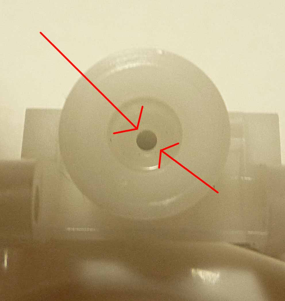

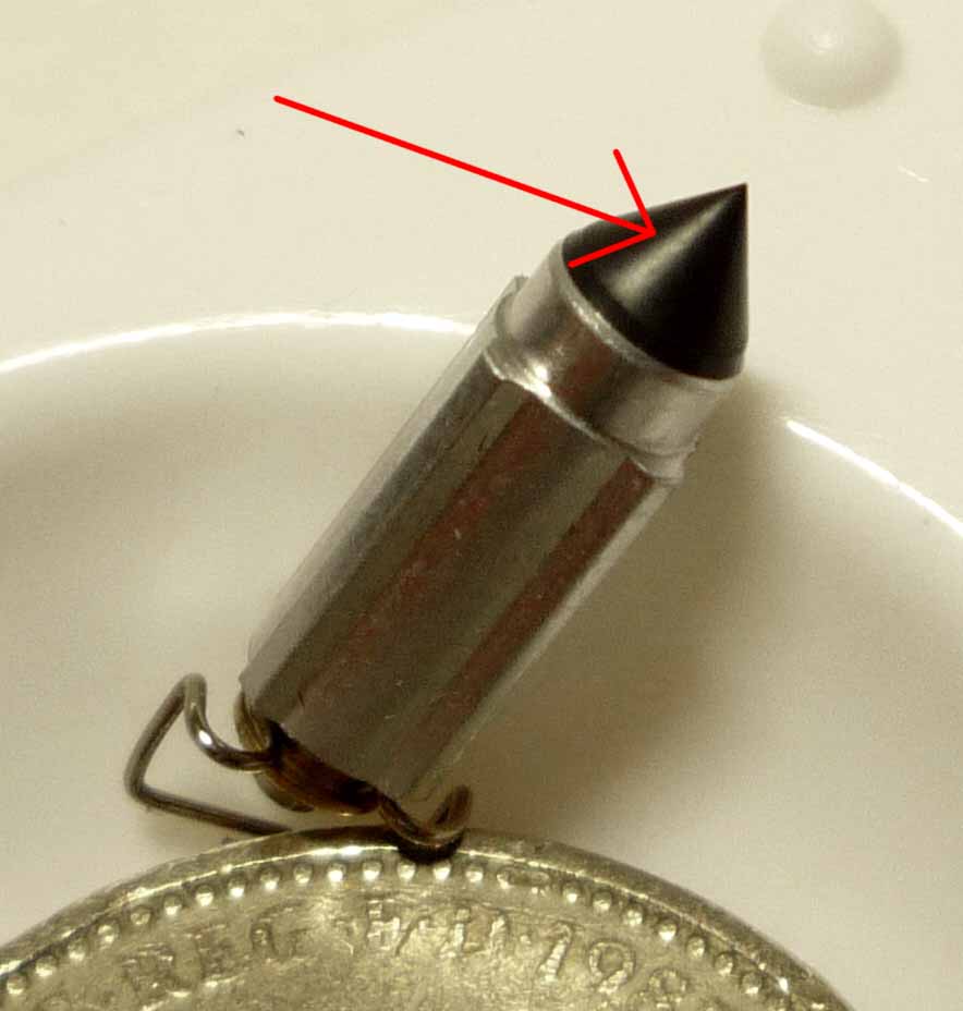

    2) Check the float needle seats? Dried petrol residue can stick to them, so although the needle is fine, it won't seal properly.
    See the attached.........These are of a new float assembly...........you can clearly see why mine keept overflowing.

    Also, on what seem like OK float assemblies, the needles wear the sides of the nylon needle recess which can either snag the needle itself, or allow the needle to slop about inside the recess......

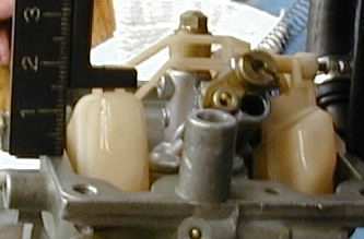

    I assume you have seen the attached image..........but it doesn't show how the reversed float bowl holds the float assembly still when you are measuring.......neither does it show the carbs tipped to stop the float needle spring from compressing..........
