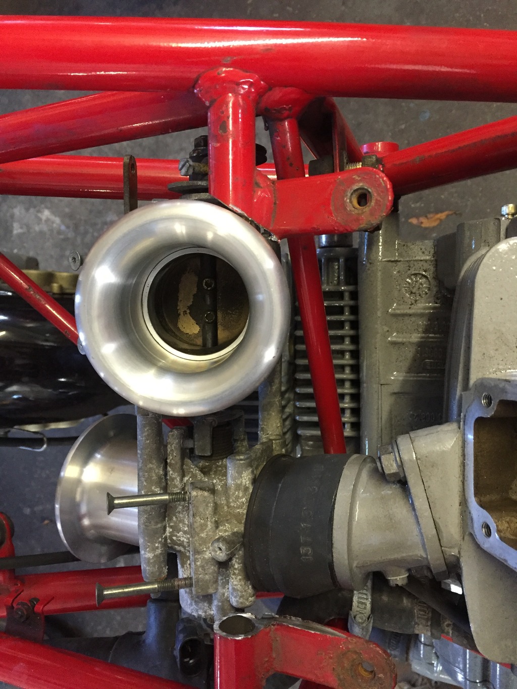

  1. Got a W2 headed engine in my old 96 900SS (from a monster, didn't know when I bought it) and wondering if a 2002 injected motor would fit in? Frame mounts, swinging arm, inlet manifolds and exhaust etc.
    Thanks.

  6. Thanks.
    I didn't say but I intend to run it with carbs, eventually FCRs.
    That's a good start if the engine will drop straight in and I can use my existing swinging arm.
    Ignition stuff could be different right enough.

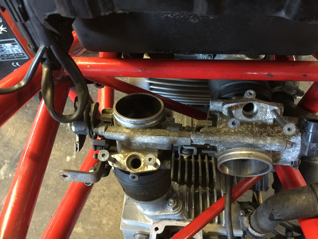

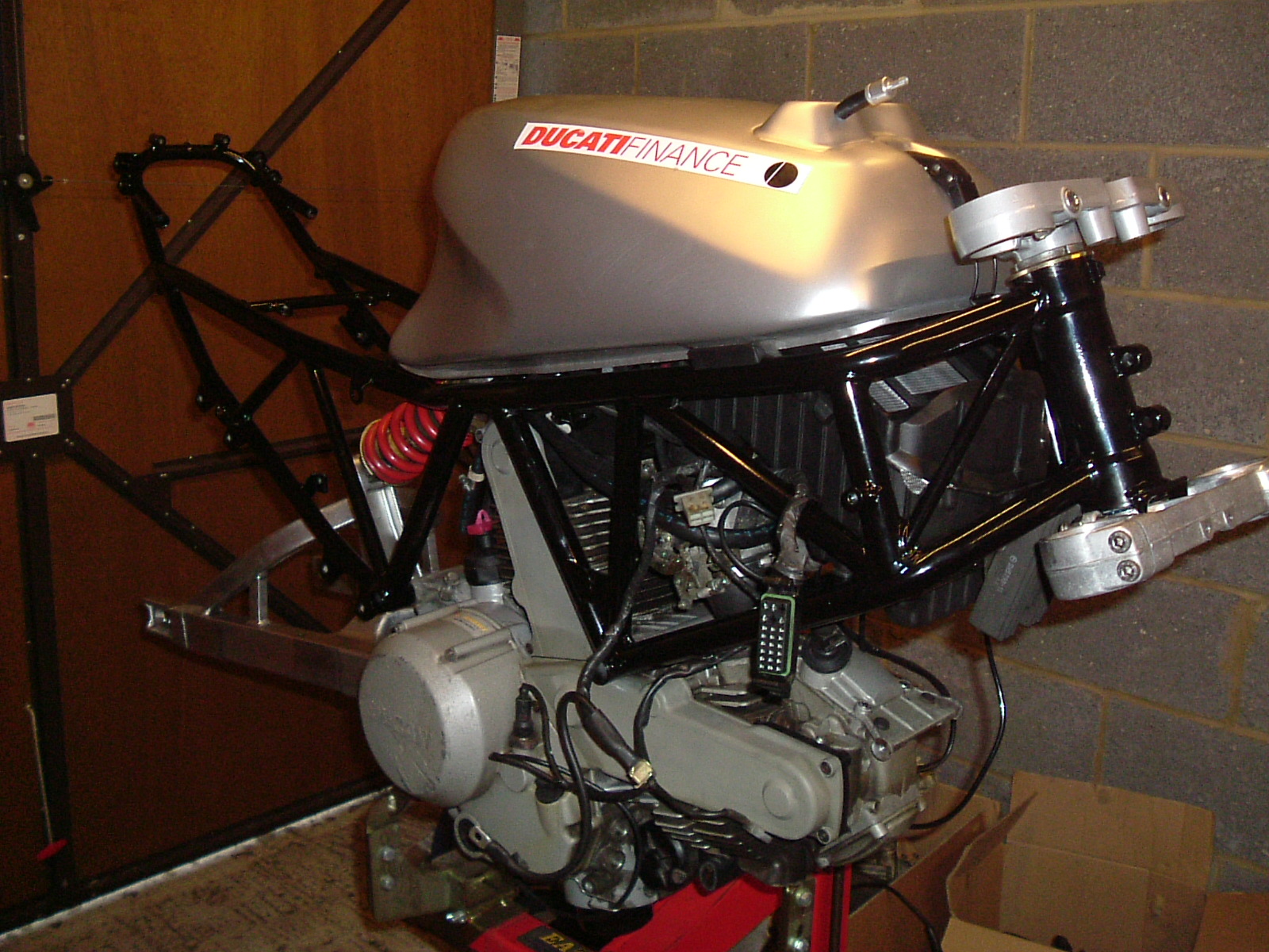

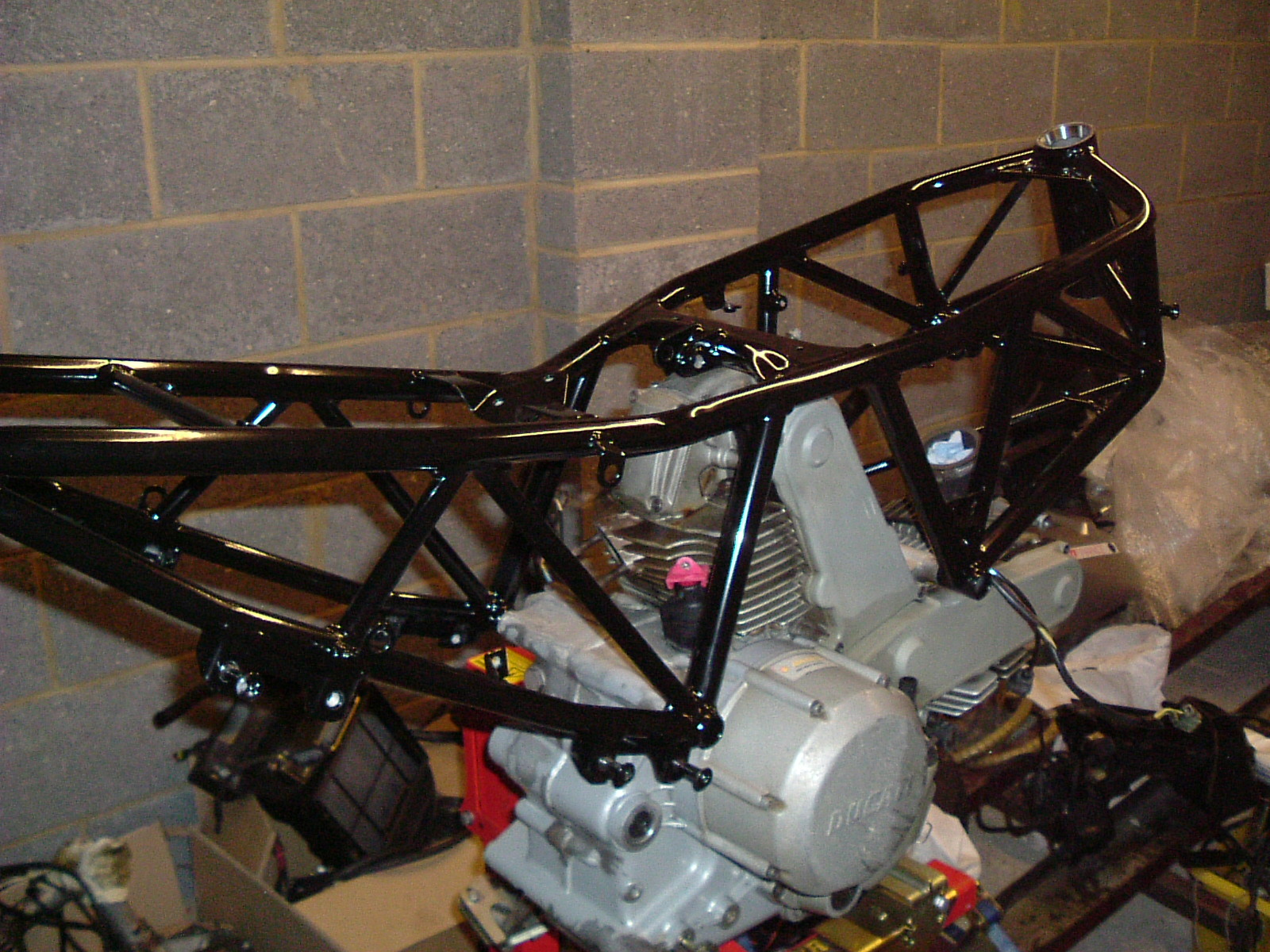

  9. Having fitted an injected engine to a Monster frame the only concern I had was the injectors were too high up and clashed with the frame:
    I had to cut the frame to allow the I take to fit:
    I then over braced the frame just so it looked good:
    Yorkie

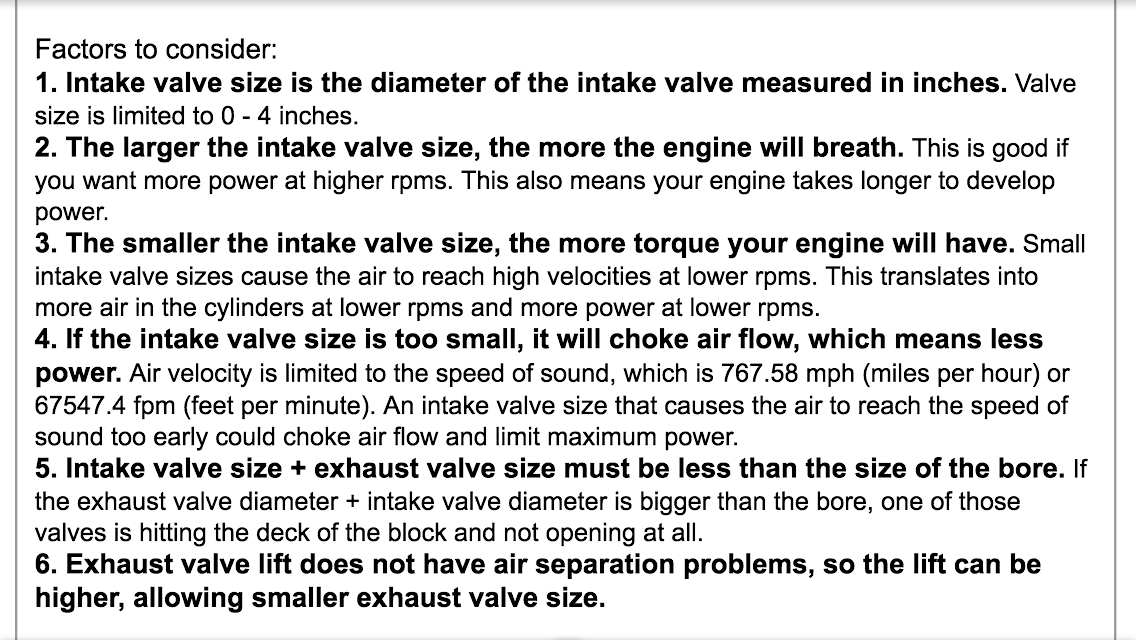

  11. as previous replies yes it will all fit, and the ie airbox is different but not difficult to fit, but if I may why use an ie lump then fit carbs, is there a problem with the monster lump?
    According to the build data history by Ian Falloon, from 1993 the 900 monster shared it's engine with 900ss till 1997 (from engine number 014364: Note larger cylinder head studs, & no tacho drive) when the monster was given smaller valves from engine number 037728.
  12. Thanks. I bought the SS knowing it had a Monster engine, but didn't know it had the small valve heads.
    Only engines around for sale are the SS ie ones just now.
    I must admit I don't find it lacking in power with the small valve engine.
  13. I think smaller valves give better torque.
