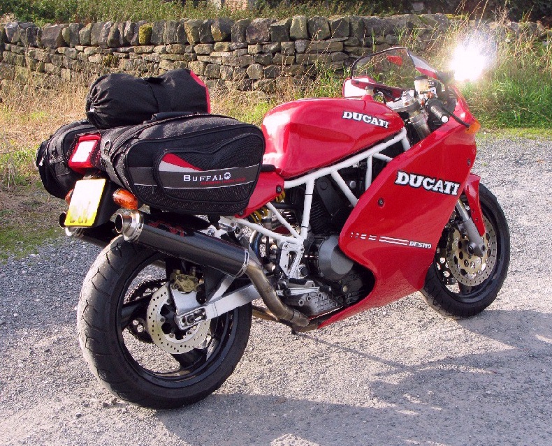

  11. I bought a set of high level carbon SMs for my 900 years ago, after mucho lusting. I was disappointed with the fit and regretted not sending them back for another set (forget where I got them from). The link pipes had noticably different shapes, and the brackets didn't line up with the frame mounting holes when the pipes were fully seated in the headers. I had to back them out a bit to line up the brackets, which at least went some way to sorting the first problem as it provided a bit of play to get the ends at the same height. But then they were wobbly so I used some exhaust putty, and now I can't get the left one off the feckin header. I hope quality control has improved since then.
    It's cold outside today, so here's a gratuitous pic of the pipes on me bike to warm all yer SS cockles...

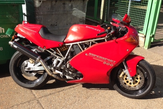

    the pipes probably aren't for sale still, since the seller changed his mind when I was looking. I ended up buying a set of 900ss specific high level Silmotos and have to say they are fab (but pricey), except for the mounting brackets. No amount of juggling and loosening could persuade it to work with the std brackets so I got some made up in the end. Currently looks like this, single seat next.. :)

    #14 Pylwagl, Nov 21, 2015

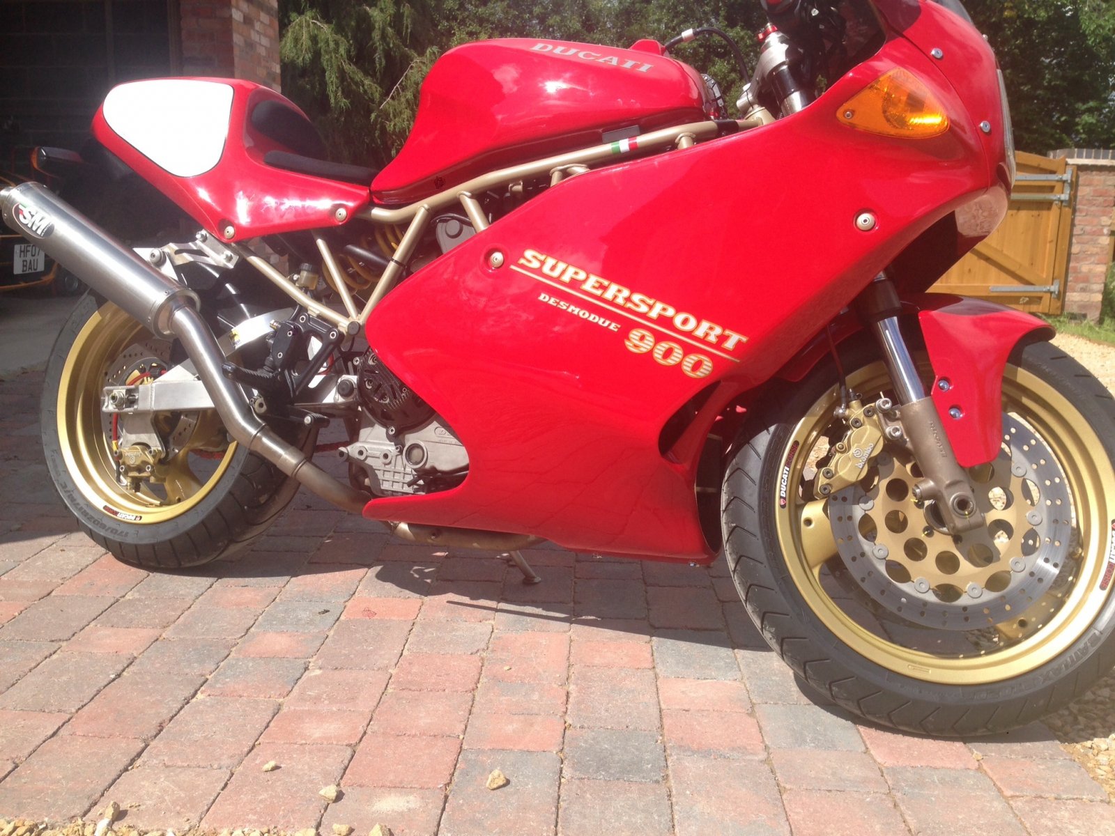

  14. I too bought some SM's brackets needed some modding but sound amazing with baffles out, mono seat just finishes it off. image.jpg
