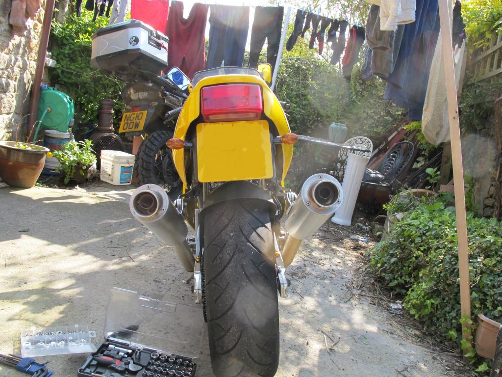

  8. There are also A11/b11 exhausts about aswell. There are from Germany market models I beleive and are more restrictive and quiet. So just to let you know. Some have made there way over to the UK. A04.jpg
    This photo shows one of each fitted and you can see the difference.
