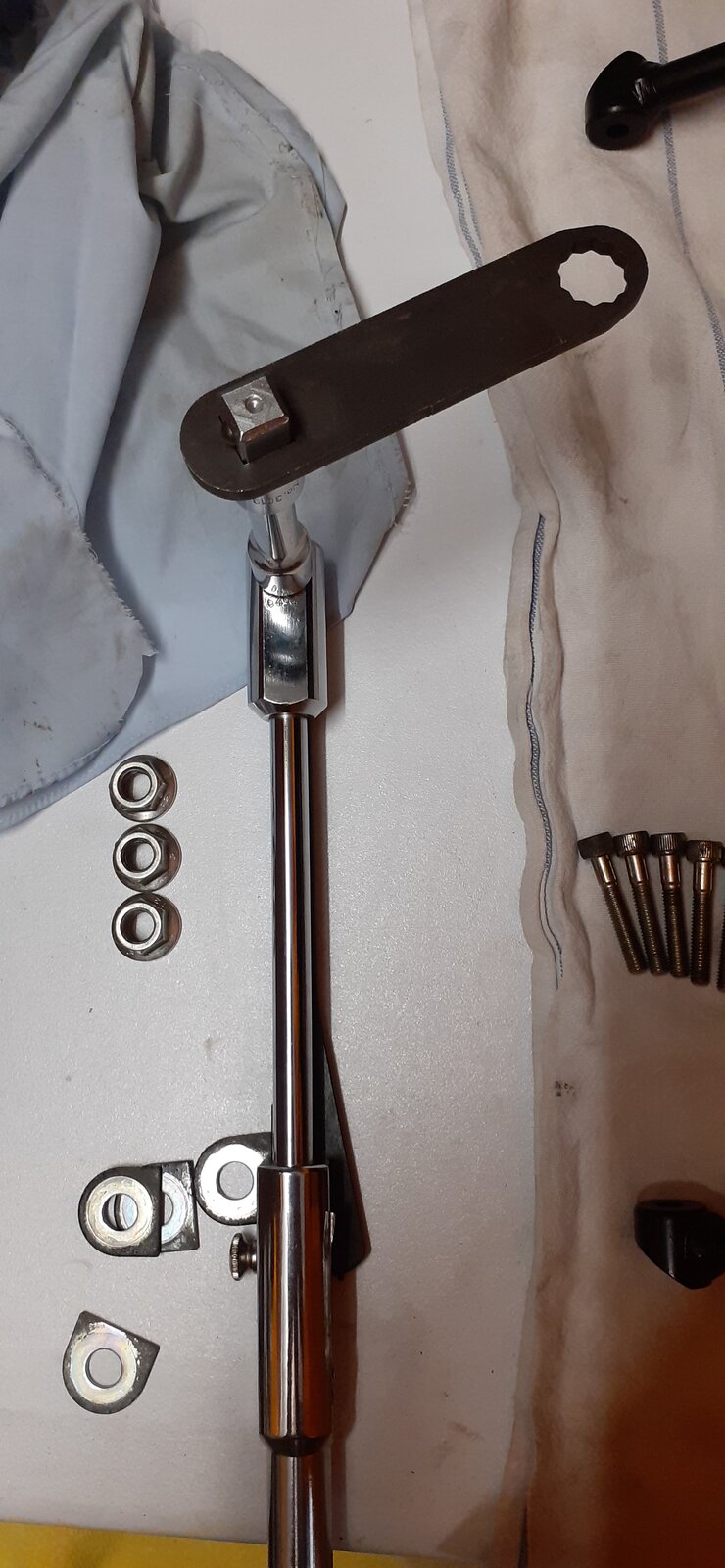

  9. First any comments welcome especially about 3 bond on cylinder/head joint.
    Second run into problem with torque tool. Using adaptor from 3/8 to 1/2 and small extension bar. Problem the square drives on adaptors are not lined up and can't get torque tool 90 degree to torque wrench which does not have a ratchet head.
    Cheers Gaz

  11. Hejira858,
    You seem to have quoted a post but can't see a reply.
    Anyway, I got some adaptor and extension from machine mart where both male and female drives were inline.
    I also could have recalculated a lesser torque value based on the increased length.

  16. Gaz,
    On my screen, looks like my answer is directly below your question ("click to expand"?).
    Anyway, only said no 3 bond on head joint - spigot on barrel should form gas-tight seal with rebate in head when nipped down.
    Also, got ratchet torque wrench if you need it - only up the road.

  18. Sorry your right should have expanded. I've done it - thanks for offer of torque wrench though.
    Cheers Gaz
